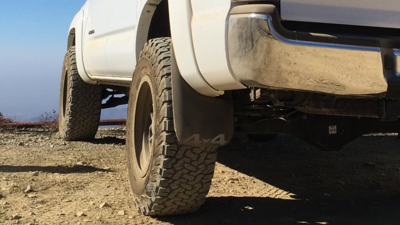

    Yea the ride is better I feel after the suspension lift. Glad you like it. Yes the front mud flaps need to come off although on the rears I took 2 inches off just under the 4x4. They have not hit any rocks yet.
    That may work for you if you want to keep them. your truck is looking good.mud flap.jpg
