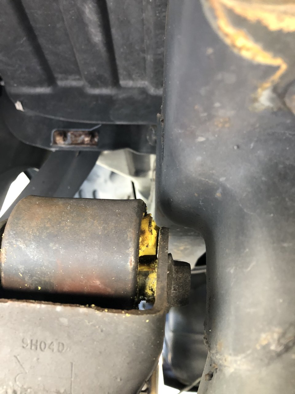

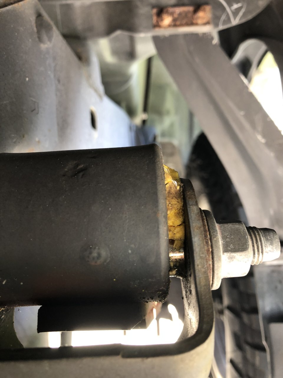

    Started getting a clunk from the rear so climbed under and both rear OME yellow bushings in the rear of each spring is trash. Installed 5 1/2 years ago. For each side the kit is $33 but install could be another $500. and they do both ends of the spring packs. Anyone else have the same problem with theirs? Did you use the yellow OME kit again or another?

    Bushing install shouldn't be $500. o_O Its a DIY task, but the most I could see a shop charging is one or two hours of labor.

    Change them out yourself they are super simple to re and re.

    muddog321 [OP] Well-Known Member
    Dec 22, 2009
    #27973
    1,136
    FL
    09 Tacoma DCSB 4wd TRD Off-Road w/e-locker Pyrite Mica
    TW 1-piece driveshaft with 1310 u-joints All Pro and Budbuilt skid plates OME Dakar rear springs 3" with 5100 5100 front set at 1.75" (3rd groove up) with stock springs Falken Wildpeak A/T3W 265/70R16 2018 TRD Offroad wheels 16x7J with +25mm offset Powerstop rotors with Z36 pads and rebuilt with OEM caliper kit Complete rebuilt rear brakes drums, shoes, springs, wheel cylinders Rebuilt rear diff with Yukon 3.73 ring/pinion Denso 130A rebuilt alternator AGM 24F Battery New OEM idlers and tensioner assembly New AC compressor New PS hose and flushed Walker SS Quiet Flow muffler Denso Iridium long life plugs #3421 (SK20HR11) OEM coolant, cap, and thermostat NAPA CV axles and new seals ECGS bushing Rhino front guard Shortened mud flaps Alziria Black Tail Lights Nilight Headlights X-Bull Traction Boards Maaco full single stage paint job 2023 Nat CV to Knuckle seals 710573 New SKF wheel bearings/hubs BR930978 New Moog stabilizer links K80946 & 948 New MOOG K80819 Suspension Stabilizer Bar Bushing 28mm New Dorman rear wheel bearings using complete axles 926-139 & 140 New Radiator support bushings Dorman 924-267 (front body mounts)
    elduder you were right and as you all said I made more calls to find out the real facts and cost.
    The older OME Dakars early 2015 (ARB CS047R) came with rubber bushings in the front of the leaf springs and then the yellow bushings (ARB OMESB108) were required (or others) for the rear bushings. I never greased them either as I was used to rubber that you left alone - that was a mistake as the pics show! So cheap fix now to replace and lesson learned. I'll spray them down with white lithium every 3 months or when I remember. Others may benefit from this post as its an additional location of a rear clunk.

    Where in FL are you? I bet you could find a local member that is (a) competent & (b) won't rip you off ... $500 :confused:

    Those yellow bushes are urethane (I think) and in any case they are not compatible with just any grease. Some (maybe most?) petroleum based greases might attack them and cause issues. White lithium should be ok but doesn't hurt to check their website. I think they recommend silicone based grease.
    Not saying that I think the wrong grease caused this, just an FYI for when they get replaced so the installer doesn't slap some bearing grease on them.

    OK so looked up the grease for poly bushings and best is as you said "Silicon with PTFE" or manufacturers type (my case ARB).
    Here's an article for others if interested:
    https://www.suspension.com/blog/the-best-grease-for-polyurethane-bushings/#formula5
    With new bushings when do I have to actually regrease them - years later or sooner?
    Do I have to unload suspension and loosen the rear bolt thru and try to cramp some into the center pin or pull it all apart to lube that center pin?
    Thanks for all the info.

    Service intervals will depend on things like mileage, conditions (lots if rain/water/mud?) and time. Poly bushings usually tell you when they are dry via some squeaking and other unpleasant noises. As far as lubrication application, unless you have shackle bolts with grease fittings, you will have to pull the bolts and apply lube manually. Even with the special bolts, it only gets grease to the inside of the sleeve and not between the sleeve and the bushing.
    Yes, unload the leaf pack before pulling any bolts out.

    I have had this issue with my own. Same feeling, rear end just had a bit of a clunk. Mostly when setting off. It's the leaf pack lifting.
    Mine failed in very interesting ways. They started to deform and almost "seep" out of the eyelets. And for most of you saying, "This is a simple replacement" hold onto your asses....because it might not be. My driver's side was simple. Unbolt, drop down, replace bushing, reassemble...done. However, the passenger side took nearly 8 hours. This is because the bushing failing allowed the support bolt to deform/bend slightly. That wouldn't be a huge issue except the bolt goes through a steel sleeve that's INSIDE the bushing. The problem with that is the sleeve locks in place and thus you can't slide the bushing out. So you're thinking "oh, just cut it off". Yes, now you have the bolt head and end off and it still won't fall off the hanger. To add insult to injury, the hanger totally is obstructed for getting much in there and the bushing sleeve itself is protected by the leaf pack eyelet. Best course of action is to use an air hammer to knock it out. Took me forever because I didn't have an air hammer. I bought one specifically for this purpose. Pictures included.

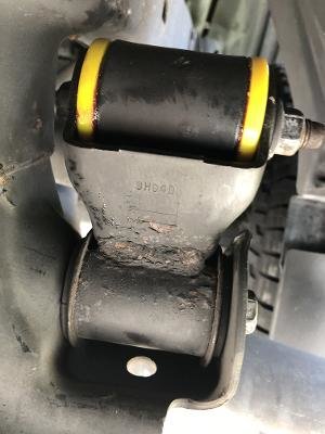

    After I got the rear changed (only 1 hr labor) all smooth again and the lower and front bushings are stock Toyota rubber and good so left alone.

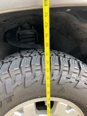

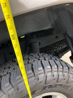

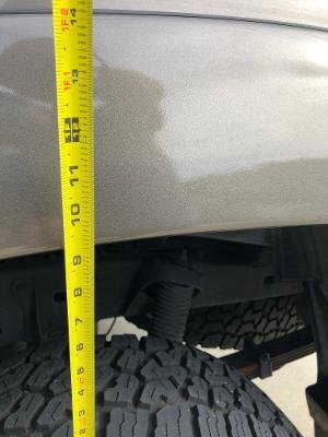

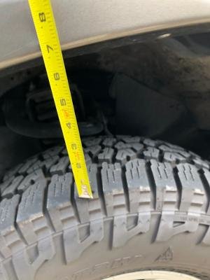

    Took some measurements and pics of the height and clearences for anyone interested with stock tire size 265/70R16s and Falkens.
    Front with stock springs on 5100s set at top or 2.5 lift after being on for 5 years and overall is 35 1/2" and tire to body 6 1/2" running full steel skids and Rhino bar.
    Rear with Dakar heavy springs after 5 years is 37 3/4' and tire to body 9 1/4" no payload only a shell. Levels out towing or with a bed full of stuff.

    Good to hear. What did the old bushings look like when they came out?

    Crushed and ripped apart - sorry no pics taken of them before trashing. Towing a boat and launching in ocean then washing off each time flushed out all the grease I guess so they bound up and self destructed. Now I know - the stock ones are fine as no lube required on them.

    Doesn't seem anyone else has mentioned it, but good chance your hangers are bent...
    Just by looking at the photos, it would appear they are, which will cause premature failure of your bushings...
    Have a look from the rear, you'll likely notice they are cambered...
    Id get them sorted and straight before replacing the bushings
