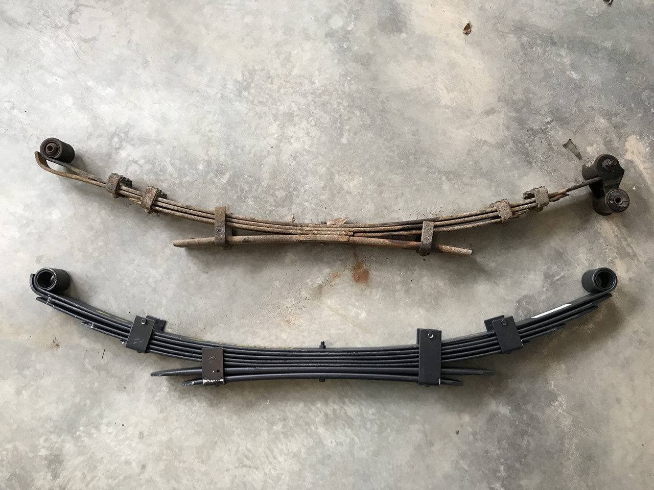

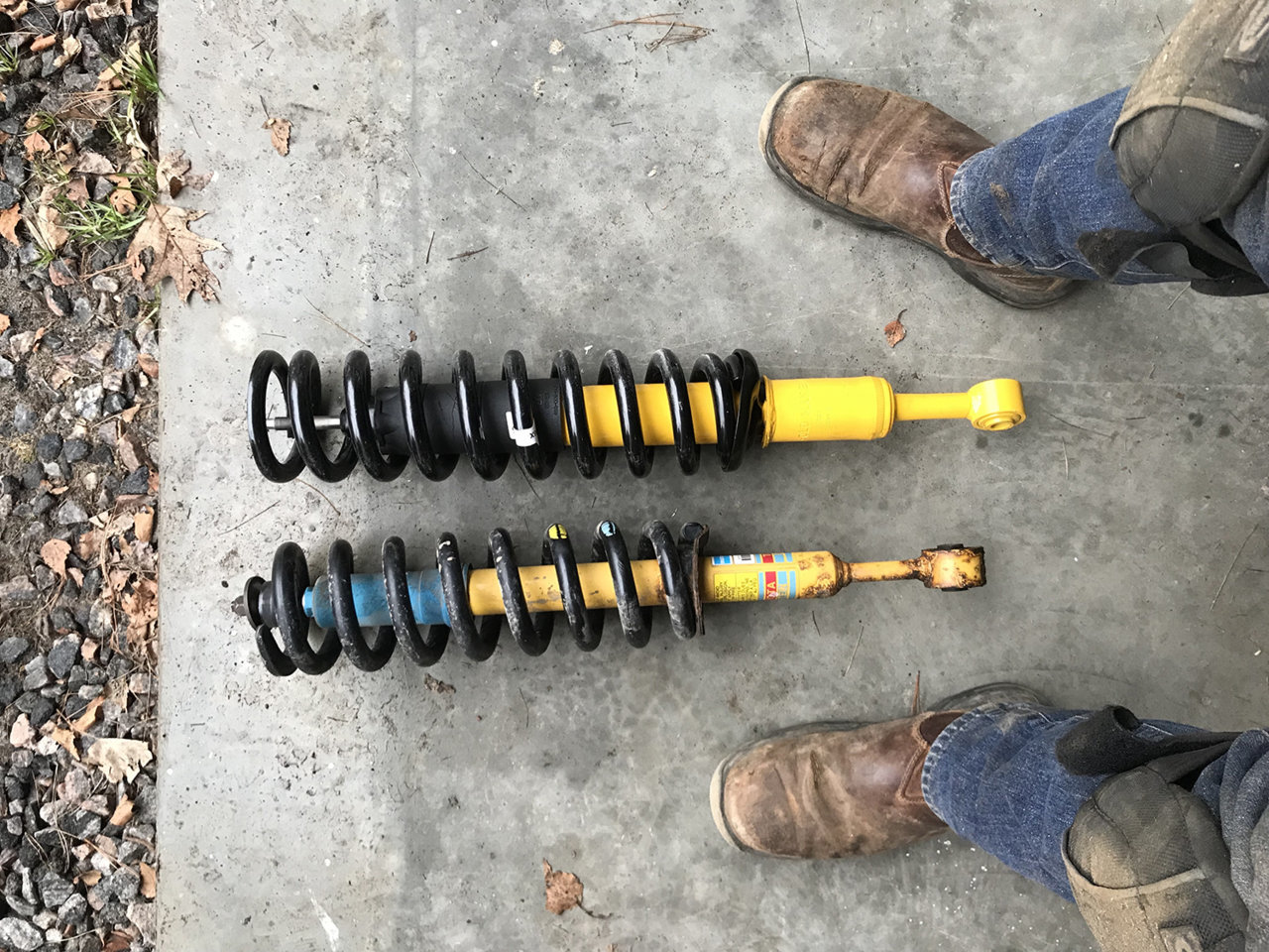

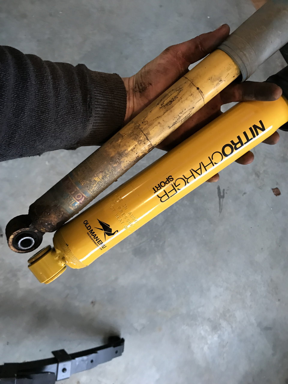

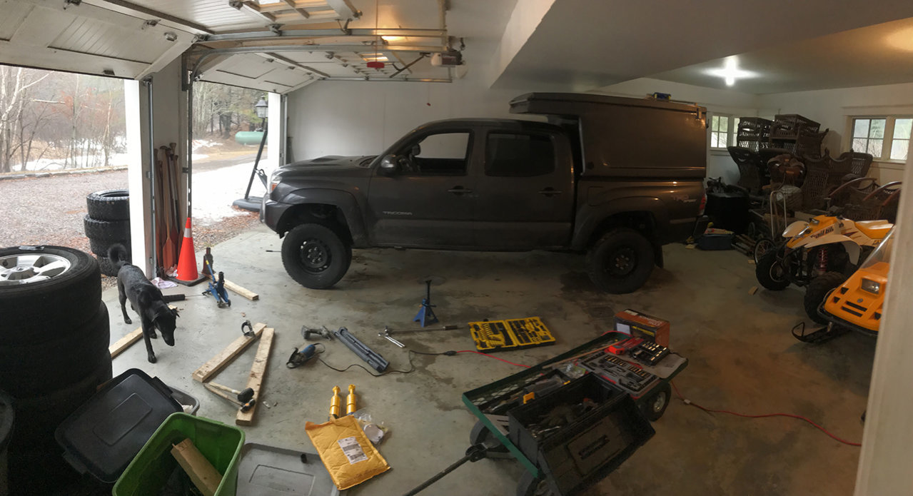

    The bushings arrived a day early! This meant I could leave the city and get back up to my garage.
    Install was super easy. The bushing came with some grease. I didn't bother to change the shackle bushings.
    Dakar HD EL096R in the rear with OME Nitro Chargers 60091; OME 2886 Coils and OME Nitro Chargers 90021 up front.
    This gave me about 3"-3.5" of lift in the front and rear (flippac on truck bed). Ride seems stiff. Have driveline vibrations. Adding driveline drop kit later today, but I don't know if this will fix the issue. My previous truck with Bilstein 5100's and add-a-leaf on new stock springs gave the same lift, but no vibrations issues -- probably because I had angled shims under the leaf springs.

    Glad to hear it! Also, if you do ever decide you do want polyurethane bushings in your shackles you can order new shackles with no bushings installed for relatively cheap, about $35 CAD. Was just talking about this in another thread as well. It can save you the hassle of pressing or burning out the old bushings so that it becomes a quick swap instead. pn: 04005-65104
    https://www.tacomaworld.com/threads...a-archive-garage.519625/page-34#post-19089115
    As for the driveline vibes, different strokes for different folks, lots of solutions that vary in efficacy depending on the ride, just gotta see what works for you. The Dakars ride stiff, especially the 96s, but after a while with some weight on them they might soften up a bit but I doubt it. Can always remove a leaf and see how it sits and rides.
    my garage floor usually looks the same, nothing that can't be installed/fixed without a few 2x4s and some BFH :thumbsup:
