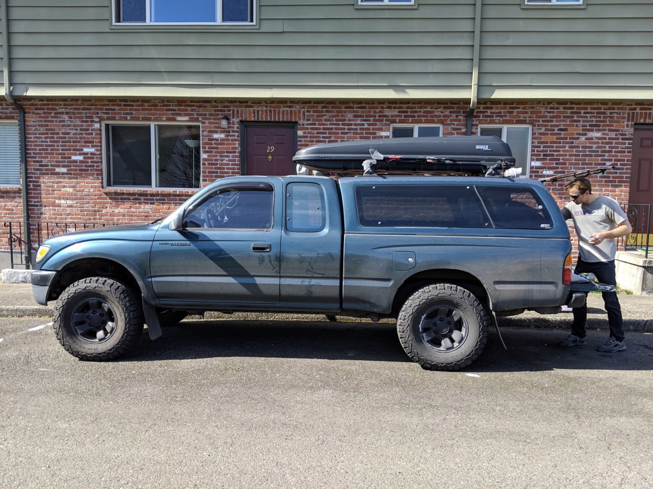

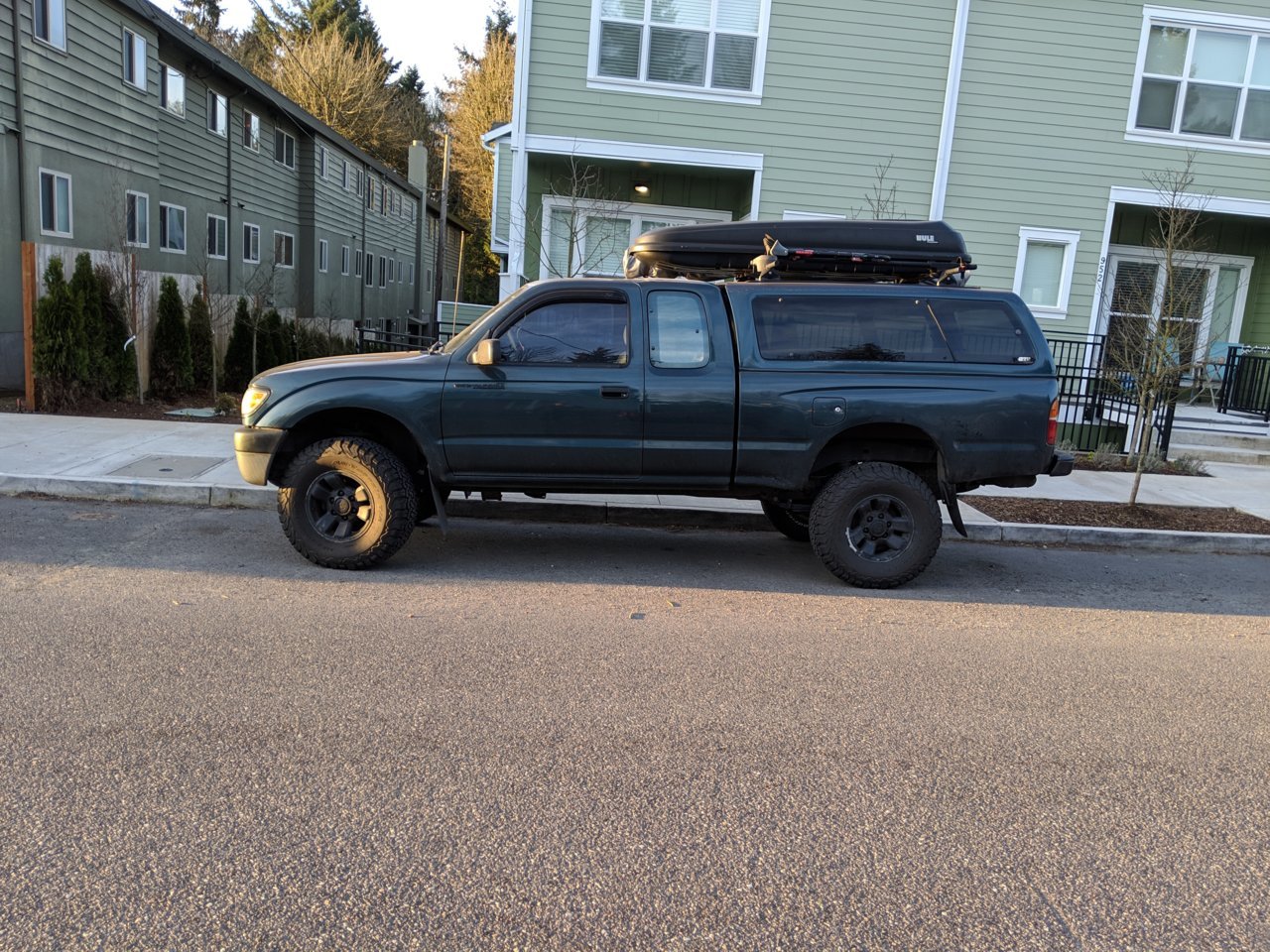

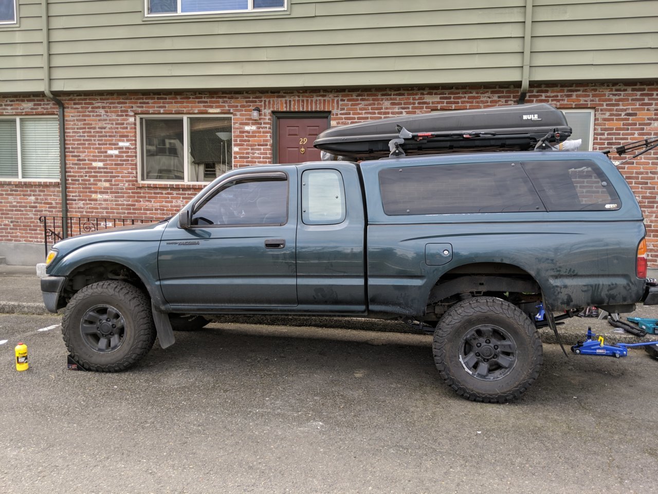

    I had a ton of rake when I first installed and it's been gradually settling over the last two months without any added weight in the bed (sparing the canopy). Still hope it settles a bit more. Order of pics is before, immediately after, 1 month after.

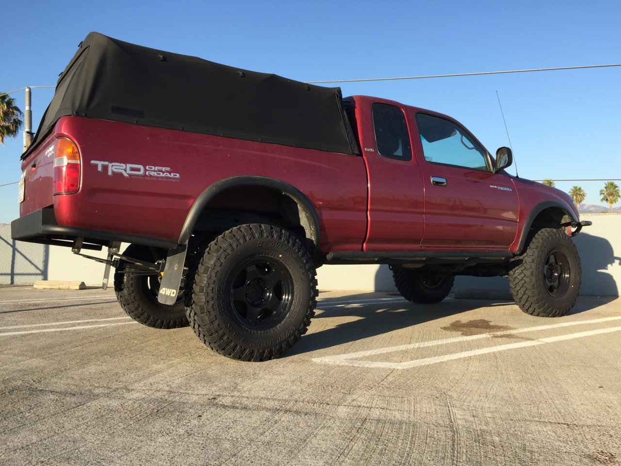

    I messed around putting some weight for a quick second - I think the universal shocks are what's keeping the truck afloat.
    My Fox rear's aren't made for my Tacoma.
    I'll call Fox and confirm the damping between those that I have and those that are a direct replacement for the Tacoma.
    I went universal for an added 1" of travel if anyone's wondering.

    This is exactly what I had been thinking when I first saw your post yesterday. I'm nearly positive its your rear shocks.
    One thing I've learned about OME, when the kit is first installed on the vehicle - ppl are obsessed over how much lift was gained. First thing so many seem to forget about is just how bad their original suspension was. For some they'll see xx difference in overall height/lift gain while others will see a much larger difference because their leafs and shocks were way past the crap line. It just varies - so much.
    For your situation though, I bet its the shocks.
