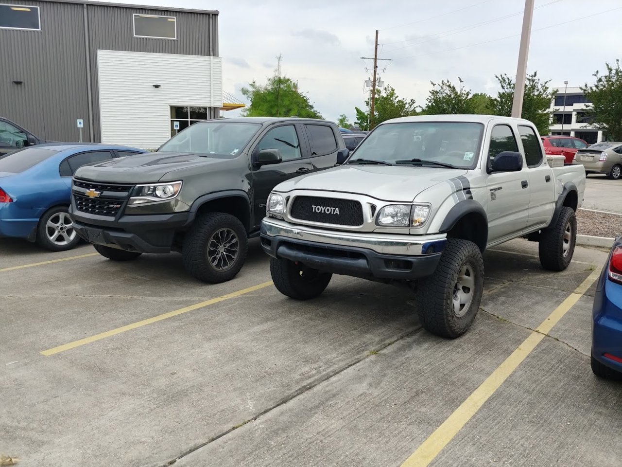

    this was mine with 882s and dakars

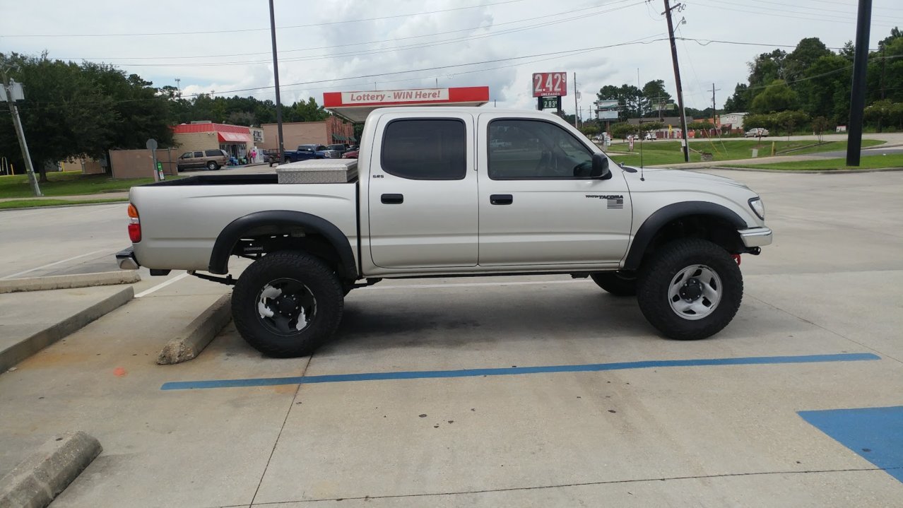

    and this is it almost a year after
    fsY0euwwmk42DnJ0jxjFZJLa0X8qOxdcd-sZfwid_1e347dbcd236671dd45f8cb2c2c94e4b6a630792.jpg

    How much weight in the tool box?

    981
    Louisiana
    01 V6 4wd PreRunner DCSB OME lift
    not sure how much the toolbox weighs but 50lbs at most probably more like 20lbs worth if stuff

    23 TRD Pro 6MT / past 04 DCSB 4WD
    Could be the double cab and that bit of weight that levels it out. I am going to be installing my Dakar leaf pack on my DCSB soon, hoping to have a similar result.

    Louisiana
    im also 2wd with no bumper on 882s, the front was about an inch higher for a bit, its leveled out but the front is still very stiff

    Interesting.
    I'd like to see a current side view similar to the first picture right after installation.
    I have a tube bumper in the back which I assume would weigh a good bit more than the stock bumper did.
    My front has a conservative 2" lift up front so I know I'll always have some sort of rake.
    Ill get a picture from the side later today
