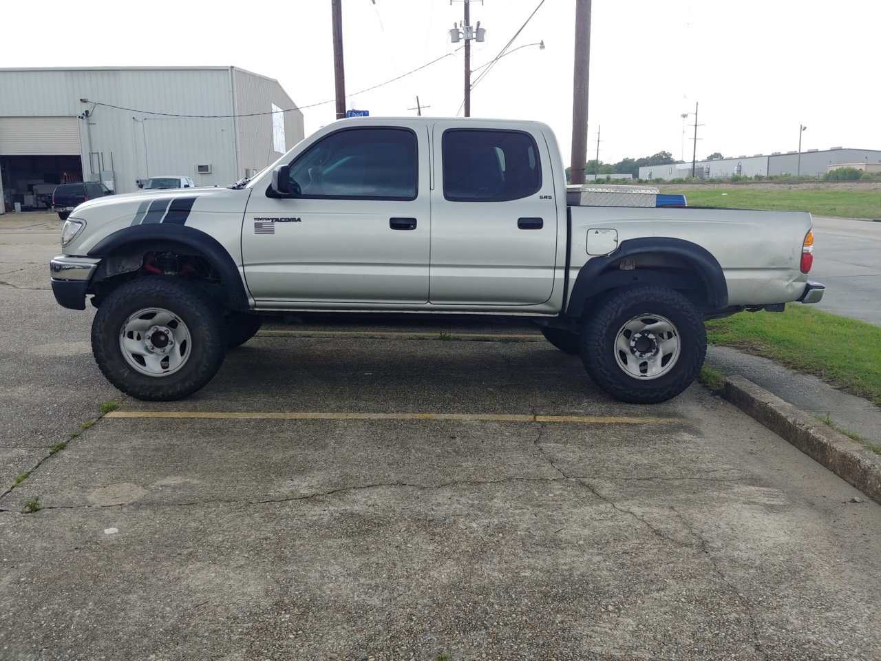

    #43
    DashMaple
    DashMaple Well-Known Member
    Feb 11, 2018
    #244129
    981
    Louisiana
    01 V6 4wd PreRunner DCSB OME lift

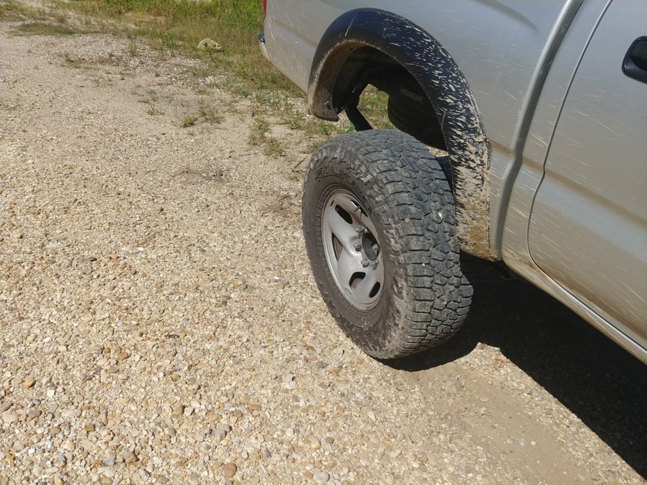

    Looks like yours dropped a good half inch!

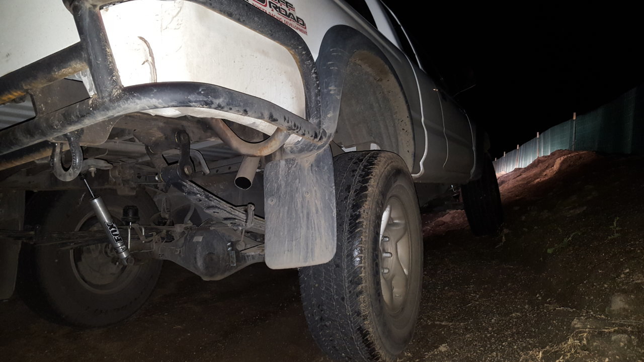

    Went out and did some flexing after work -

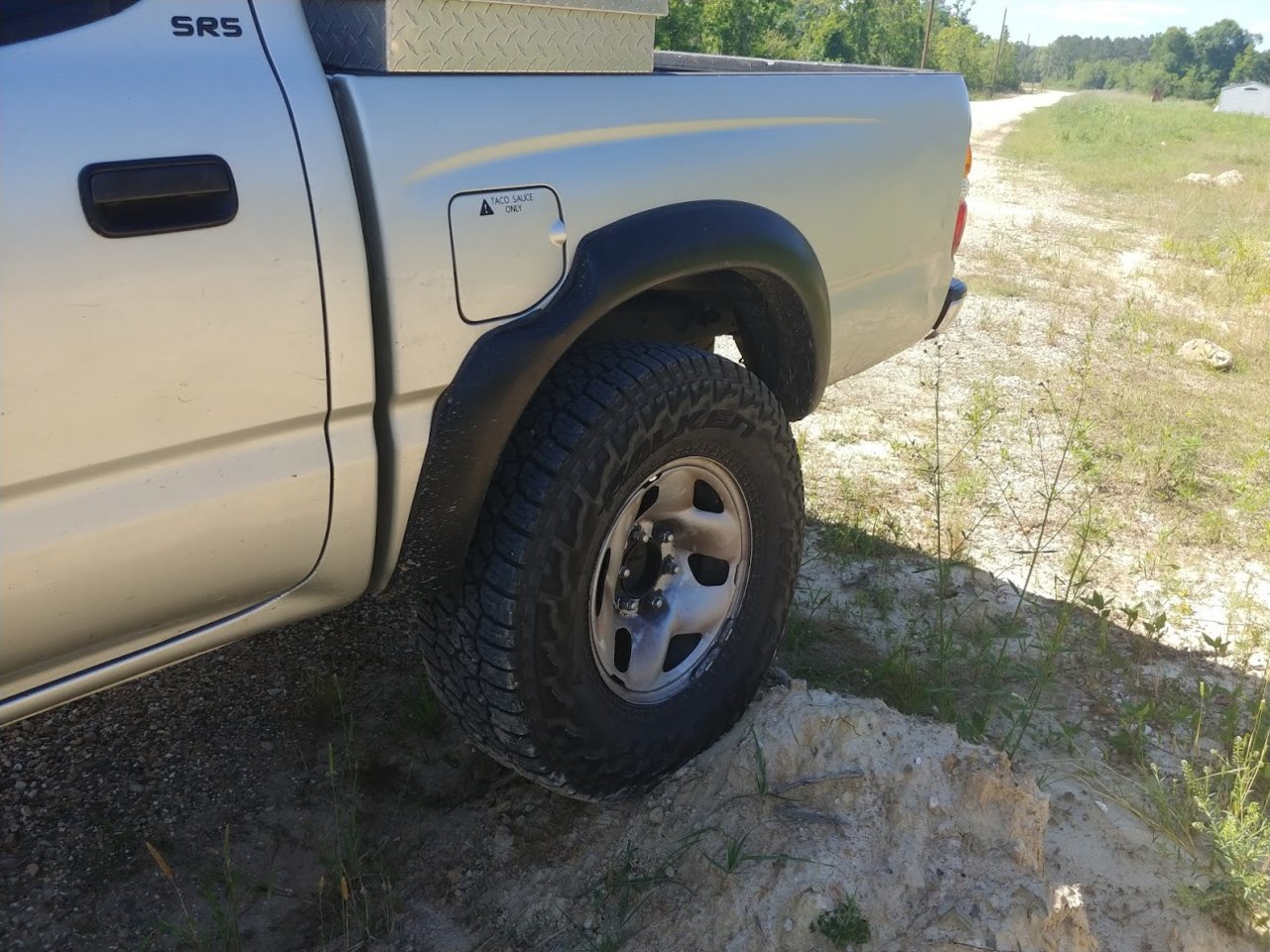

    Yeah the rear dropped a decent amount, the front still sits super high lol
    I see you figured out the dakars like to flex as well lol

    I was surprised at how much they flexed!
    Really I could've gone even more before the tire lifted up, but I saw how close I was getting to the bump stop. Seeing how much travel I have left told me I need to get spacers for them...

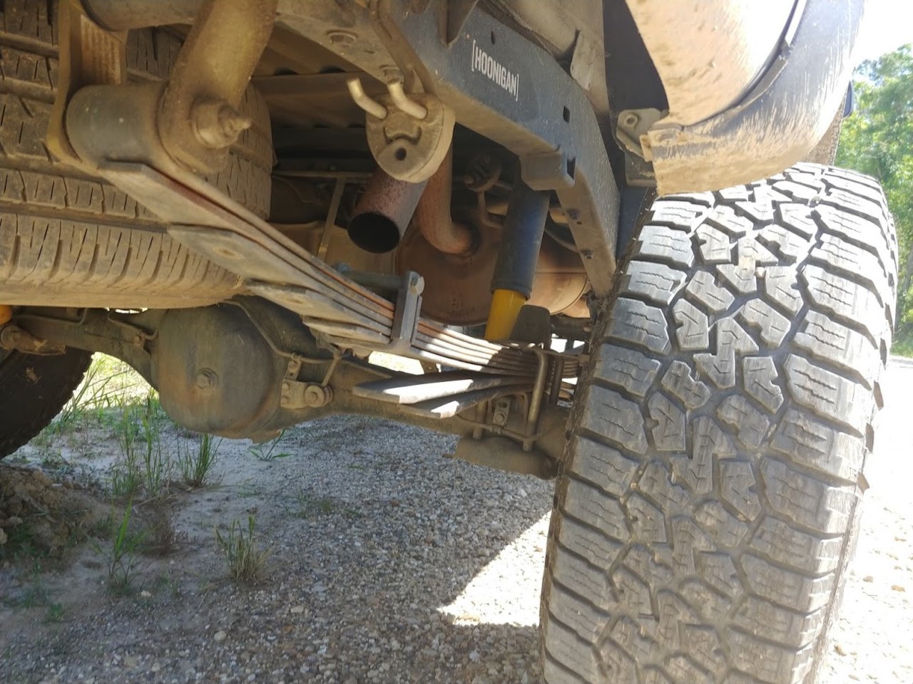

    981
    Louisiana
    FDU_SEy0y9mAc_Y82BSYGzbHDhXZNw2o7GLUncD7_b67afc61d634726cac57a01655d559ffd0e756e9.jpg
    b_42wERwKAU3FOXC1ioAV6j8IU8sq0AXnNcMMFJR_be74ac1c98a09ab6c51f31fb07bc54be63bc7511.jpg
    I forgot to get a picture of the leaf spring on the driver side but i think i was about an inch from the bump

    Cut exhaust for the fucking win :fistbump:
    Why didn't you extend your bump stops if you don't mind me asking? I'm not familiar with the OME Nitrochargers (if that's what you have) but I'd be afraid of bottoming out the shocks.

    Combination of broke and lazy, I have an extended rear brake line sitting in my garage i have yet to put on lol
