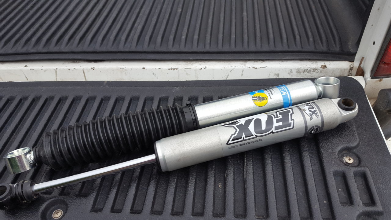

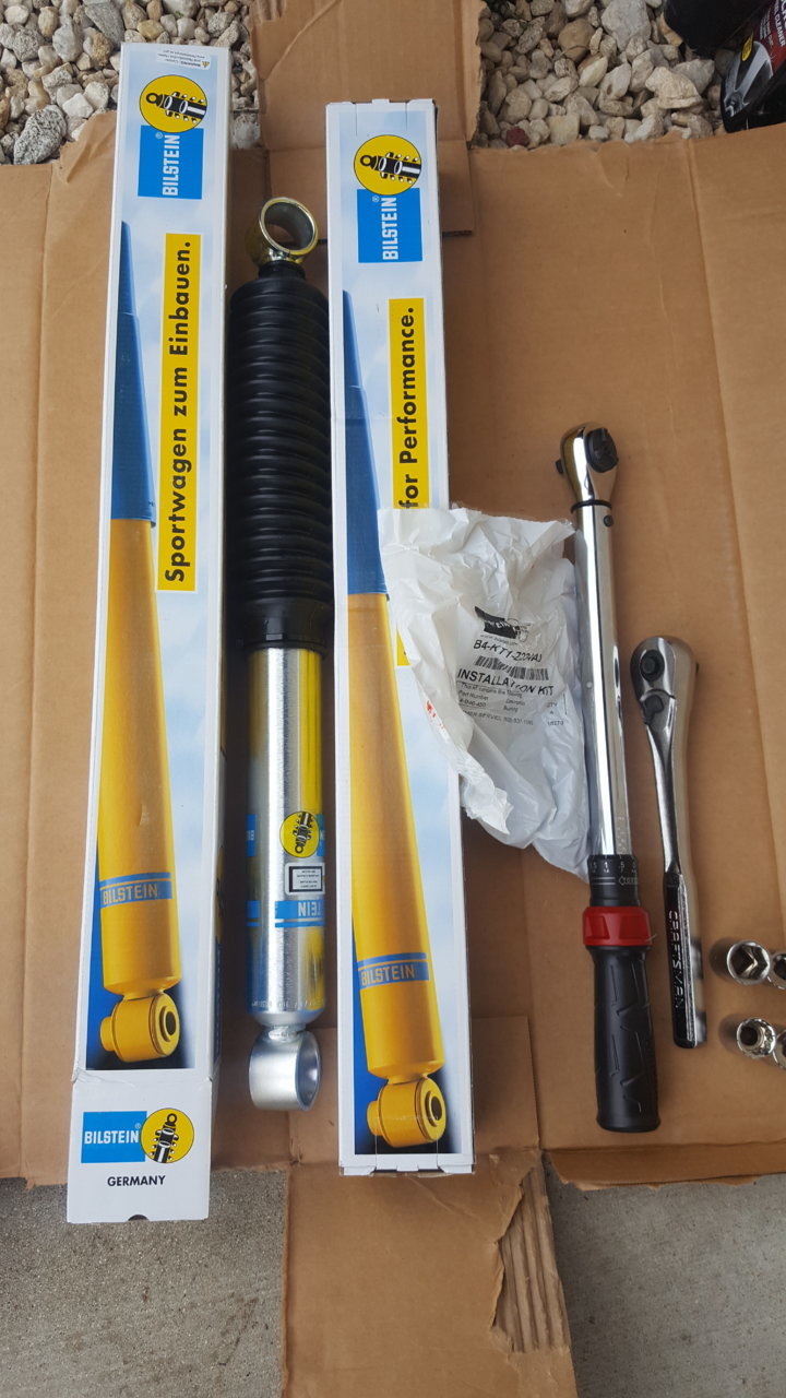

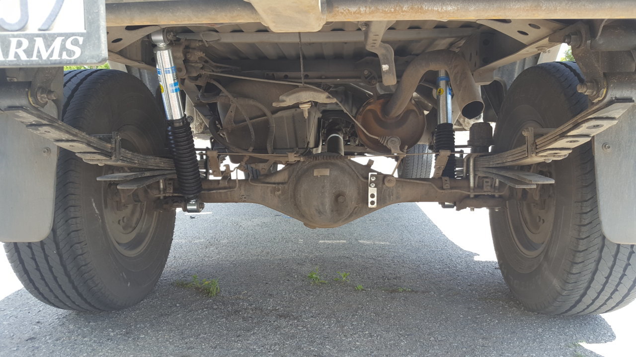

    Update; as I have suspected, the overly stiff ride was indeed attributed to the Fox shocks I had installed.
    For those that were following, you knew I had suspected my shocks valving to be meant for a full size pick up.
    For those just joining, 2 weeks ago I had just installed OME Dakar rear leafs, Fox 2.5 front CO's, and Fox 2.0 rear smooth bodies. The smooth bodies were not the OE-replacement but instead their universal variant with an additional inch of travel.
    My Bilstein 5100's arrived today, so off to work I went.
    One thing I noticed immediately was the fact that I was able to compress the Billy's by hand. I remember not being able to do that with my Fox shocks; for those I had to put them on the ground and use my body to compress them. This proved equally difficult when I installed the shocks on my truck seeing as how I had to fully extend one end to get the shock to fit.
    The Billy's went on without even having to lift the truck.
    An on and off road test also gave my different results. When going over speed bumps, the rear end jumped right back up similar to a rubber band that's been stretched and let go. The Fox shocks couldn't even behave in a similar manner and instead made the rear end jump up as if I had no suspension.
    Continuing on road, there difference was more noticeable. Potholes were already soaked up pretty well by the front end, but the rear end no longer had that "shock" when the rear wheels met the same pot hole.
    I live in the middle of nowhere and we have plenty of small "washboards" so I took it off road. Going over the washboards at 30mph caused a ton of cabin noise, but left me feeling like I was driving over a paved dirt road. Everything was soaked up and I almost wanted to go faster but didn't due to having road tires. It's only when I slowed down that I could feel the bumps.
    All in all I'm stoked at the difference the Billy's made. What's funny is, now I need to find the "right" replacement rear shocks as the Bilsteins were only bought to test my theory. I don't plan on keeping them as I always intended to own something better than OME Nitrochargers and Bilstein 5100's. I just don't want to go fully custom because I do not rock crawl and this is a 5th vehicle.
    The Bilstein's when they arrived.
    The Bilstein's next to my Fox 2.0's; sad thing is the Fox shocks have almost 200 miles on them and they've already been replaced. The Bilsteins look shorter than the Fox shocks but they really aren't; at least not the longer of the 2 Bilsteins.
    The Bilstein's installed.
    And the initial picture with the Fox rears.
