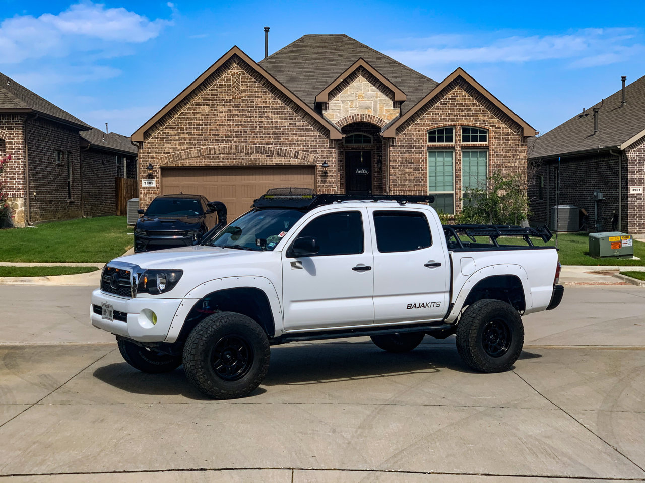

    Not a 3rd gen but here’s my HD dakars. These are the newest version and they ride great. Only weight is my bed rack and I’ll be adding a tent whenever it comes in. Zero squeaks and they flex pretty good.
    with 285/75r16’s and 1.75” trimmed off my flares they measure right at 10.5” from the top of the tire to the fender.
