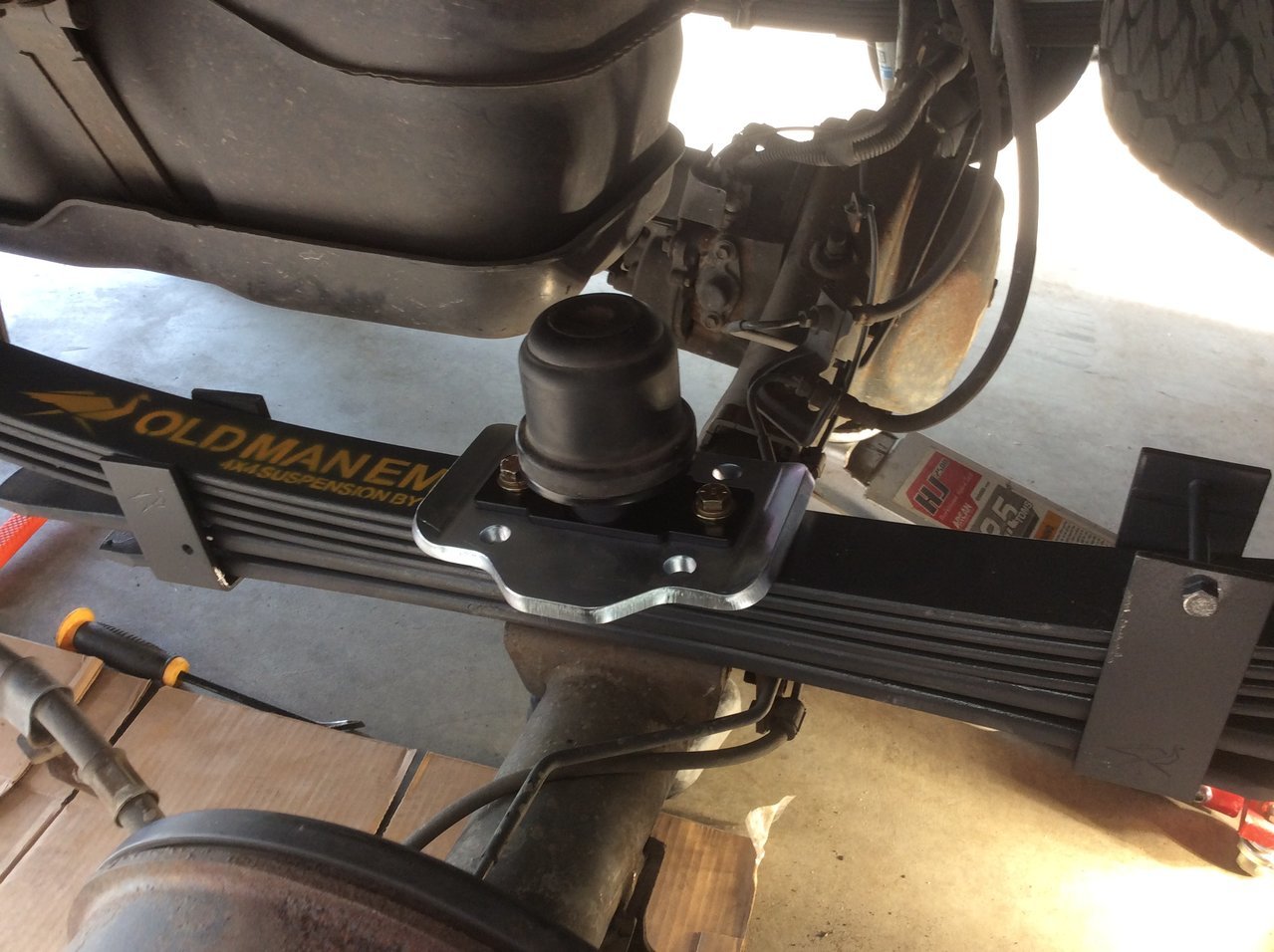

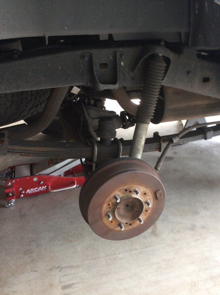

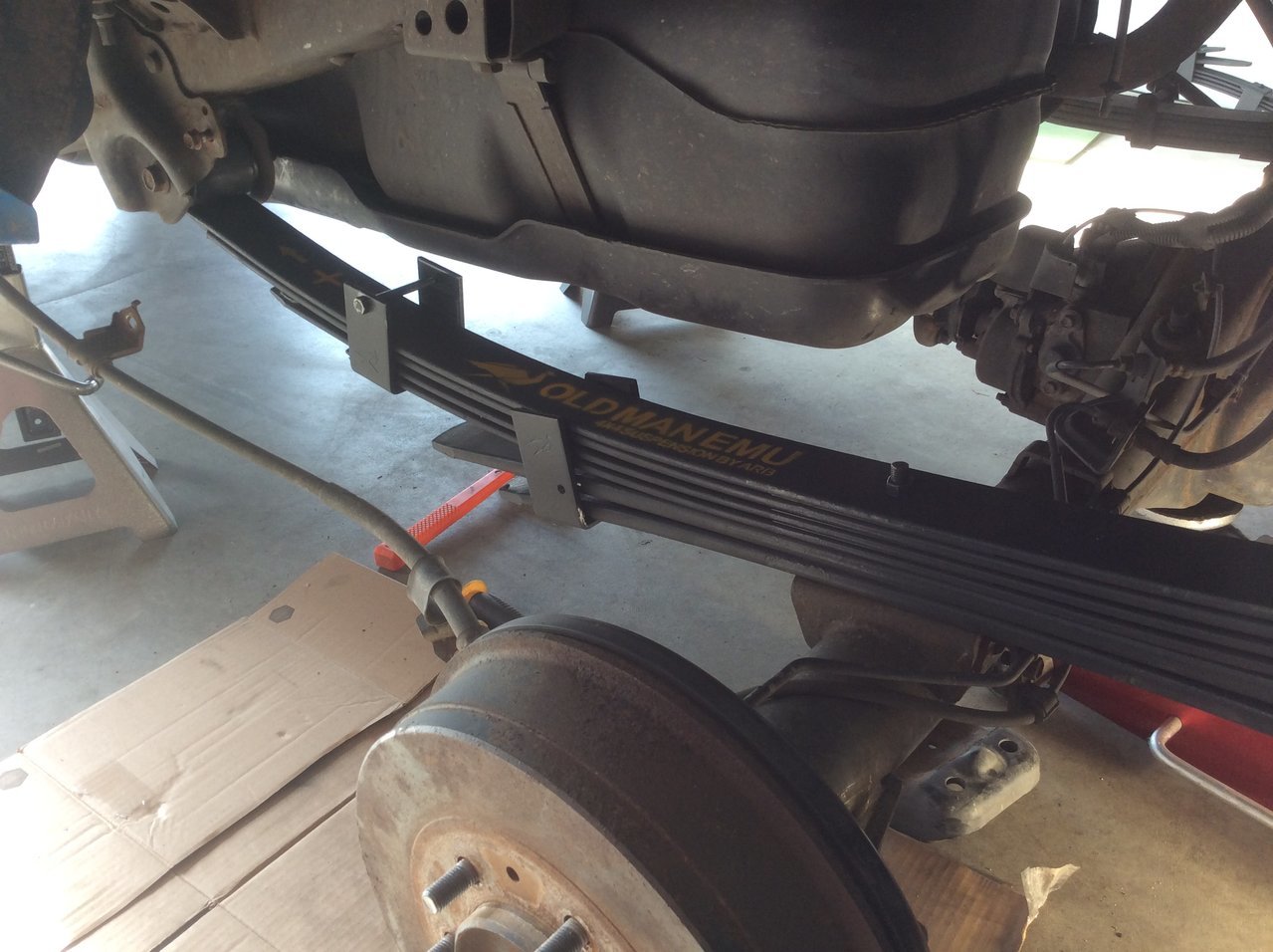

    So It was finally time to ditch the Toyota leaf pack, after spending hours of looking at different packs I came to the conclusion to go with Dakars. I drive around with little to no extra weight at this point so I decided to go with the Medium Duty EL095R pack. With that I was time for longer shocks so 5125s. Since I was taking the rear apart I figured it was time for a flip kit as well.
    As far as the front goes I am still rolling with the 5100 and the 1/6 Eibach coils with taco lean spacer. I may go with a 1/2 inch driver 1/4 spacer down the road to get another .5 inch lift in the front, but i like some rake.
    Prior to the dakars my rear lift was TSB toyota springs with the wheeler's 3 leaf ALL with super bumps. The ride was good but it sags when i towed the boat, good thing for the super bumps.
    So install day came and I convinced my wife to take some photos, I haven't figured out what that is going to cost me yet but oh well. The new Dakar packs don't come with front bushing so make sure you order enough.
    Was able to remove the supper bump from the old mount and move them to the new flipkit setup from wheeler's.

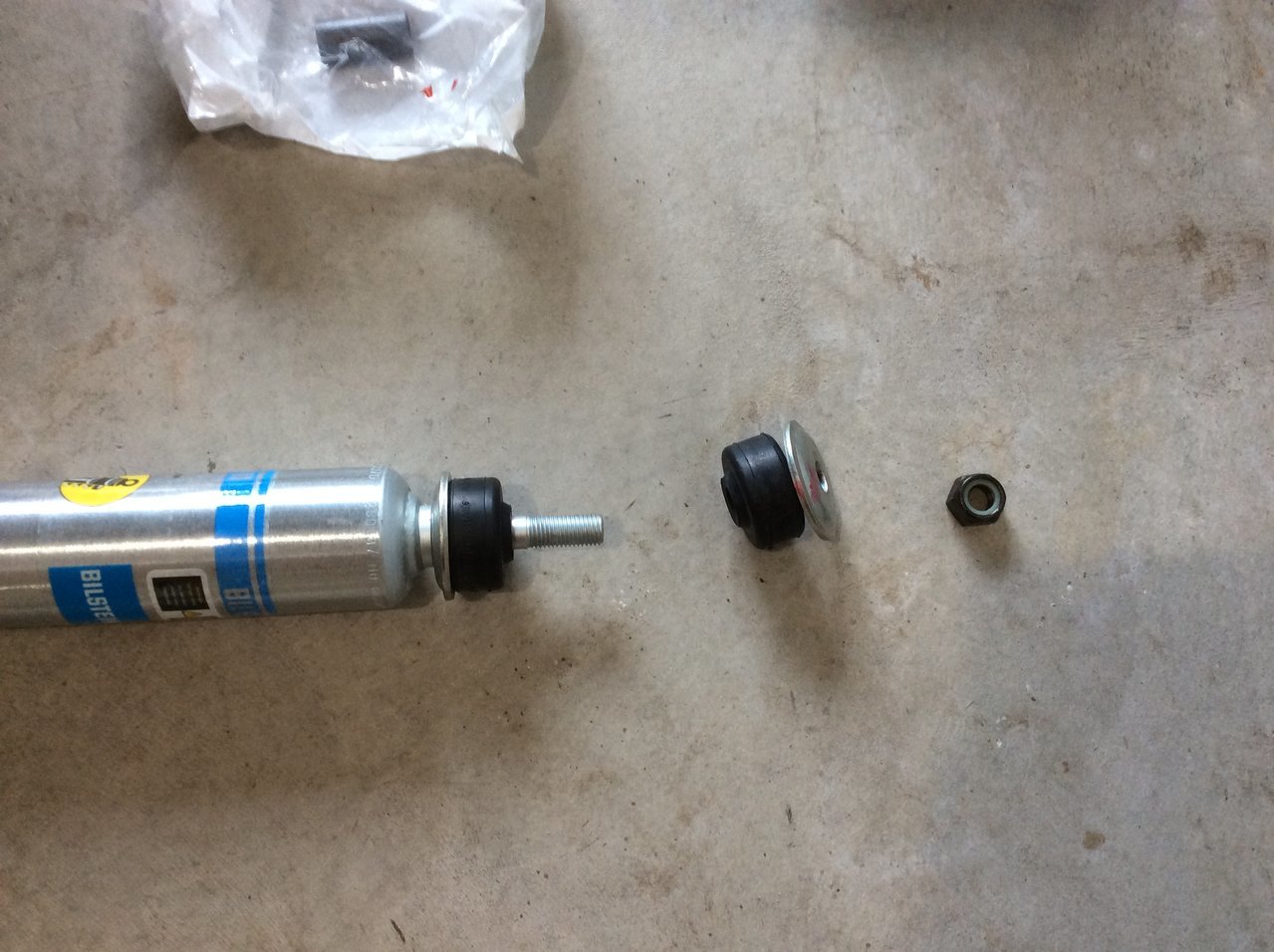

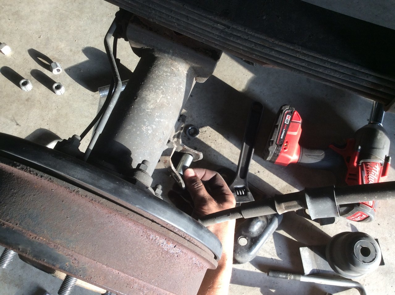

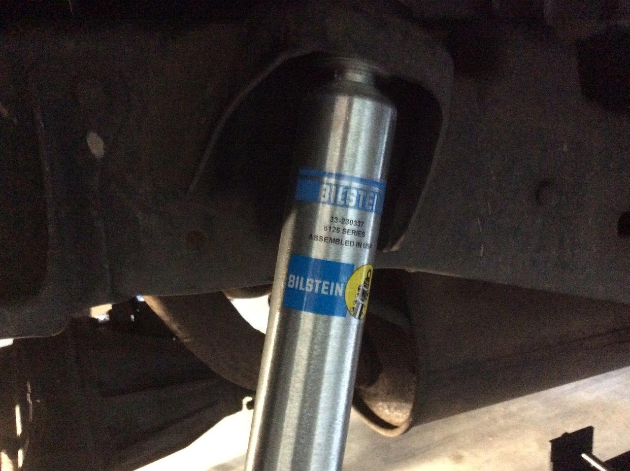

    Spring install was easy now came the time to get the new shocks mounted up, top nut was easy since I could hold the shock body while I tighten the nut.

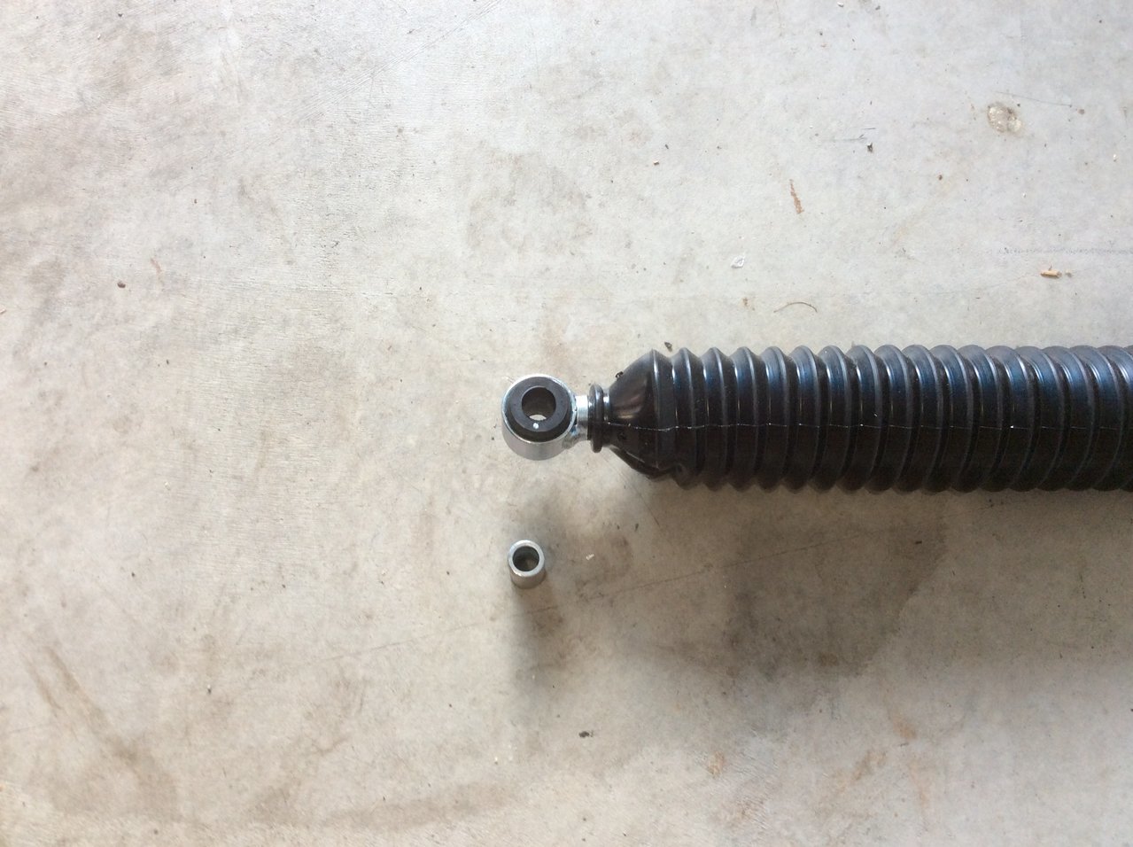

    Than came the lower mount even after bending the lower mount it was still not going in, so a little grind action on the bushing and it slipped right in, granted i had to bent the hell out of the mount on both sides.
    The top stackup was a little different than stock but from the picture the the truck mount would go between the rubber bushings.
    After that got the u bolts torqued down.

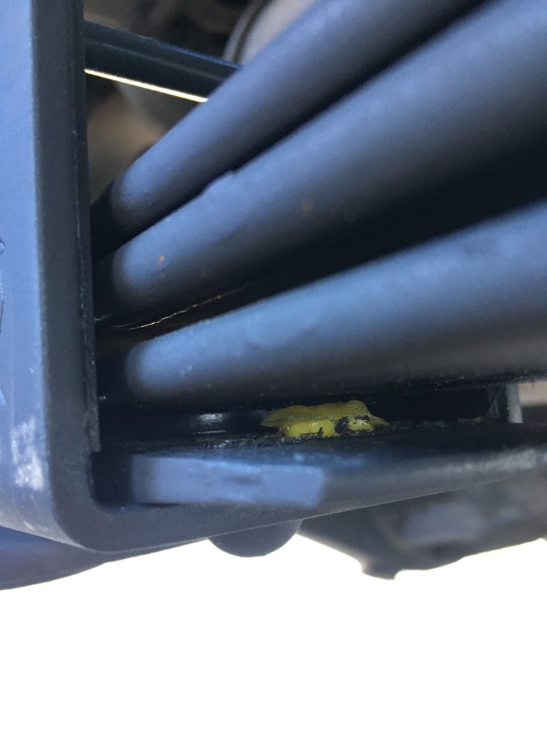

    After I got everything torqued i noticed that one of the spring isolators had fell apart in shipping, working with Wheelers on that but just something to look out for. Other than that they held up pretty good in shipment.
    Overall so far I am pleased with the new version of the Dakars, the ride it good, stiffer than stock but handles loads well. So far I have hauled 500 lbs of lumber around and a half yard of gravel.

    Got my replacement spring isolators from ARB the other day too, thanks to Josh and Kelly at Wheelers Offroad.
