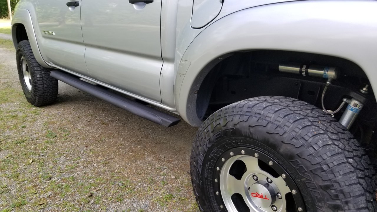

    This is the only pic I have but it doesnt show the leafs. They arrived in pretty beat up condition from shipping. I used a scotch brite pad to scuff them up and laid a couple coats of spray paint before I installed them and that seems to be holding up well.
