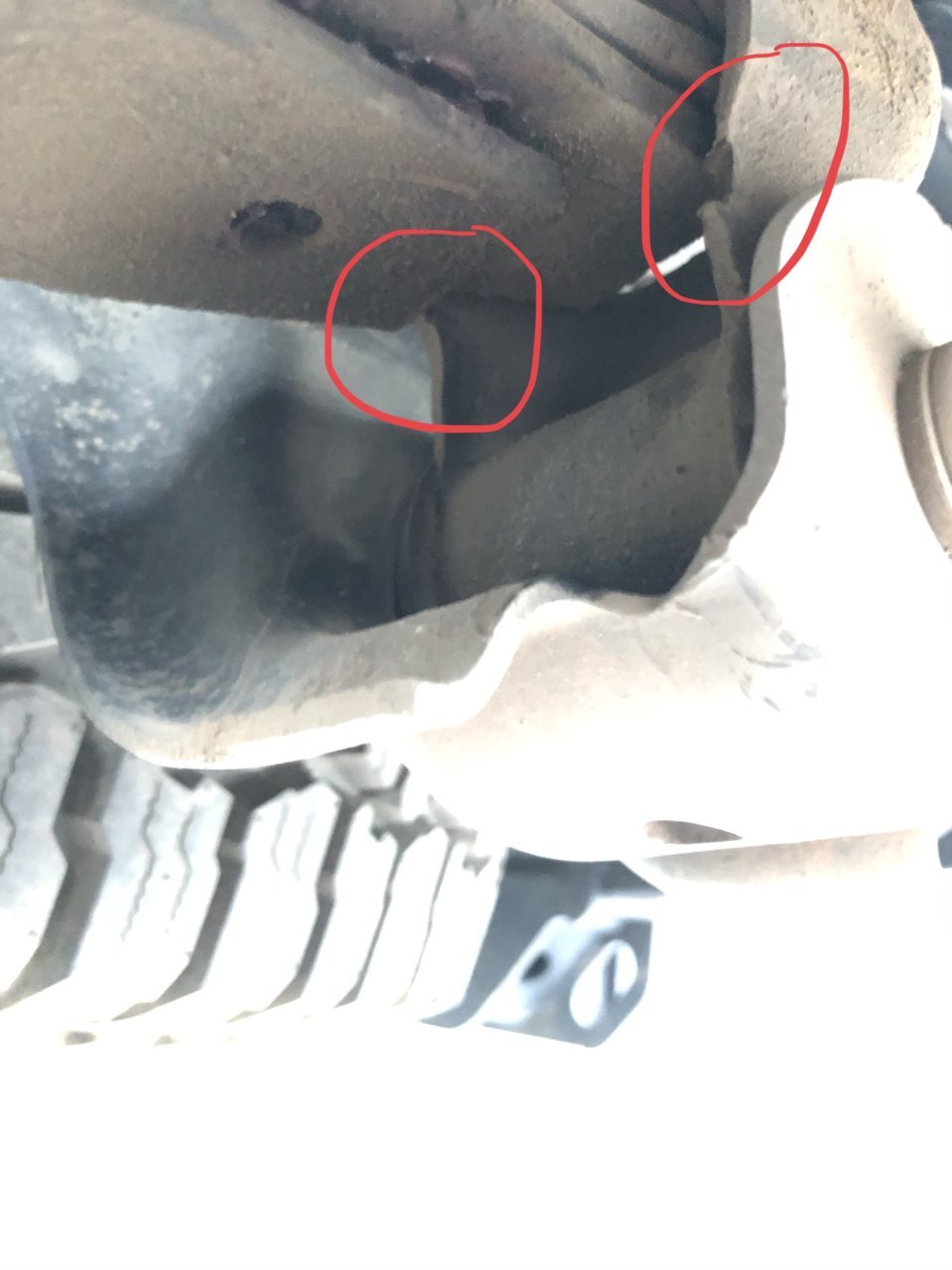

    I dunno, I’m on the fence with Dakars. I have a year and 3 months on mine. They are the HDs. They are beating up my shackles. Everything is tight and my shackle hangers are not bent. I have concern they are already worn and need for replacement.

    I just checked mine out and don’t see anything like that. But I wonder if it’s what looks like are extended 5100’s? Maybe they weren’t designed for the extended droop?
