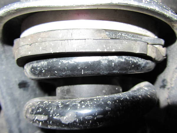

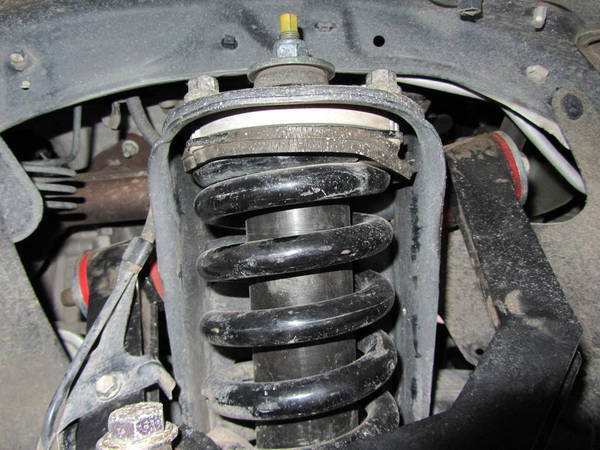

    I've read that a lot of members are happy with the OME set up but for me the ride seems to stiff and not smooth at all. I had a friend install the DSM UCA's and the OME 90000 front and the N182 rear shocks. I already had the Toytec 3" lift kit with 885 coils.
    So I've been using the search to find out why my ride is stiff. I ran into a post by Tacomman91 and he thought his coils were installed upside down. That led me to go out and look at my truck and I found some rubber that doesn't look like it's installed properly, it's uneven to say the least. I'm hoping to find a solution so I can get that awesome ride everybody is talking about after getting OME installed. I'm tempted to go to a meet coming up at the Pavilions in Scottsdale AZ and have one of the members test drive my truck and see what they think and to make sure I'm not crazy.

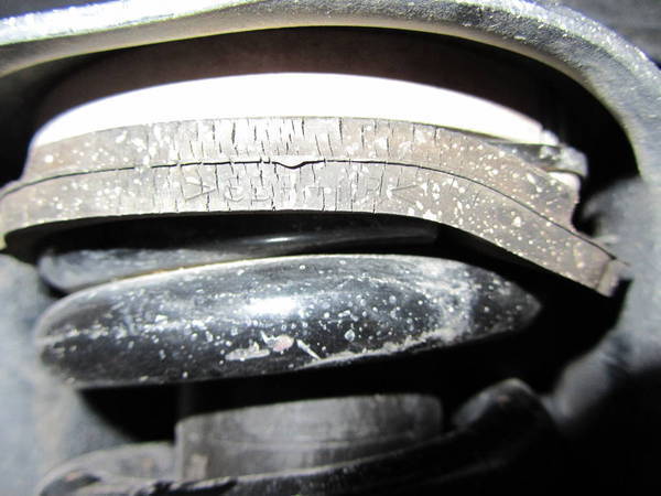

    So does it look like the mechanic did not install properly? I took pics of both sides up close and one from far away from passenger side. Thanks for the help.

    Springs look to be installed upside down...

    Im sure it would make some difference. No need to take more pics, as I can see the end coil digging into the isolator. Obviously the person who did the install never played with legos, let alone knows how to assemble shocks.

    There is no "smaller opening" . The flat part goes up, and the lower spring seat matches the end coil.

    could that rubber piece be installed upside down cause it sure looks like its bulging out as compared to mine

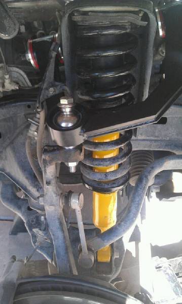

    Ok so he claims he installed them right and just sent me this picture that he took right after the install. He said "those black coil cups came with the emus"

    The isolator is installed correctly.
    LOL!!
  14. Mar 3, 2012 at 7:31 AM
    chris4x4
    chris4x4 With sufficient thrust, pigs fly just fine. Moderator
    May 8, 2008
    #6497
    112,751,541
    FlimFlubberJAM
    Tenoe, AZ
    2019 Rubicon 4 Door,
    4.10 gears, sliders, and lots of buttons.
    Bottom line is this.....The spring isolator shouldnt be bulging out like that. I know of only 2 things that cause that.
    #1. The isolator was installed wrong.
    #2. the springs are upsdide down.
    He can say they are right all he wants, but it doesnt change the fact that something is wrong. Looking at the pics, it looks as the spring is upside down.

    If the springs are not installed up sdide down, then the spring isolator needs to be set correctly. Regardless, they need to be taken apart and fixed.

    Top of the spring should be tapered flat to seat with the rubber, bottom of the spring should be normal and end butts against the rise in the spring seat cup.
