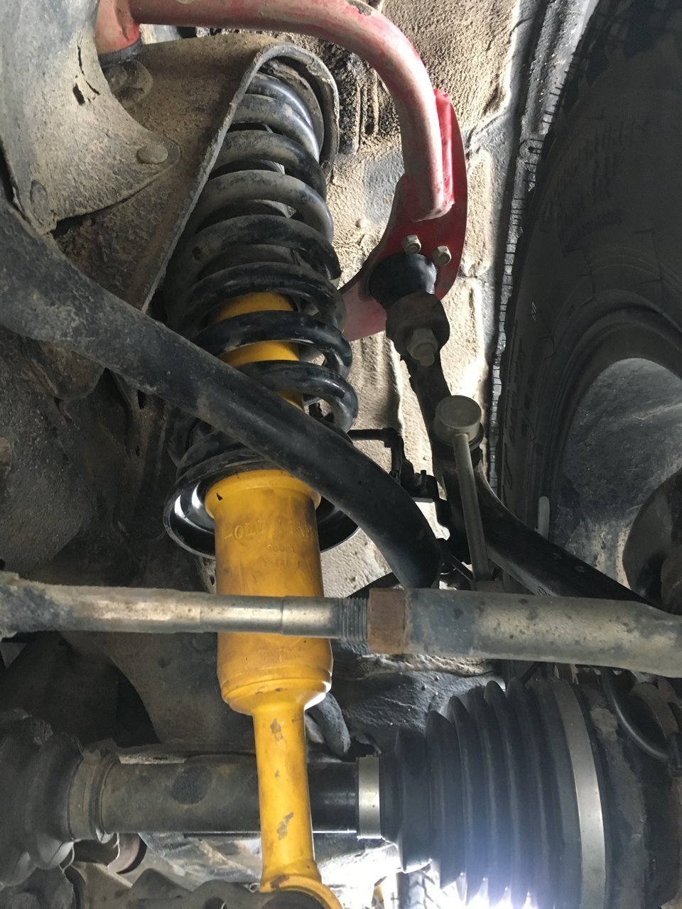

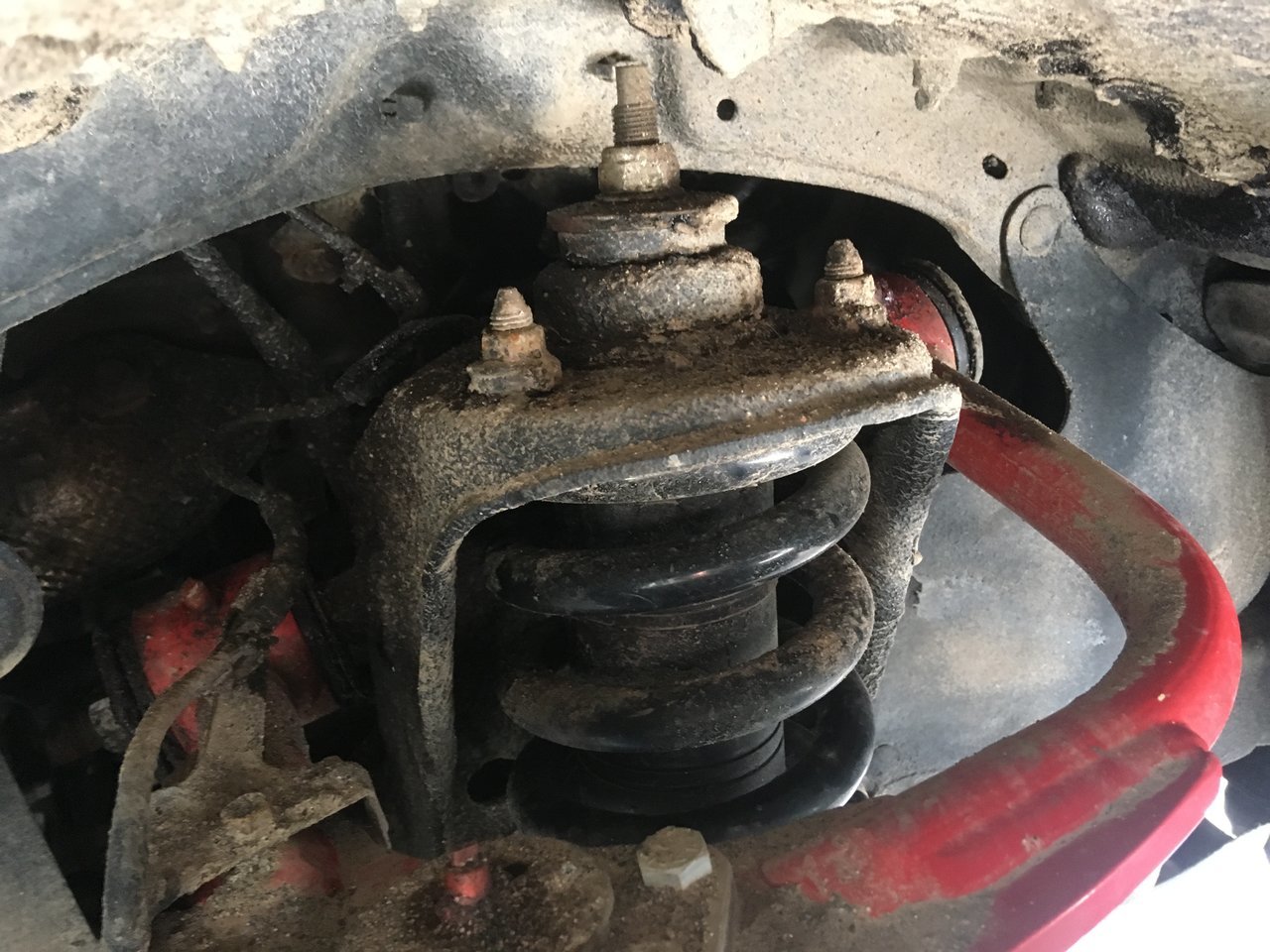

    is it even an option? if so any advice would be much appreciated
    I’m in a 16 AC OR manual. Stock bumper, no winch, cap etc.

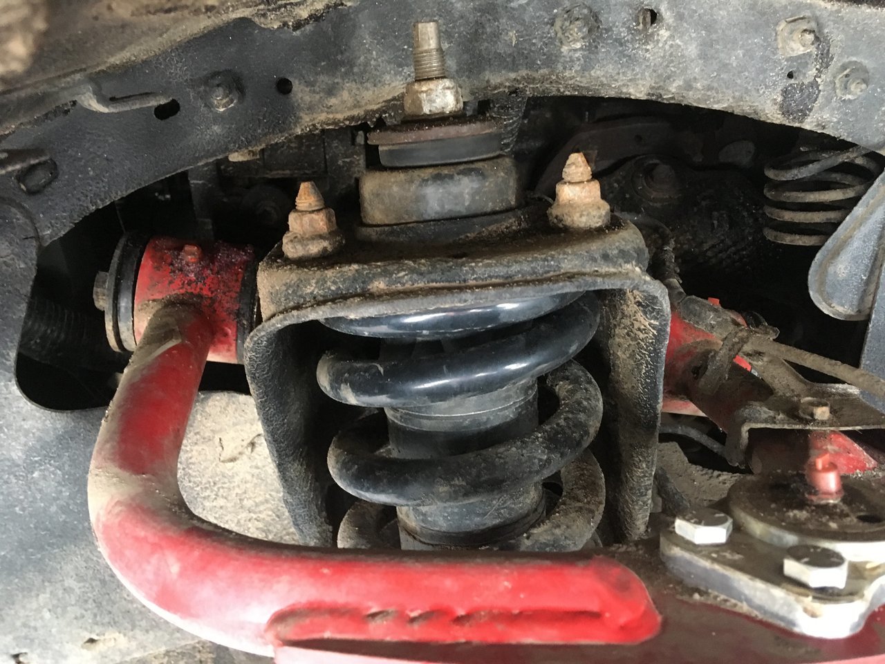

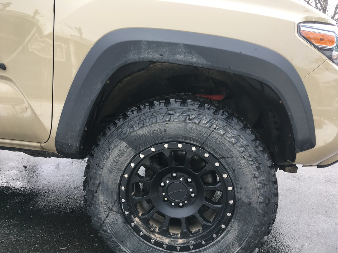

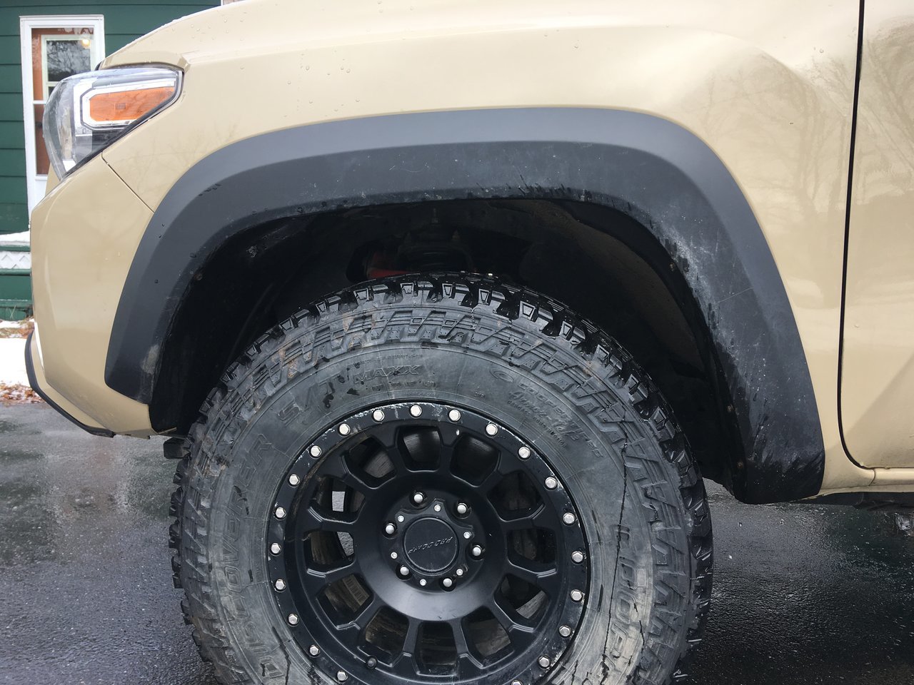

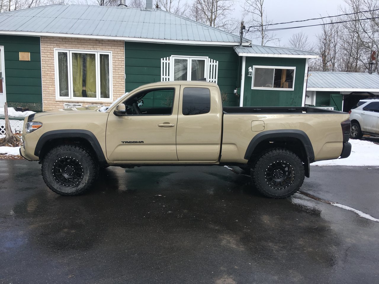

    Had the medium duty ome kit (888/dakar), drivers trim packer, installed afew weeks ago with JBA ucas and egcs bushings and 255/80/17. Removed front mud flaps.
    initially I loved it. Slight rake, had zero rubbing, alignment was and still is great. rides better than stock.
    Til this weekend...first time I took it loaded into the woods on some rough dirt roads. I had noticed some settling before but now I’m rubbing up front on passenger side and the rear leafs are squeaking like crazy which I’m thinking I can fix thanks to the massive thread on that.
    I’m wondering if I shouldn’t have gone with the HD kit....being a heavier dude (220lbs) and what I use it for. (Will be towing a boat around 2900lbs) this summer.
    Little sour at this point after doing my research (I guess not enough), wanting to do it once and ending up like this after a couple weeks.... hopefully one more go and she'll be ready for spring/summer when the real adventures go down.
    Game plan is to hook up the boat , load the bed with gear and see how much sag I get on the rear. Then come up with a plan to bring up the front enough to stop rubbing, and level the back if/as needed (timbrens? sumos?)
    Takes forever to sift through info on here so I’m not sure if I can even add a spacer to this set up. Prob just make some calls to reputable sources. Thing about being in Canada is to save $ you have to go through places that have less than knowledgeable staff to source parts.

    2020 Tacoma
    That thing doesn't even look like it's been lifted in the front.
    Probably the tall skinnies though.
    Sorry to hear it's sagging.

    2017 DCLB trd off-road bbp

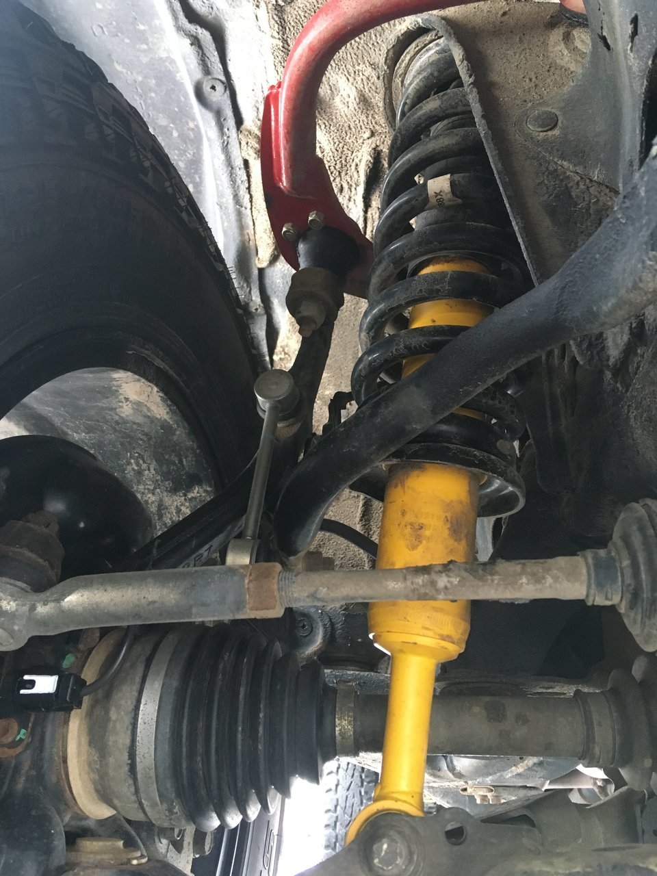

    that front doesnt look right, especially with the 888's....
    did you put the shocks/coils together yourself or had them preassembled?

    coming soon
    ordered through 4w parts, they came separate. took them to a shop to be installed
    what did you put in for struts? the OME90000 stuts?

    coming soon
    yup,
    2 x 90021 – Front Old Man Emu Nitrocharger Sport Struts

    2017 Inferno DCSB TRD OR 4x4
    Doesn't look right at all compared to this user with OME shocks/springs too. Don't think the springs would make that much of a difference without you in it.

    Don't put a spacer in, this will happen.

    King Ranch F250 Powerstroke
    Op isn’t talking about stock struts. Try again. Lol

    coming soon
    indeed they are....FFS...took it to a shop to avoid any issues and this is what I get. Luckily he's a walk away from the house and I just talked to him. he's going to fix it no cost as well as do what he can about the squeaking in the rear even though I know that's the leafs not his work.
    but he's saying that's not going to bring the front end up any.... am I right to have a hard time believing that it won't make the kit perform as designed?

    Mostly Stock for now, 265 75 16 Falken AT3W, Tinted fronts...
    I think flipping them will add a little more preload. Same as moving the collar up on 5100s. It’s probably a few millimeters, which makes a big difference. Just look at the small difference between settings on the 5100s or the length of 888 vs 887 vs 885.

    Just add Headstrong 1/4” spacersto front for 1/2” lift mine are perfect with no issues and i offroad

    much appreciated dude. I'm going to order and have them installed when I get the collars flipped.

    2020 Tacoma
    I wouldn't go back to the guy that installed it wrong to start with.
    Holy shit!
    Yes. When it is installed right it will give your more lift and ride better.

    Another reason to get them pre-assembled from headstrong
