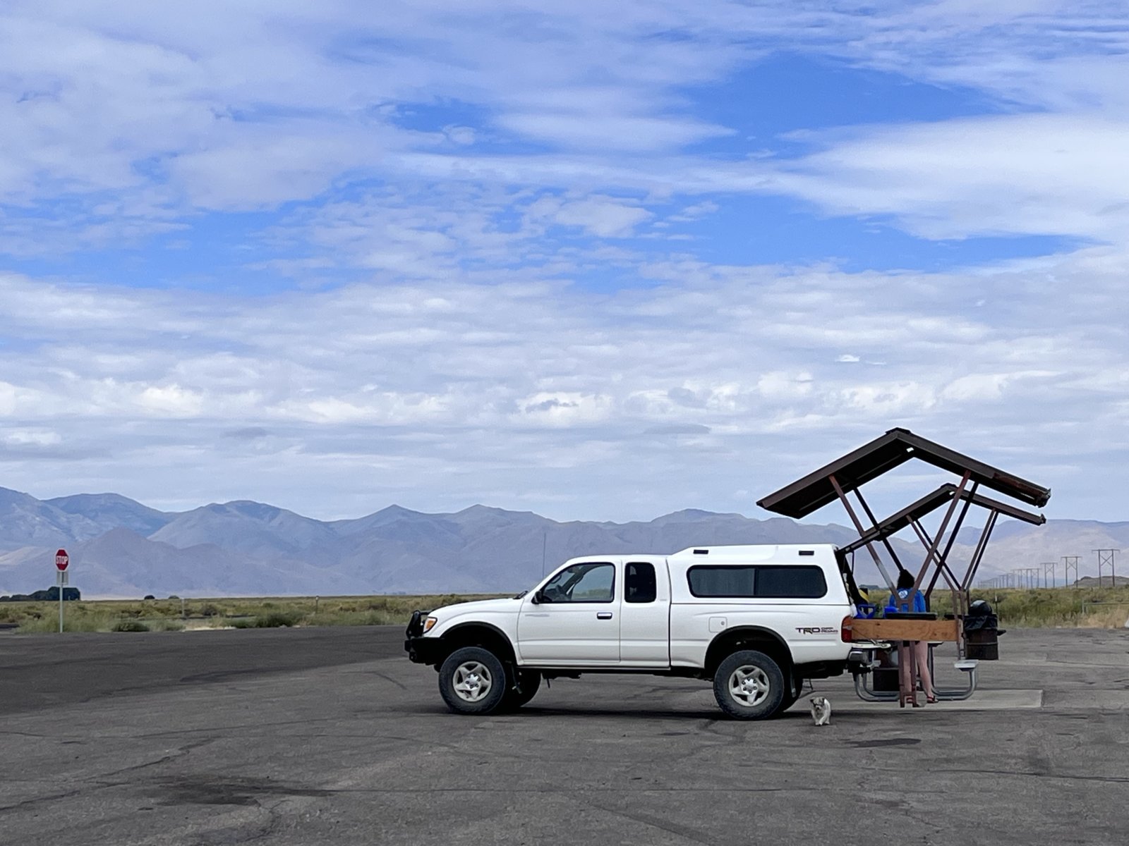

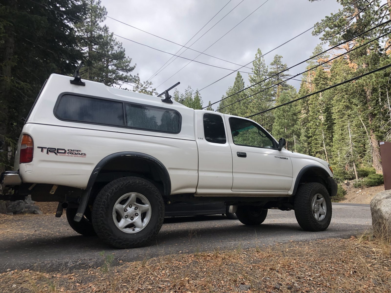

    I have 882s with nitrochargers and Dakar with AAL on my extracab. I usually have a ~300lb platform plus a fiberglass topper on the rear. Even with an empty bed and before my ARB bumper, it sits pretty level and drives well albeit it a bit stiff. 882’s felt 10x better with some weight on the front.
    first pic is fully loaded for camping with an arb bumper and warn winch in the front. Second two pics is right after the lift, empty bed.

    Thank you both for your input. Paul, those pictures are super helpful for me- looks pretty awesome! I'll reach out to Kurt/Cruiser Outfitters to get some more questions answered.

    You’ll have a lot of rake even with the 882s after the install for a little while but they’ll settle down eventually.

    Yeah, that's what I've heard. Maybe I'll cruise around with some sandbags for a bit.

    It's just the angle of the photo, but that picnic table cover looks like it's part of the "300lb platform" :eek: and I was thinking "how can that only weigh 300 lbs...?" ;)

    LOL, I thought the same thing! You beat me to it!
