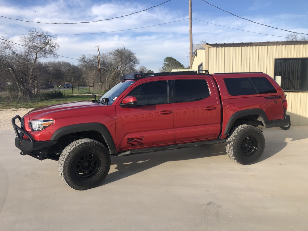

    I have OME Full kit. Originally started out with the soft ride shocks and 888 springs with trim packer. EL096R leaf springs and soft ride rear shocks. All was great till I added armor and bumper the 888 sagged and the soft ride was overly spongy, leaning and not stable. Ordered 886 on Firm ride shocks installed and left the rear soft, handles great like it should. The rear has plenty of traction

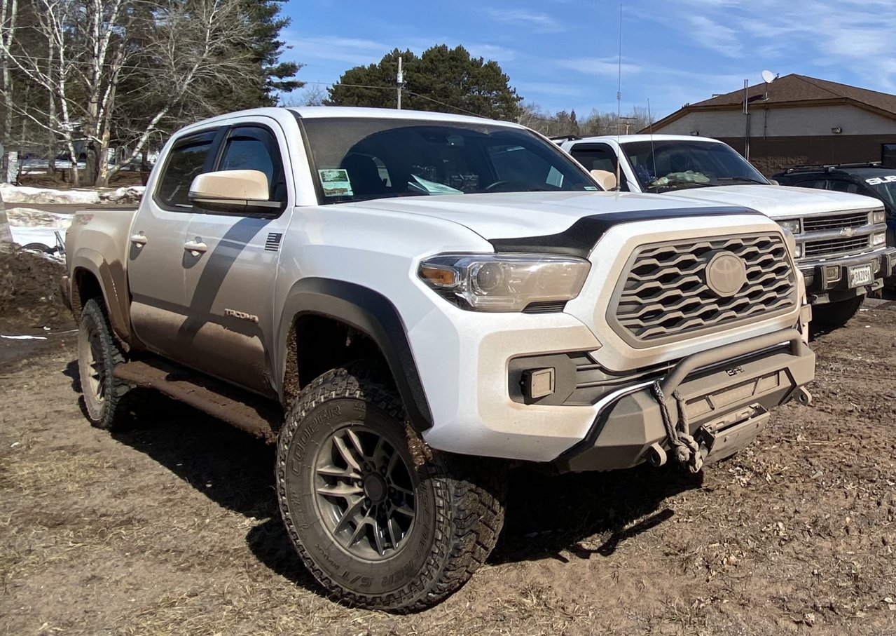

    FWIW, this is how my bumper and winch sits with 888 springs and 255/85R16 tires.

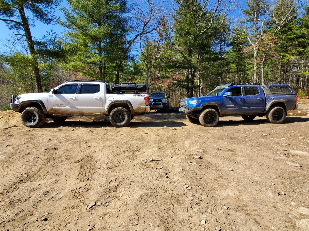

  20. Mar 22, 2020 at 3:35 PM
    #20
    boston23
    boston23 [OP] Well-Known Member
    Sep 4, 2019
    #304290
    3,363
    Adam
    NM
    2019 SR5 DCSB 4x4
    Nice rigs, any differences in opinion/experience from you and your friend with the different coils?
