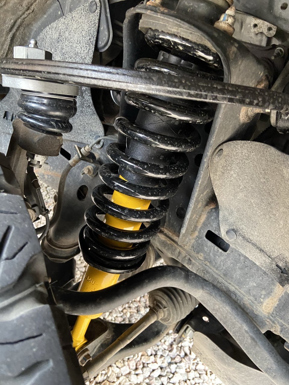

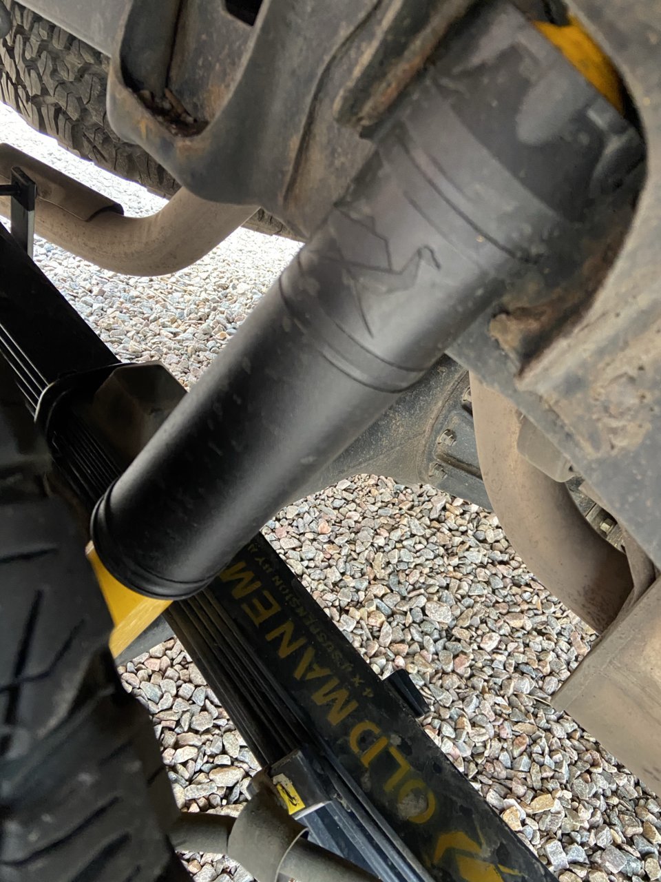

    2010 Pyrite Micha Tacoma DC SR5
    Ome 884, ome 90021, ome 60021, ome leaf pack, spc uca’s, Leer cap, bf k02s, carplay head unit, carhartt seat covers, 15% tinted windows, bed extender, power outlet in truck bed, spare tire lock
    Got my ome kit installed today:
    884
    90021 and 60021
    Ome 4+2 leaf pack
    Ome bushings
    Spc uca’s
    drives great

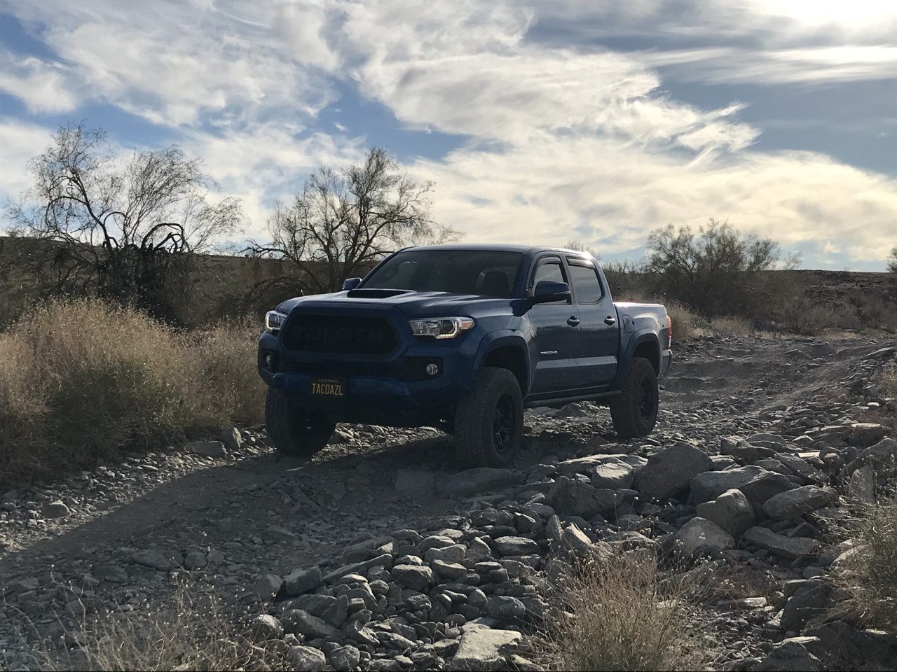

    I'm on 33s, 255s
    Here's a pic with no one in the car. RTT and alucab on the back.
    taco kai[QUOTED] likes this.

  14. Aug 28, 2020 at 8:30 AM
    #54
    taco kai
    taco kai Well-Known Member
    May 7, 2019
    #292508
    85
    2016 inferno TRD off road
    any rubbing in front when stuffed? looks to be about as high as mine rides now.

    Yup cab mount when reversing and turning

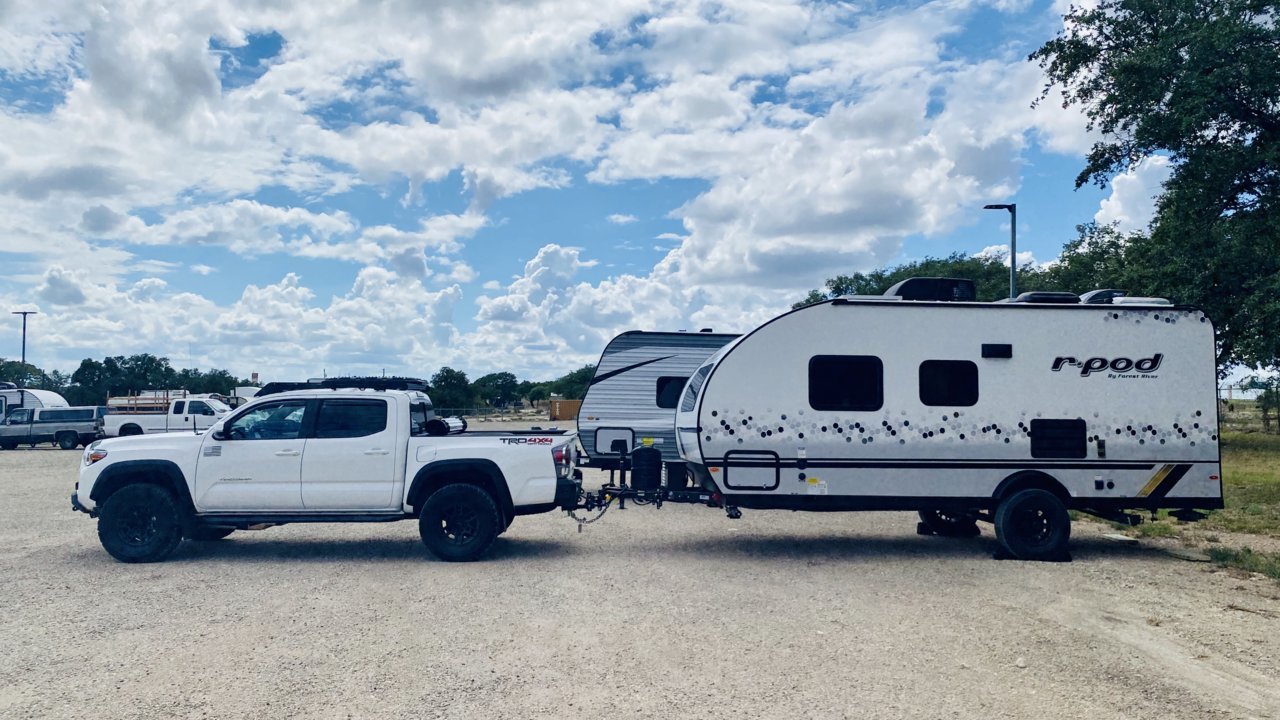

  20. Aug 29, 2020 at 3:45 PM
    #60
    EchoDeltaSierra
    EchoDeltaSierra Well-Known Member
    Apr 13, 2015
    #153078
    415
    Georgetown, TX
    2020 TRD Off-Road
    Nitro 4.88 gears OME suspension ST/Maxx 255/85R16s
    Update. Here how the OEM suspension sits with the trailer hitched up. I’m running the softer shocks, 888s, and standard leafs. The trailer is about 3700 lbs and I’m running 800 lb bars on a ReCurve WDH. Also, those are 33s (255/85R16) on the truck and a 2” lift and 31s on the trailer. It pulls the trailer really nice on the Texas highways and performs great on the trails and in the dirt (without trailer).
    taco kai likes this.
