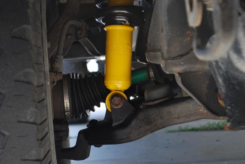

    Diff drop doesn't do much but rotate the diff forward a bit, it literally does nothing to help CV angles.

    Are you sure about that? It did what it was supposed to for me. There are only two mounts for the front diff, which are long arms that extend from the diff to the frame. By adding spacers in those mounts, you are indeed rotating it relative to the frame, but by doing so, you effectively lower it as well.

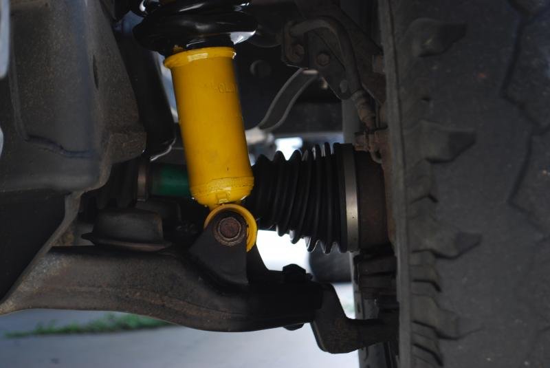

    Yup. But because it only drops one side the cvs are only lowered about 1/2" which does help still but not necessary.

    Here are my CV angles with literally 0 miles (hell, 0 feet) on the new suspension. It's obviously settled a bit thus the angles are even better now.
    881s with no diff drop:

    Seems to vary by vehicle for some odd reason, but mine did help. I actually pulled the spacers out a couple weeks ago as I wanted to see if it would help with fabricating a skidplate. And I did notice with the spacers out my boot fins rubbed but with it back in they have about an 1/8" of space.
    It does not actually drop it 1", more like 1/2" as everybody notices. With a game of inches being played here, I think every little bit helps.
