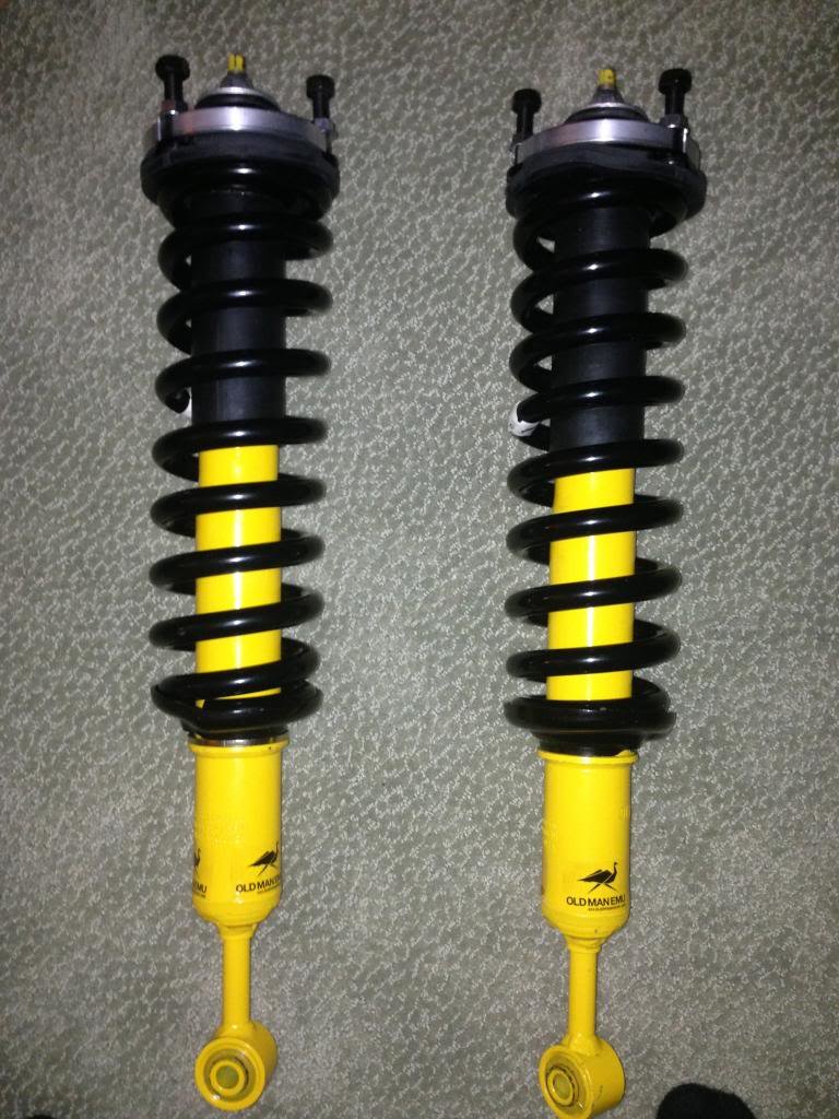

    I installed a top plate spacer on 885 coils to achieve the full 3" of lift:
    You can see them at the top of the strut assembly (Silver 1/2" spacers)
    I measured the front for OZ (Hi OZ :wave:)in another thread about my OME lift install and there was zero change in measurements after 2 months of being installed. I am running an OEM bumper. Thread: http://www.tacomaworld.com/forum/2nd-gen-builds/293161-ome-kit-finally-installed.html
