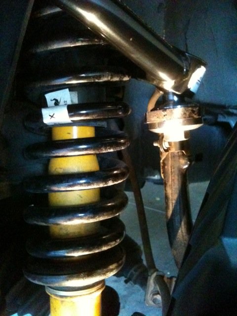

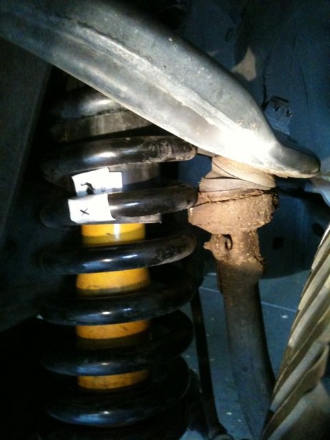

    Is this the problem you're talking about:
    The ball joint doesn't have enough freedom to allow the spindle to travel parallel to the tire movement. So as the UCA swings down, it starts forcing the spindle, via the ball joint, towards the coil spring. It all has to do with the geometry of the original suspension and the fact that you are pushing it to operate closer to full droop.

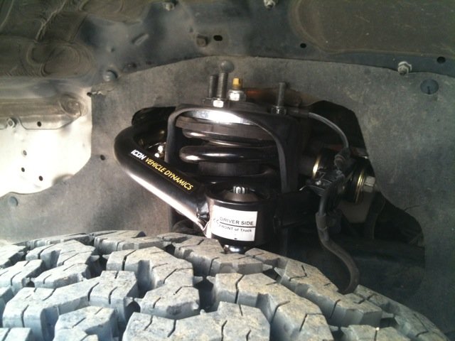

    If it is the problem, I solved it the expensive way (uniball ucas):

    Yep that's the problem, except its the lower edge of the spindle that touches the coil, not the top edge/ ball joint like yours.

    That's at full droop. It already dragged against the coil and popped to the bottom side. :eek:

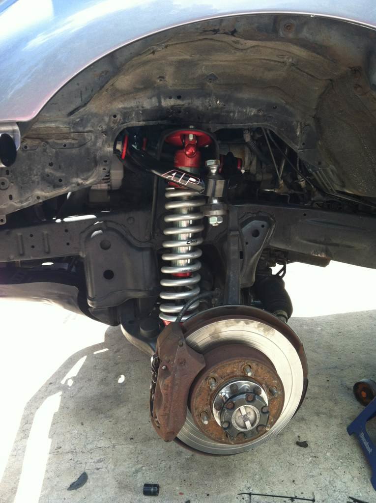

    If you're messing with the coil, trying to get it to line up just so, the suspension is reaching its limits. Don't know if the LR's will fix it but the Camburg's are decently priced and may fix the problem. Otherwise, I'd recommend taking the spacer out.

    All Pro's are even cheaper than the burgs at $499. They are very well made. Although I haven't got a chance to really test them yet. I love mine so far:

    After finally hitting the trail with the new UCAs, very happy I got them. Had a lot more control bajaing through the arroyos and had way less traction problems when rock crawling. Highly recommended if you do a good bit of off-roading and hanging on to the truck for awhile.
    Removing the top plate spacer is the cheaper solution. When I installed mine, I got roughly a 1.5 to 1 lift ratio. Not sure of the height of the one you are using but it'll drop the nose about 1.5 x the top plate spacer height.
