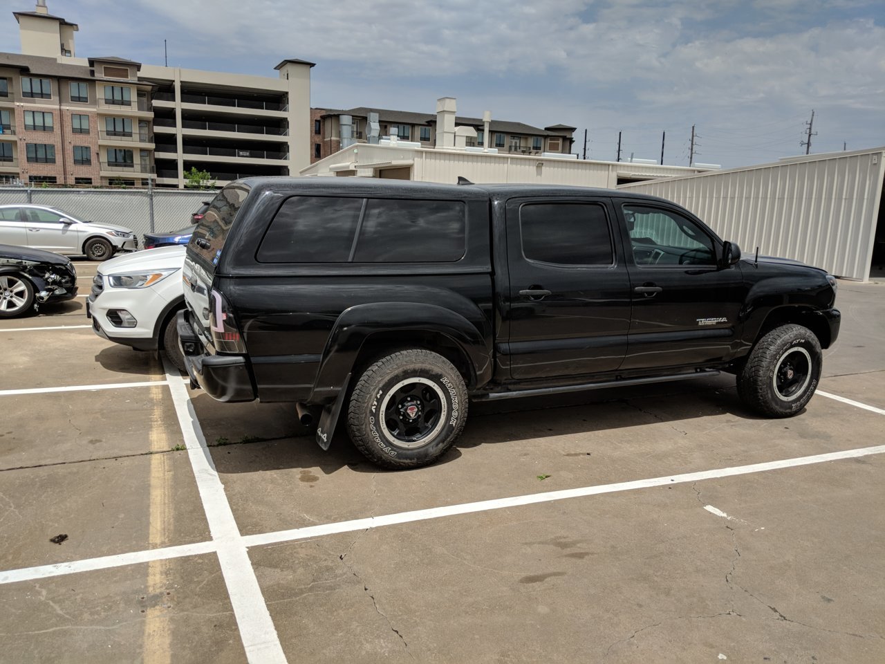

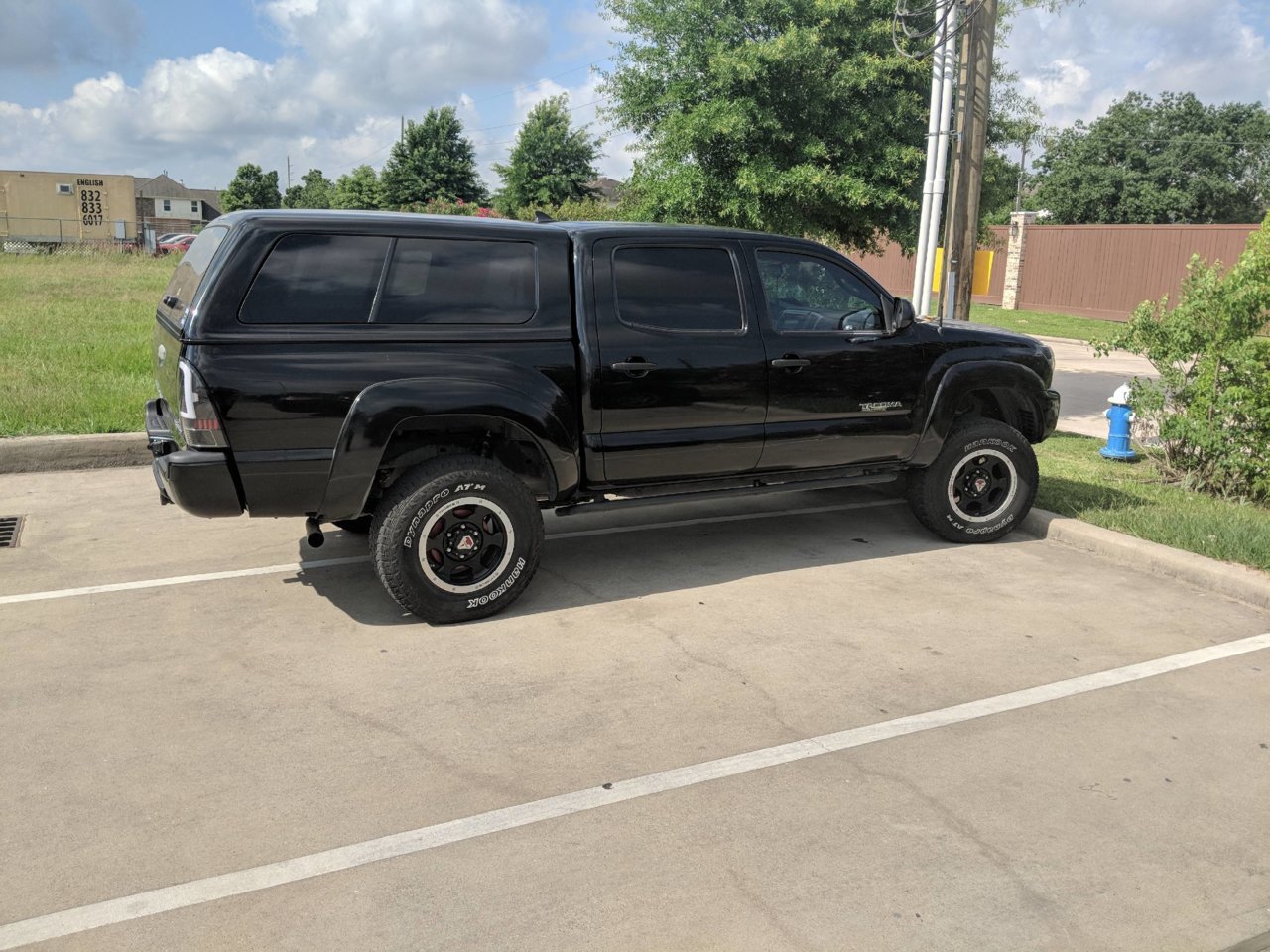

    I will have to say yes to at least medium duty Dakar springs. My truck had bad springs I swapped out for heavy duty Dakar. And I bought cheap 1.5 inch spacers for the front to dress it out right. IMG_20180520_155012_01.jpg
    Kolter45 likes this.
  3. Jun 22, 2018 at 9:39 PM
    Black 14 T-Force
    Black 14 T-Force Member
    Mar 26, 2018
    #248472
    10
    John
    2014 Black TRD T-Force 4X4 Double Cab
    That is after this is before. It's a small difference. But worth it. Ride quality is great even with 600 pounds. 200 pound camper 120 pounds of fuel tank ful and 200 pounds of tools and gear. The heavy duty Dakar springs are constant load springs with 660 pound constant load capacity. So when I unload the truck the rear sits high. I love the ride and capacity. Any questions let me know.
    Boxerfreak and Sauzacoma like this.
