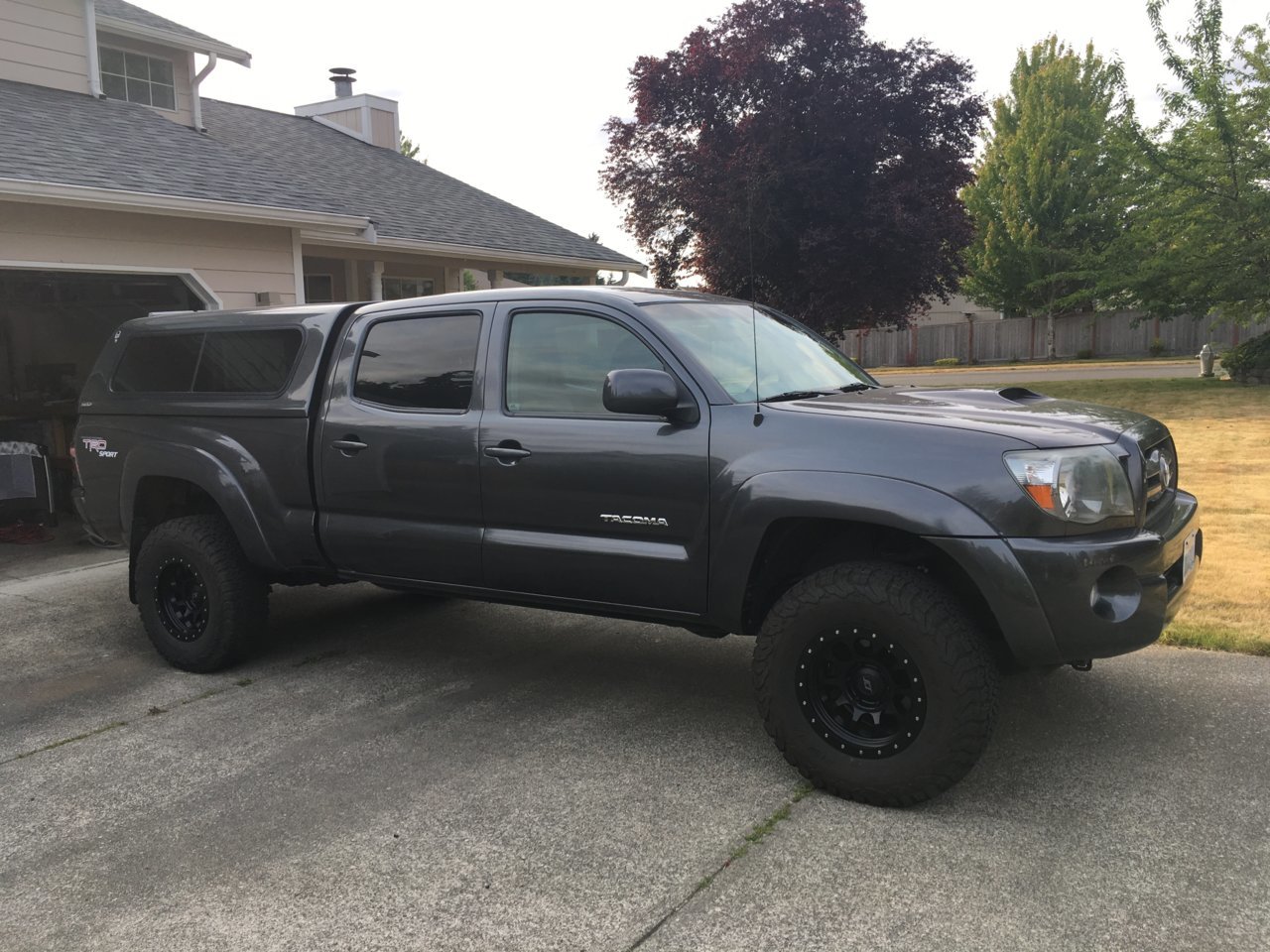

    I ended up getting 2.5" in the back with the medium duty Dakar. The 885 springs got me about 2". I was in a rush and didn't write down my measurements this morning. Back is sitting at 24" from center of hub to fender and front is 22.5. Looks to me like it should have come from the factory

    Thats pretty much the same spring setup I am going with. They should come from the factory like that, looks awesome mister. Rolling on 265/70r17?

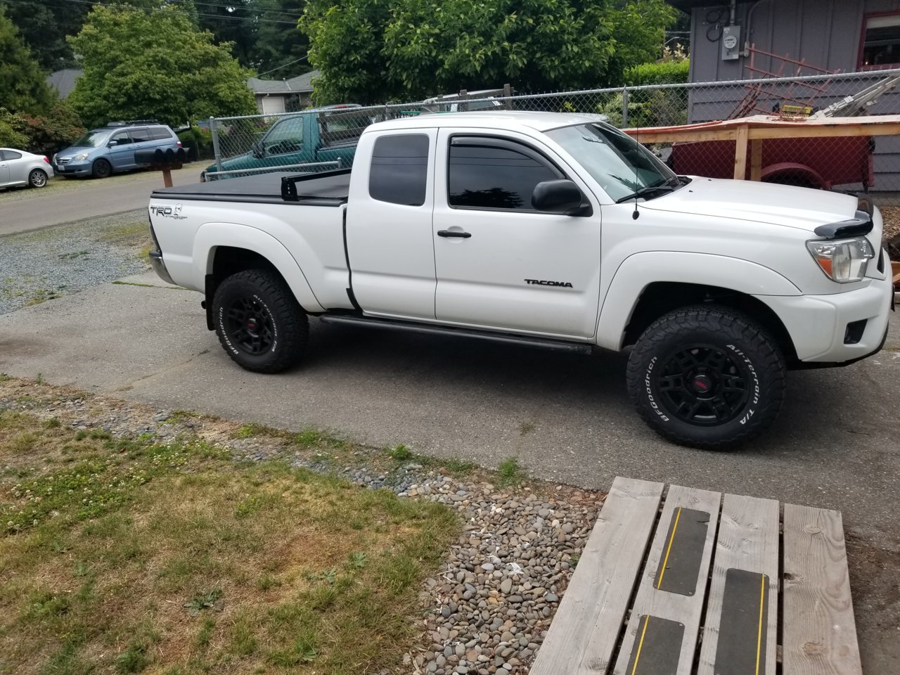

    I went with the Medium kit. It rides stiffer than stock but not bad at all. You get used to it. It sits similar to factory rake, and I bought this kit mainly because I tow a boat a lot (2500lbs) and needed something beefier than stock. I love it so far, and am running 265/75-16s.

    Looks great and thank you for your personal experience with the kit. Nice truck!

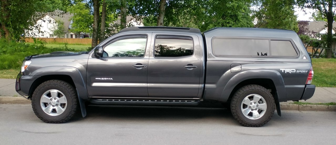

    Here he sits stock 19-1/2" from the center of the axle on the front and 21-1/2" on the back ...heck I still have my mud flaps on... for now.20180701_203258_HDR.jpg

    22-1/4" on the front and 24" on the back from the axles up and she rides super smooth 885 up front and the Dakar medium leafs in the back. Handles way better than stock. This is how they should come from the factory.

    Looks good man
