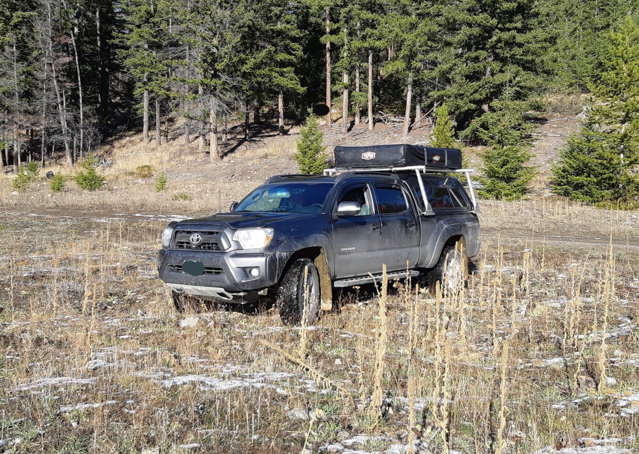

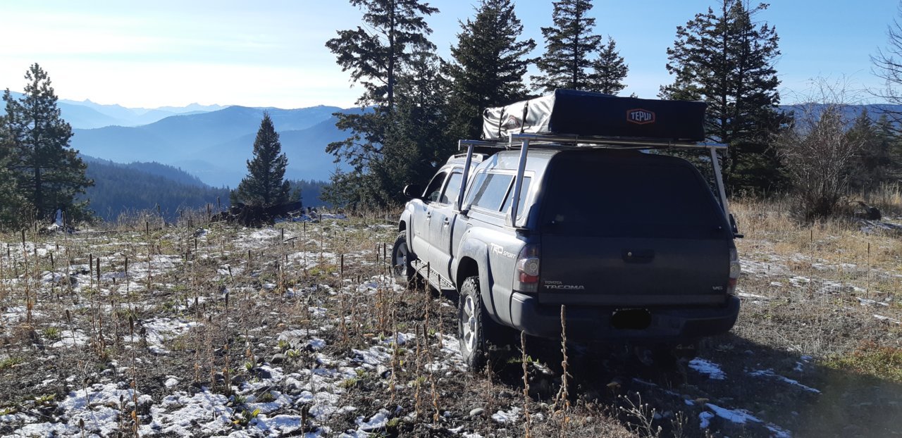

    OME 886, Dakar HD leaf, SPC upper control arms, Sport Nitrochargers, full coverage skid plates, Westcan Overcanopy Rack, RTT, Total Choas Bed Stiffners, Durabumps Bump Stops, 275/70/17 KO2, Arb awning.
    Okey people...lift was installed 3 weeks ago. Love it. We saw a rooftop tent while in the back country fishing, it was Tupei Ruggerized XL tent. We stopped and talked to them , crawled in it and now we are buying an over conapy rack and a 210 lbs roof top tent. So 50 lbs rack, 210 lbs tent, 10 gallons 2 cans of gas 85 lbs, 5 gallons of water 42 lbs, 50 lbs recovery gear, 40 lbs kayak we just bought and 150 lbs of other assorted stuff.
    627 lbs in total...should have just bought the heavy leaf spring, new AAL going in next week. Live, learn, spend!!!
