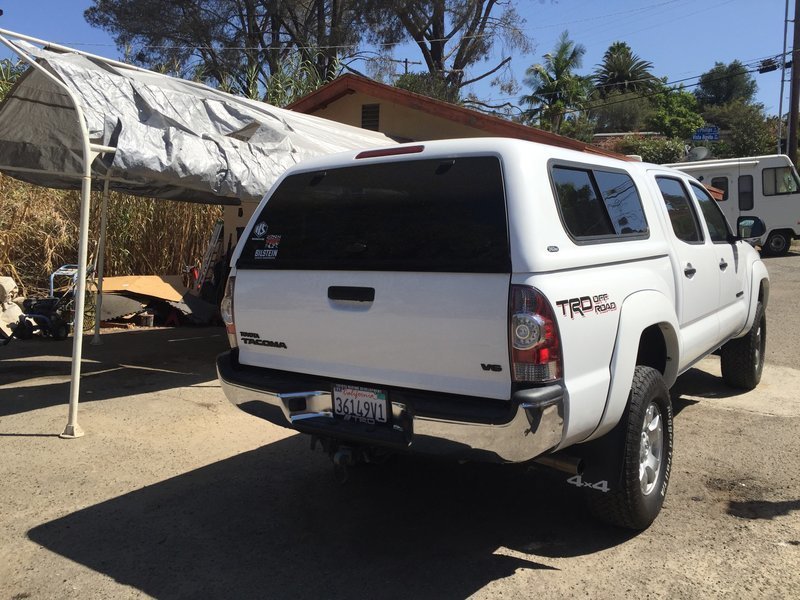

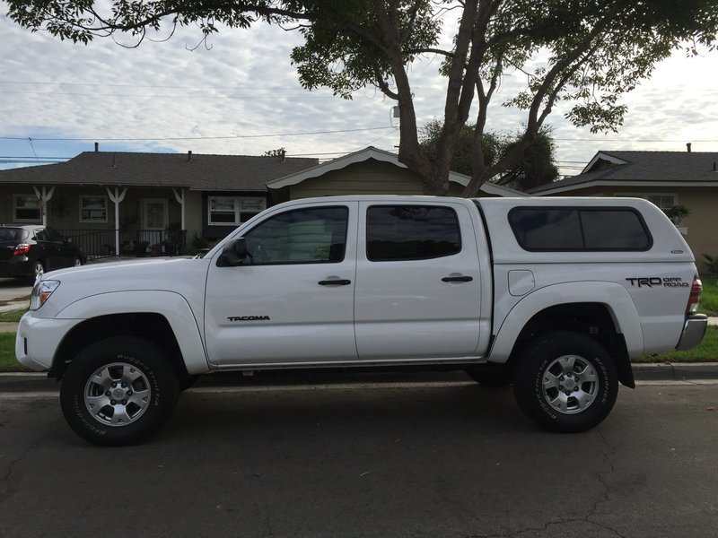

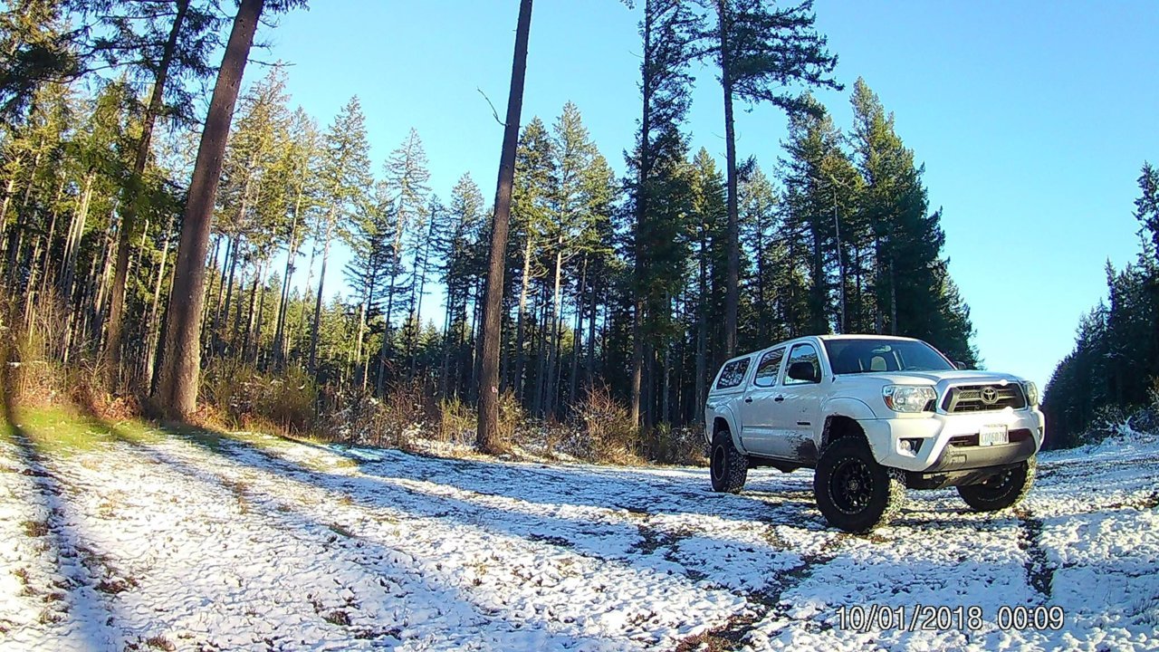

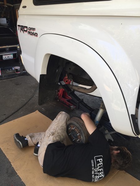

    Yes do it, I love my ride on road and off road with my OME Dakar CS047R Leaf Packs and 5100 Bilsteins. I had my springs installed in 2016 and they still are fantastic in 2019.

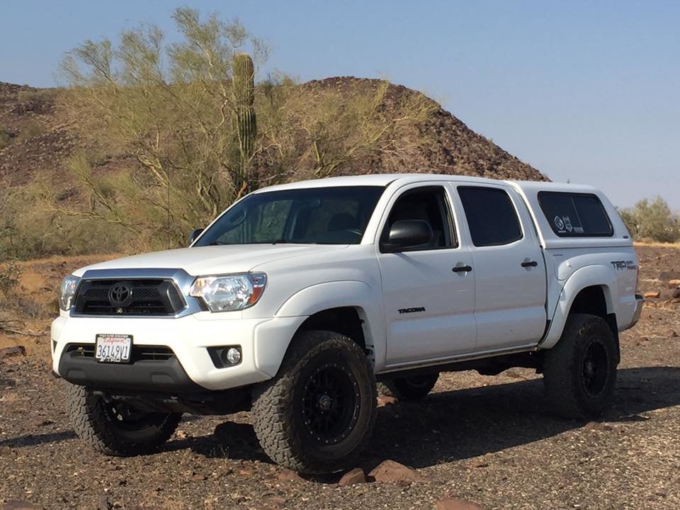

    Tires and Wheels:

    What wheel and tire combo did you end up going with? My 265s are going to be replaced in a bit. Looks good.

    Thank you for the compliment.
    I went with 17" Icon Alpha Wheels BFG KO2's 285/70/17's and love them. I did do a BMC and pinch welds also.

    Anything less seems to look a less than awesome on these trucks, thanks for being awesome. What back spacing and offset on the wheels and what control arms did you end up going with?

    Hey Trev, My wheels are as follows: 17x8.5" Icon Alpha Satin Black Wheels, 6x5.5 Bolt Pattern, 4.75" Backspace, 0mm Offset. I did not need UCA's because I only went up 2 1/2 " with the 885's and 5100's set at 0.

    Perfect, a finger width away from the UCA so you are good to go. Looks pretty snazzy.
