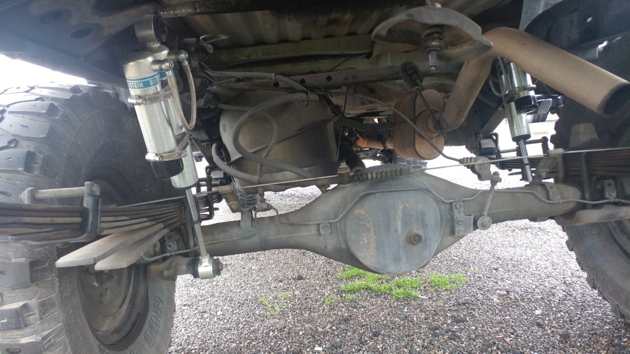

    I live in cali where it doesnt snow and i was starting to get rust on the bottom of the Reservoir so i put the bearing buddy on I like em thinking bout painting them. the shocks themselves are the dope like riding on a cloud
