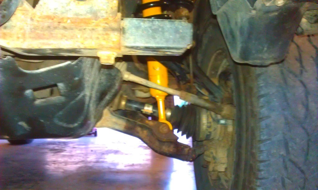

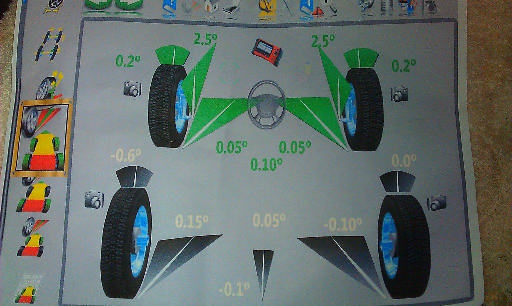

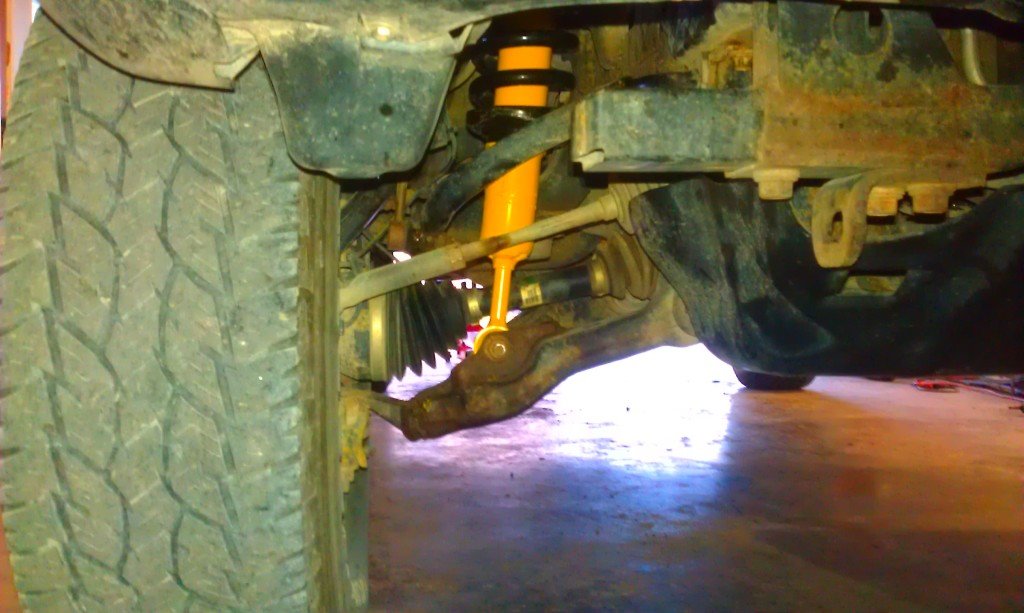

    So here are my measurements, measuring front center of hub cap to to the lip of the fender:
    before
    Front driver: 20 1/2
    Front passenger: 20 9/16
    Rear driver: 21 11/16
    Rear passenger: 21 7/8
    after
    Front driver: 23 13/16
    Front passenger: 24
    Rear driver: 24 1/2
    Rear passenger: 24 5/8
    Alignment specs:
    CV angles:
    Hows it lookin gents? Oz - will post my Dakar measurement in your thread shortly..

    bump...looking for opinions on the alignment specs and CV angles!

    It looks like you need to do the CV boot slide.

    I feel like the front has settled a little bit int the past couple days, as expected. The measurements I posted were taken the same day as the install. I will re-measure in a the next day or two. If my CV angles are too steep, could that cause a vibration, maybe pointing to a bad wheel bearing?
