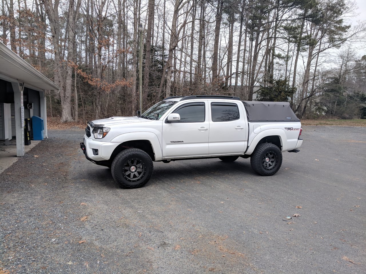

    And I'll whore out my truck because i took a fresh pic today.
    5100s, 887 coils, JBA UCAs
    Fox 2.0 RR w CD adj. And Icon AAL in the rear.

  10. Mar 6, 2018 at 11:27 AM
    REDdawn6
    REDdawn6 Well-Known Member
    Jan 24, 2013
    #96016
    1,493
    Redlands CA.
    2011 Tacoma TRD 4x4
    Love that Softopper
    Chase8059 likes this.

    I know you are right. I am just becoming inpatient, but I have put off the spacer kit for 6 months to opt for going with a full suspension upgrade, what is another month or so to do it right.
    Very nice truck by the way. 265's or 285's? I like the lift and look pretty much the ratio I am going for.

    265/70r17
    One day I'll jump up and join the CMC folks and get 285s. I do keep seeing the skinny 255s and they get me thinkinf also.
