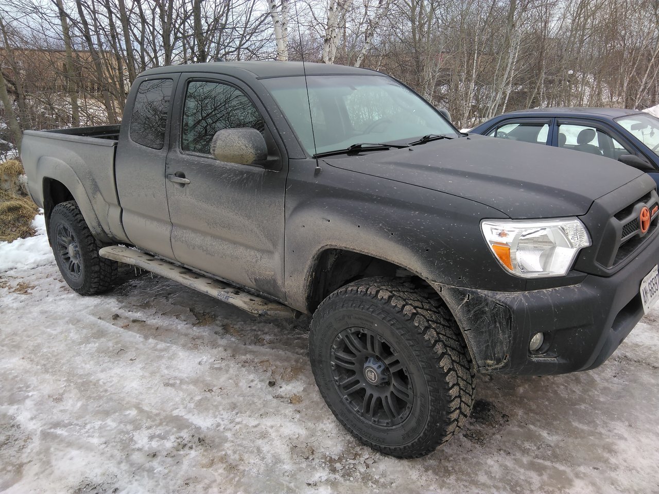

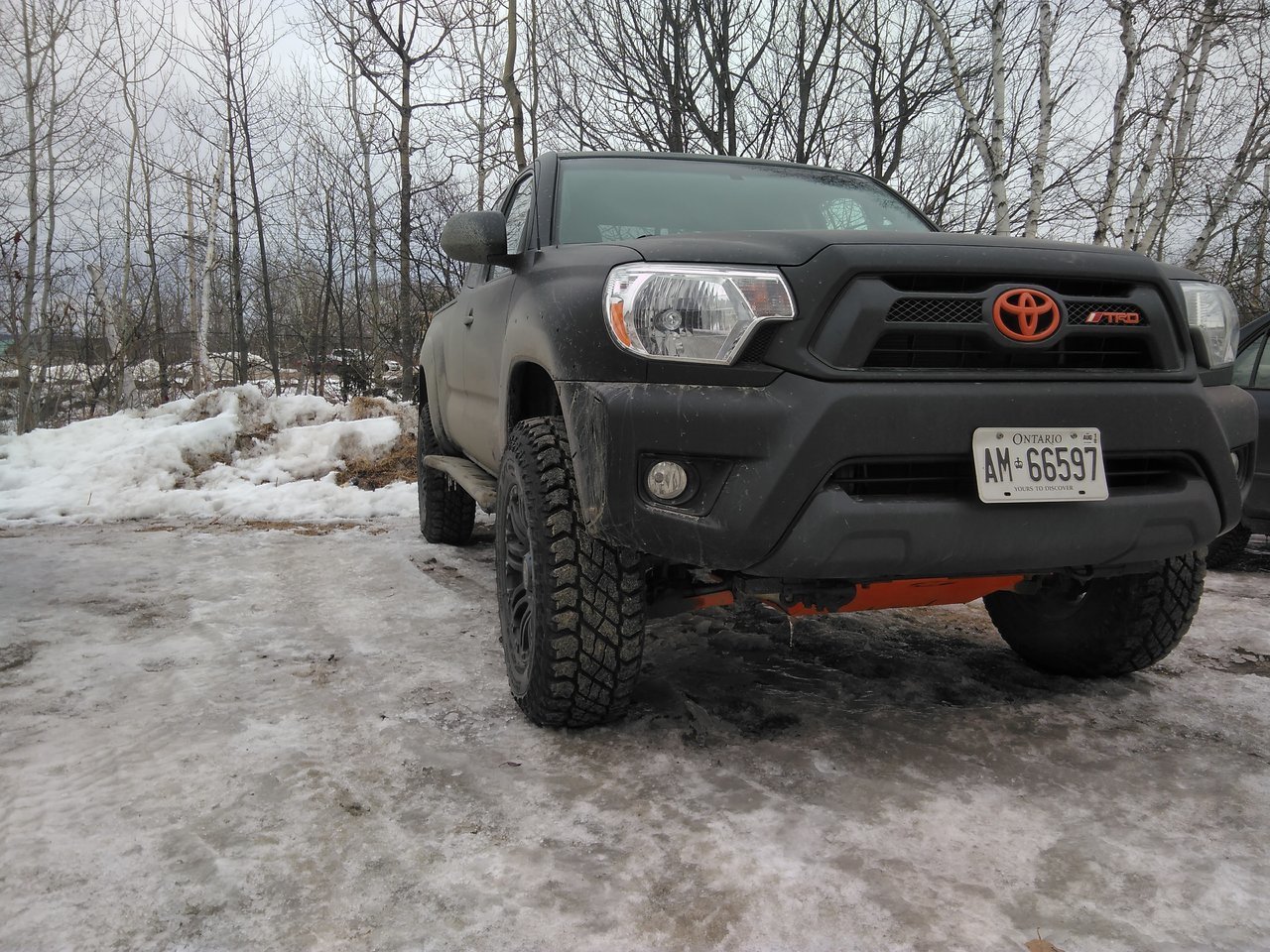

    Before I removed the front flares. Ill go take one right now how it sits.

    It was hard to tell exactly what lift I obtained from my suspension upgrade, because I had fully armored my truck 1st. So it had sunk the stock suspension.
    With the front fender flares off, passenger side front it measures 23 inches from center of hub to fender.
    They dont look skinny until you put the truck beside someone with 285's then you can noticed right away.
    Full suspension upgrade + remove front fenders flares was all I had to to fit them lol.
    I didnt want to cut up the fender flares, I dont like the way it looks. I just wanted em off.
