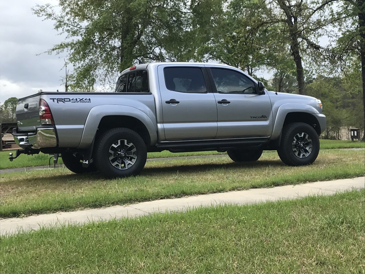

    Looks sharp!
    How’s the ride on this? And what psi do you usually keep your bags at to stay level?

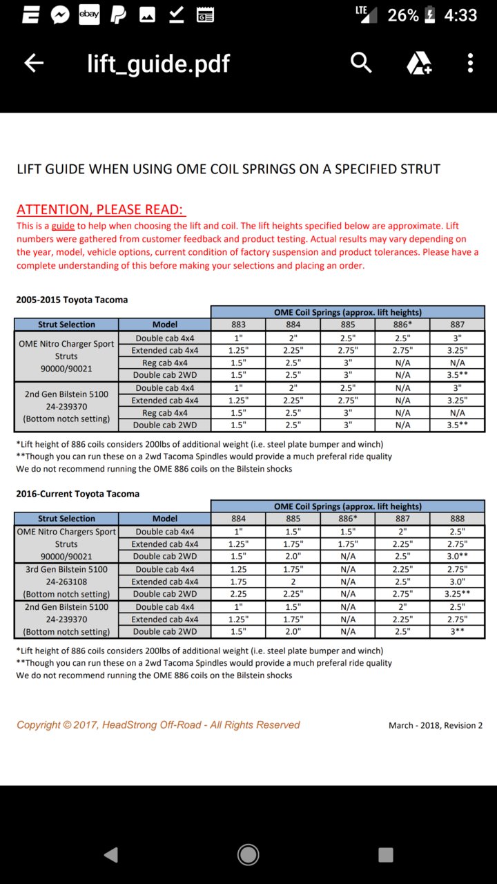

    What he said. 887s should get you 3in up front. The ride is much smoother than the preloaded 5100s at 1.75.

    I think you want the 884 coils. They should be 2in of lift.

    Here is the lift guide from headstrong.

    Perfect, thanks! 884’s it is.

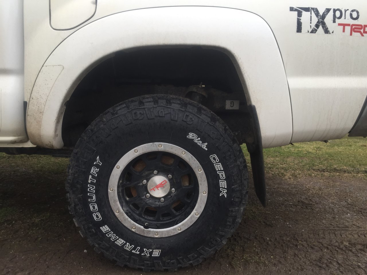

    I didn’t get any good pictures because it was raining all day. But here Is the final project. I have to remove the front mud flaps today and see if I can modify them before I decide to remove them completely.
