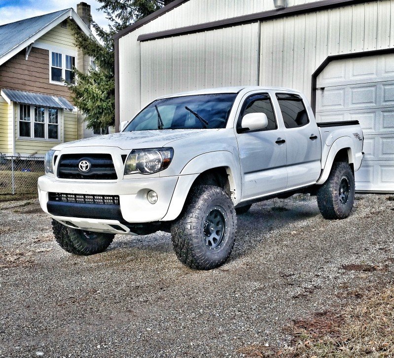

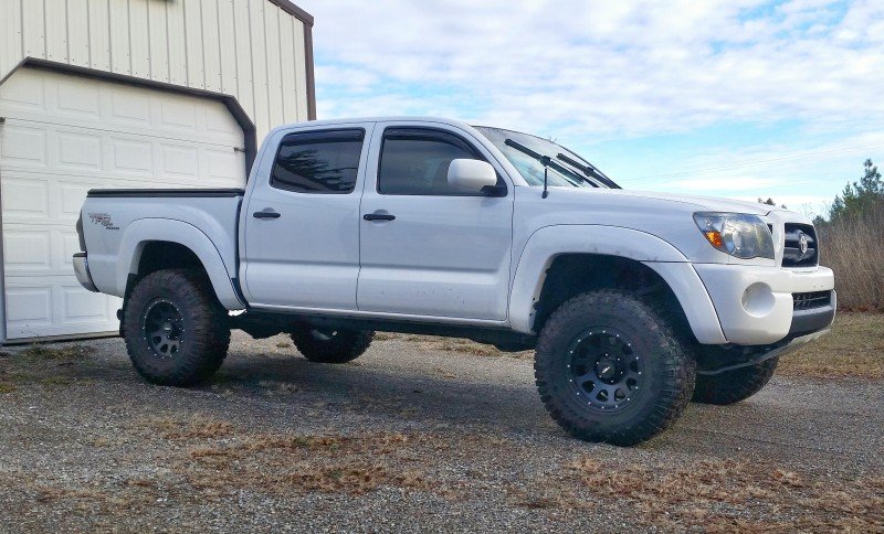

    Haven't measured yet I will in a bit I'll attach a ciuple.pics I'm easily 3 to 3 1/4 higher up front

    May 16, 2013
    #104293
    1,865
    Ty
    CDA Idaho/ Deadhorse Ak
    09 DC SW TRD OR/ 2015 tundra CM off road sr5
    3in lift, 5100s front and rear, OME 887 springs 2in aal, 285 75 16 Duratracs, mb 352 black wheels, white sport grill, derp'd lower valance, derp'd front toyota emblem white, tinted windows, tinted tail lights, trd shorty antenna, trd hitch cover, trd valve stem caps, trd neoprene covers, trd all weather floor mats, kenwood double din, stampede window visors, flyzeye interior leds, anytime fog light mod, flashlight mod, kool vue intake, LED dome light, Lund bug shield, TRD shift knob,front mud flaps removed, Debadged, truxedo roll up bed cover, led fog light bulbs, led parking light bulbs, led dtrls bulbs, led headlight bulbs, led back up light bulbs, led license plate bulbs, tinted license plate covers, 18" magnaflow muffler, 32in ebay, light bar, coverking neoprene resr seat cover, oem trd skid plate, trd decal on center caps, oem trd exhaust tip, blacked out pinch welds, color matched mirror covers.

    I'm 24" up front both sides and 24.5 in the rear
  19. Dec 22, 2014 at 11:06 AM
    #19
    xtyfighterx
    xtyfighterx Master Shredder
    May 16, 2013
    #104293
    1,865
    Ty
    285 75 16 just,trimmed that plastic piece under the front bumper and removed my front flaps I'm running bilstein 5100s set at 0
