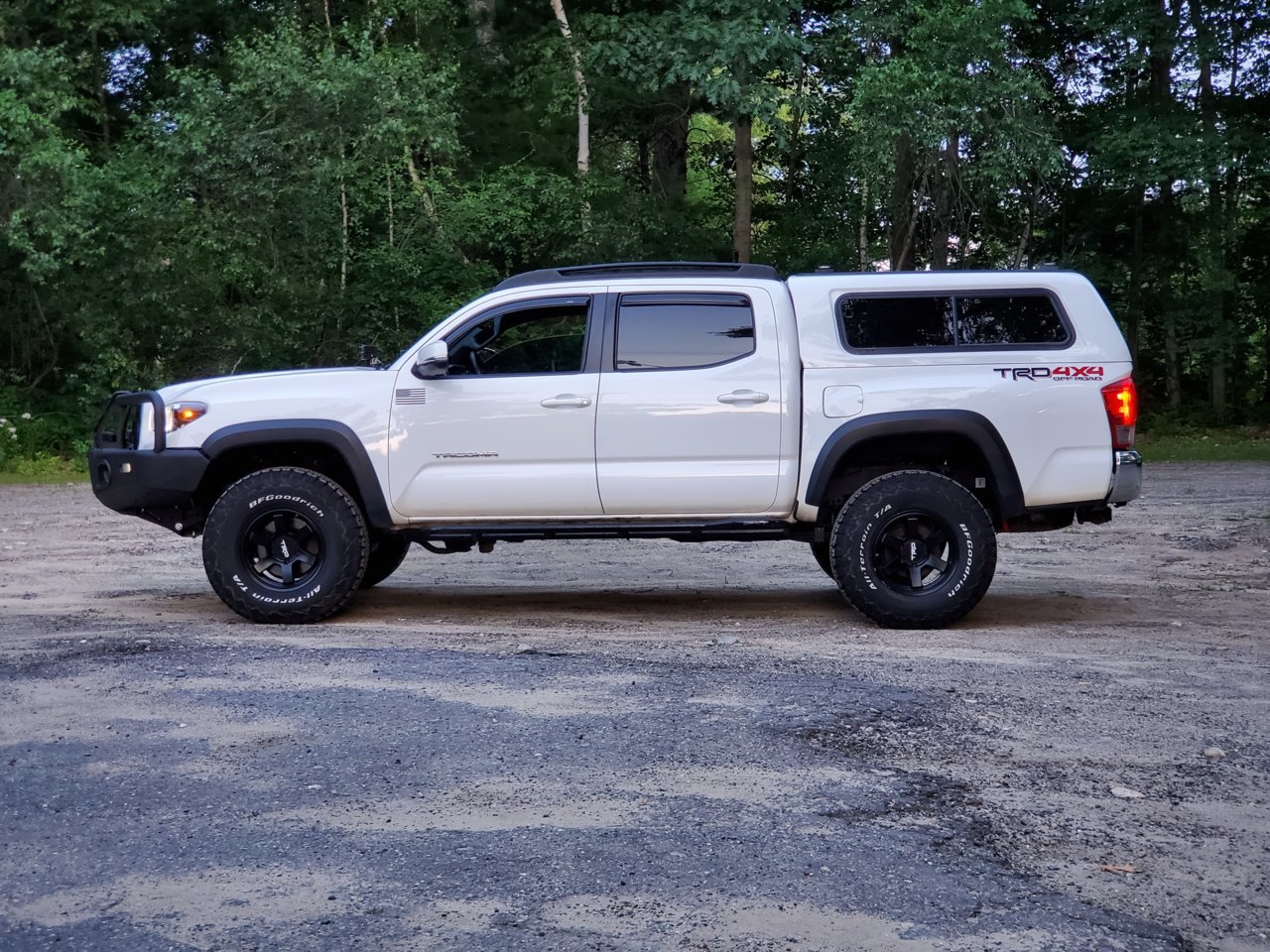

    Bilstein 5100, OME 887 Coils second notch, SPC UCA, Deaver 1.5-2 AAL
    @RedBeard1 how much weight did you have on your truck for the 886 to sag down 0.5 inches or was it half of your total full lift? Can you describe how they rode on and off road? How high of a lift did you get? And one last question was it on a 3rd gen doublecab longbed? Thanks in advanced.
