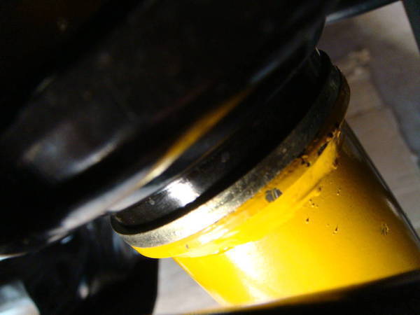

    It sits under the spring perch to give you a little bit extra lift with OME front shocks. generally used on the drive side only to counter the effects of the taco lean.

    it will look like this.

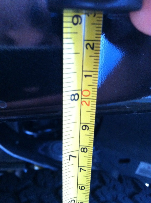

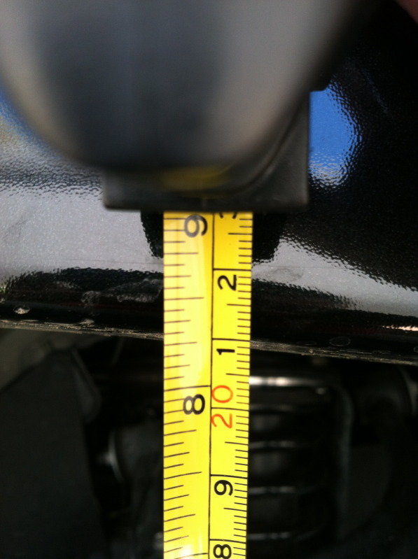

    wanted to bring this back to life for a quick sec :p
    so can anyone input on this would be passenger side..
    and driver side..
  10. Jun 28, 2012 at 12:55 PM
    Bama_TACO
    Bama_TACO ROLL TIDE!!!!!!!
    Aug 3, 2010
    #41157
    1,011
    Winfield, AL
    2006 PreRunner Double Cab TRD SPORT
    So do you currently have the trim packer installed? If not your lean is about normal. My 05 was a about 1 1/4" lower on the driver's side. My 06 was about 1/2" lower.
