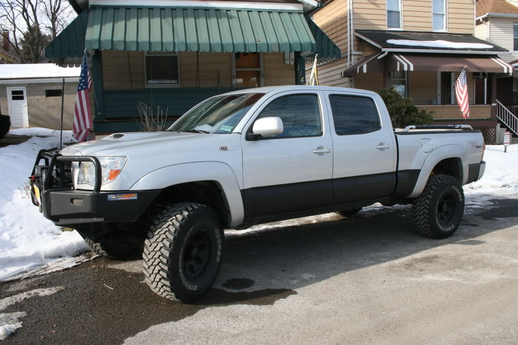

    Here's my truck with OME 885s and 5100s set at 0...with a Toytec 2" AAL in the rear. Rides like a champ! It was a little nose high...its settled since. This pic was taken right after the install.
    EDIT: I don't have the TSB done in the rear
