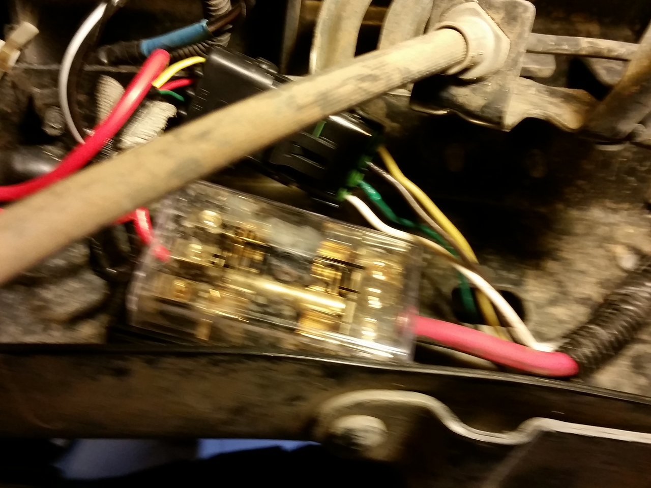

    I ran a four guage wire down the drivers side frame, in a loom of course. I mounted a fuse on the core support so short run from batter to that and the long one down through the frame. I needed a fish tape to get past the fuel tank. Then I mounted a distribution block on the inside of the frame around the spare tire area as I wanted to be able to expand on that power later. From the block I ran a eight guage wire to the compressor. I also ran some 12 by four wires back to the cab for the selenoI'd that come with the kit.
    Had to do this twice as I did not loke the way the first one came out.
    Hope this helps.
    By the way, I got the Mobtown locked bed doors to secure the compressor I also had to get a swiveling hose barb to mount to the compressor to hook the air line into. 20161227_123713.jpg 20170217_114252.jpg

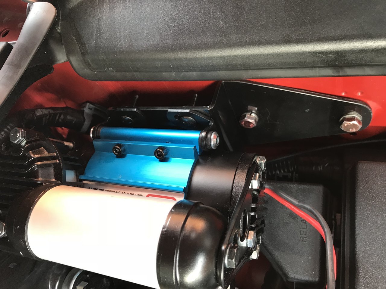

    This is how i mounted my ARB single compressor onder the hood , Just made a simple bracket and used 2 original holes . The plate is Chrome Molly so it have plenty of strength
