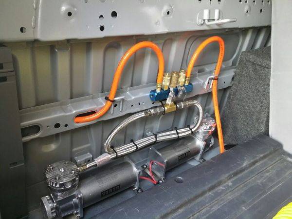

    Have not picked one up just yet but my local shop did have a viair480c that I'm interested in but now my question is do I have to run a tank with it or can I run it strait to my tires when airing up?

    ARB lockers and 4.88s front and rear, OME 886s, Dakars, etc., Safari Snorkel, 17"Fuel Revolvers w/ 35x12.50r17 KM2s, fenders cut 3" all around, Pioneer AVH-P4400BH w/ Backup cam, CB/PA (PA Installed), Weathertech Digis, Foglight anytime, AP: front bumper, skids, and pack rack, custom sliders, Warn 9.5XP, dual VIAIR 480Cs with a 2.5gal tank, OTRATTW switches galore, URD y-pipe, RCI skids, LF 240s, etc.

    Do you have to run a tank. How slow are they? I was hoping a single compressor would fill all my tires from 12 to 35 in ten to fifteen minutes. Am I only going to get those results with CO2

    No you do not need a tank. Yes, they do help with airing up tires a little faster. Only thing comparable to C02 is a belt driven compressor such as a York 210. I'm new to Tacoma's and don't know if that is even a possibility.

    I think you are talking valve core and not stem.
    Also have seen people try with no luck on an ARB and others...
    No work without a storage tank. Then the tank needs to be more the a 1 gal so you take up a lot of room.

    That's a great setup. Do you have pictures of where you mounted your tank? Also where do you plug in your air line?

    Don't have to run one but I don't have a pressure cutoff so I can't run the compressor directly haha. I can take my 35's from 20PSI to 40PSI in about 3-4 min IIRC. They can take my 2.5 gal tank from completely empty to ~175psi in a reasonable amount of time
    Tank is mounted where the spare used to be :cool: I have an air outlet on the front bumper, one in the cab, and I'm going to put one on the back bumper at some point but the air hose I carry is long enough to fill tires on any trailer I have ever pulled
