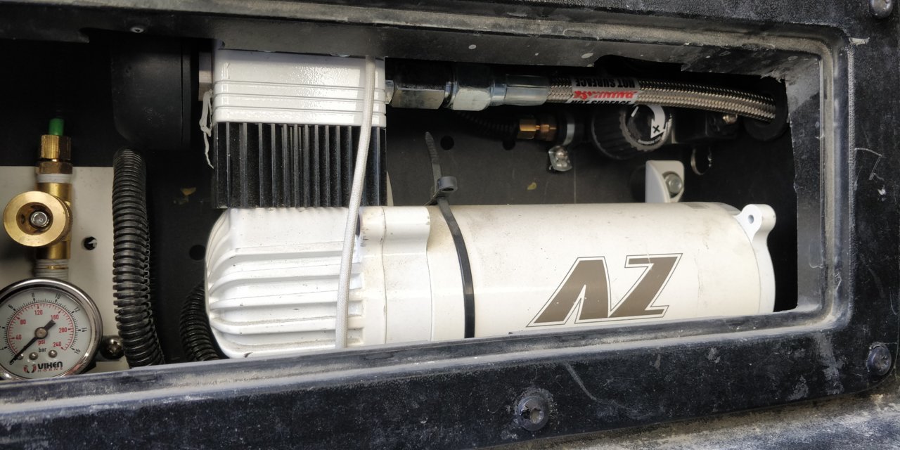

    Finally got this done..
    Air zenith compressor, arb locker.

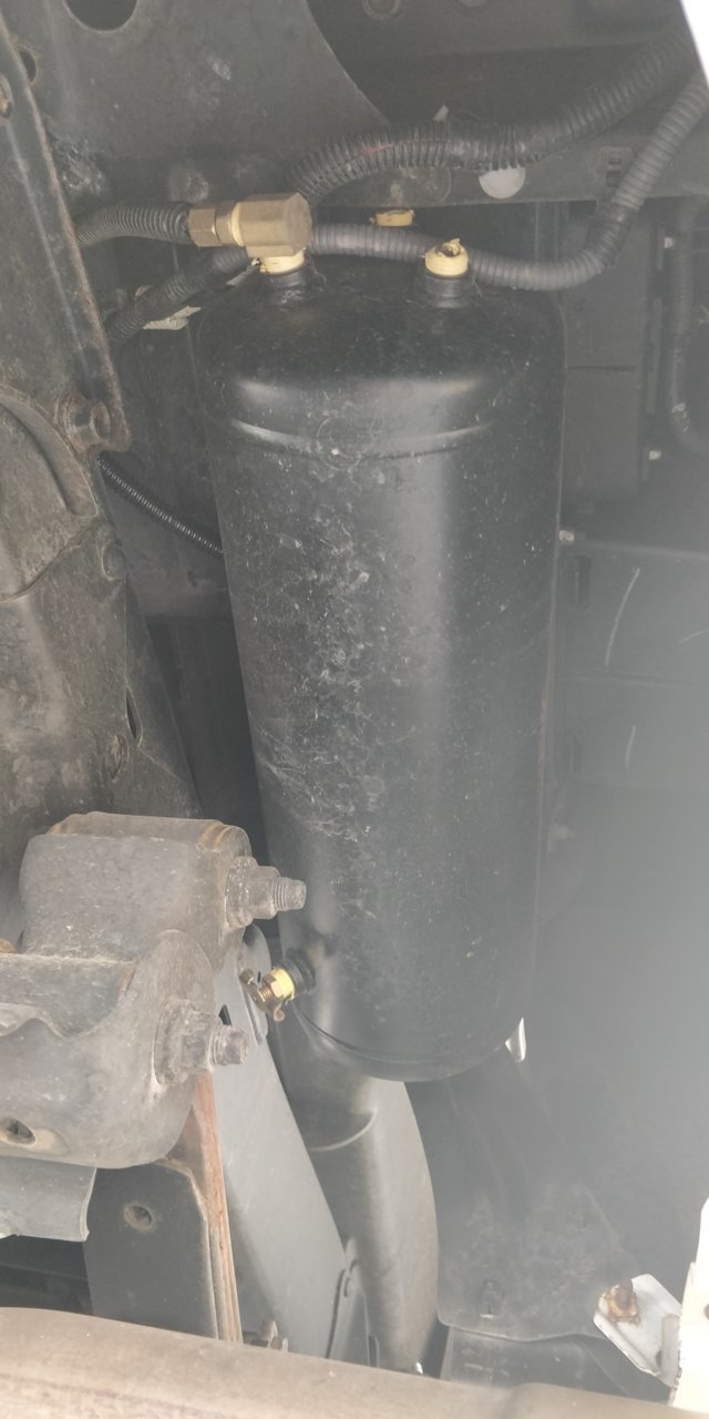

    1.5 gallon air tank mounted under bed,

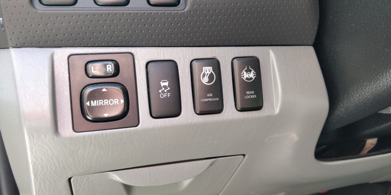

    Air locker and compressor switch are in the cab.
    Compressor shuts off at 150psi, so I have a regulator for the locker to get it down to about 90 psi. ( You can sort of see it in the pic)
    Right now I only have one port for airing tires, located next to the compressor

    That's the tank I bought. Most of the fittings came from home depot, and the 1/4" air line came from my local freightliner dealer, but that stuff is cheap online.
    I think the tank is a no brainier... I bolted mine to the underside of the bed, so far so good. Next project is air bags. I'll post a link to the switches in a bit...

    The ports on the tank were not threaded very well. I had to tap all of them out. I'd plan on the same issue if you go with that tank. 1.5 gallon is a perfect fit for under the bed though.
    I'm still chasing a couple of very small and very annoying leaks...

    Btw, I went with the expedition essentials mounting box, it's awesome, but as they say, make sure you have a second pair of hands!
    If I had it to do over again I'd probably go with the arb twin compressor. The AZ is heavy, I worry about long term durability on the mount because of the fiberglass bed. Also, if anyone does the tank mount like I did (Right rear under the bed) plan accordingly...
    I had to cut a rib off the bottom of the fiberglass bed to make it fit.
    If I had it to do over I'd probably move it slightly closer to the tire and drop it down a bit.
