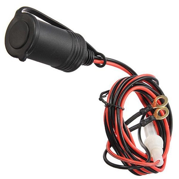

    There isn't a proper power source in the back end of the truck, unfortunately. It would have to be wired either directly from the battery or from one of the ignition sources depending on the amp draw of it. Your best bet is to wire it to the battery with its own fuse. I had a nice Viair cig lighter compressor that drew too much power for most cig lighter outlets so it was constantly blowing fuses.

    So I can just clip the end off and wire directly to the battery with a fuse from an auto parts store? The compressor doesn't have any positive and negative wire markings, so how would I figure out which is which? I'm new with electrical, so I'm sure these questions are a pain to answer.
