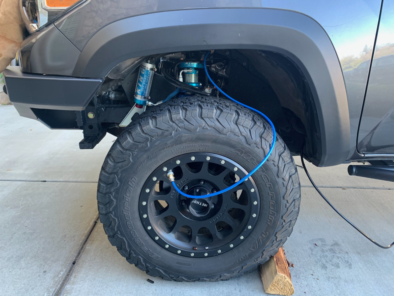

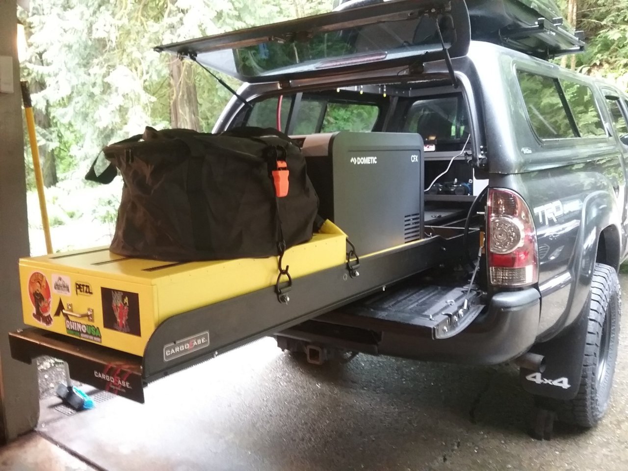

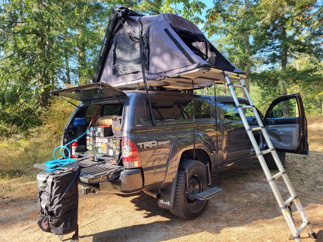

    Guys, I am a retired spray painter nearly 30 years. And have relied on air all my life.
    The ARB TWIN COMPRESSOR is spendy but damn... about a pound of a second.
    IMHO 4 hoses to air up?
    Its beautiful out there. What's the fucking hurry to leave.

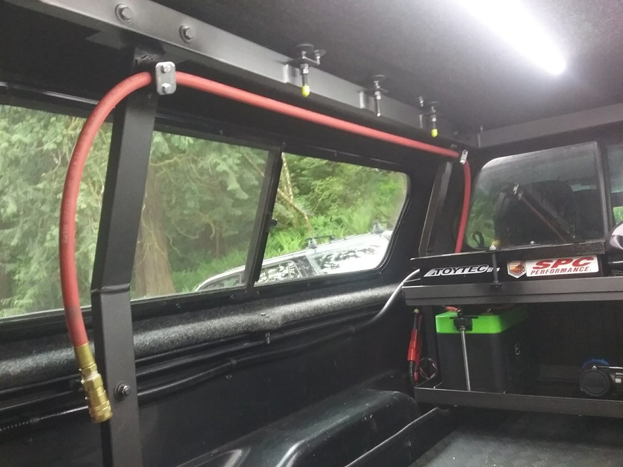

    And guys.... Schedule 40 PVC pipe is rated for 450 psi. I plumb my shop air with it.
    If your application wants to go from bumper to bumper or through a canopy. It's great.

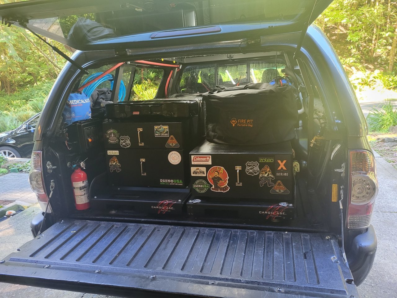

    What box situation do we have going on here?

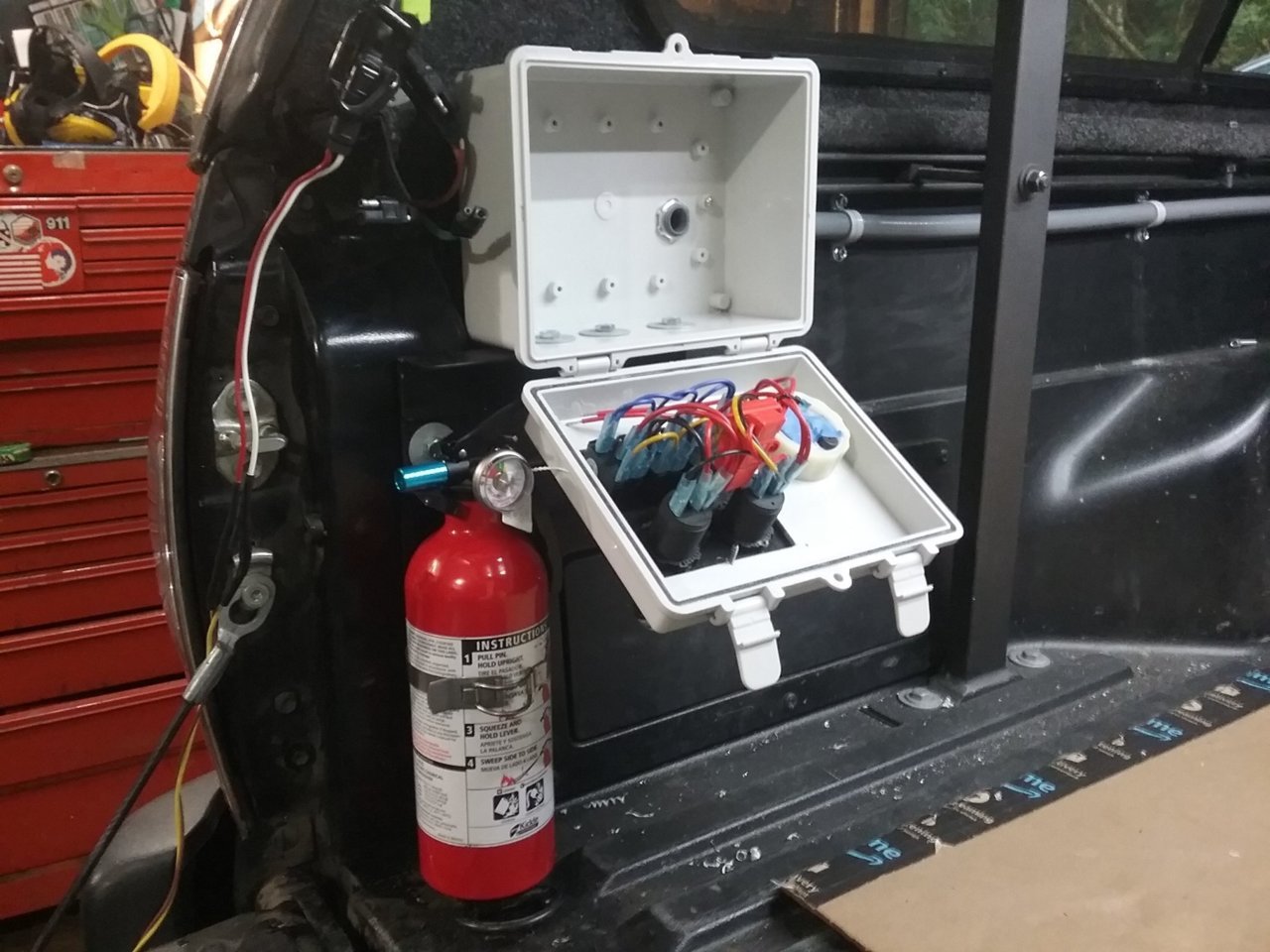

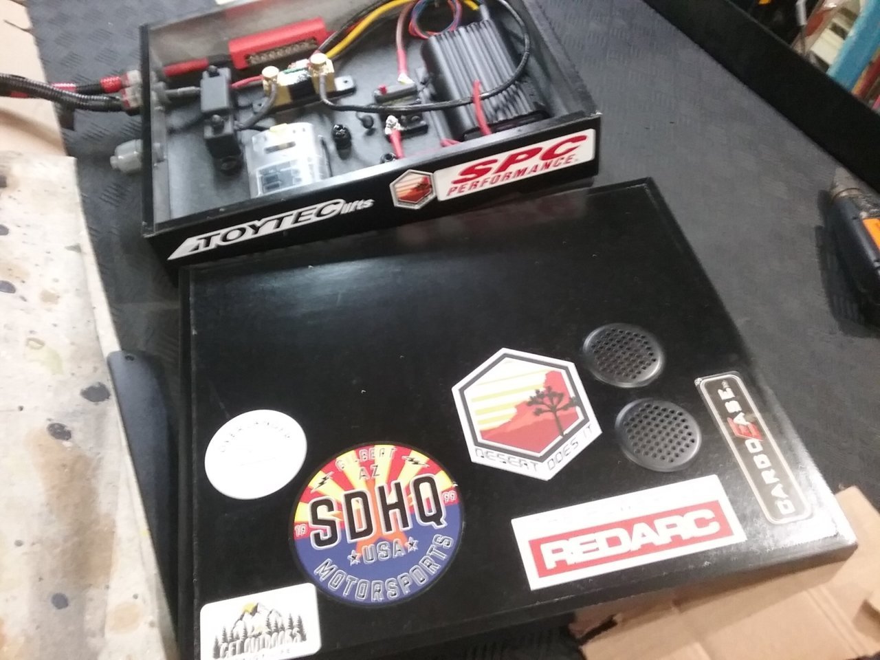

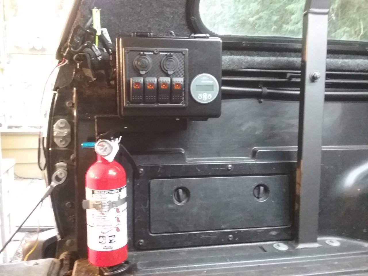

    20220404_085431.jpg 20220407_080523.jpg 20220513_105010.jpg 20220605_121307.jpg Spartan the ARB wire harness can... well... be overwhelming.
    Less the lockers. It's 12v power. And a switch wire.
    If you go the later route msg me can share the 3 wire route. Eazzzy Peezy.

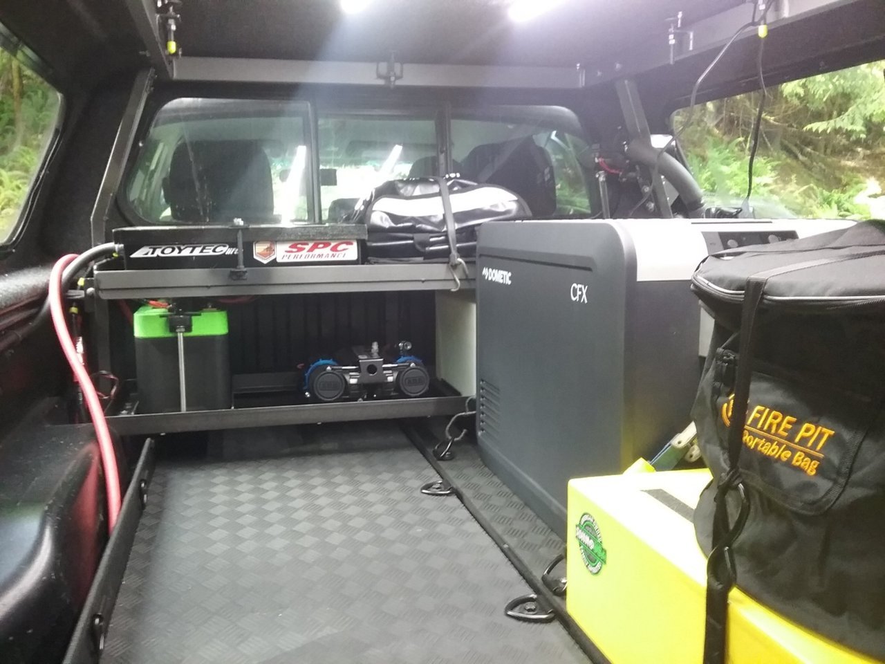

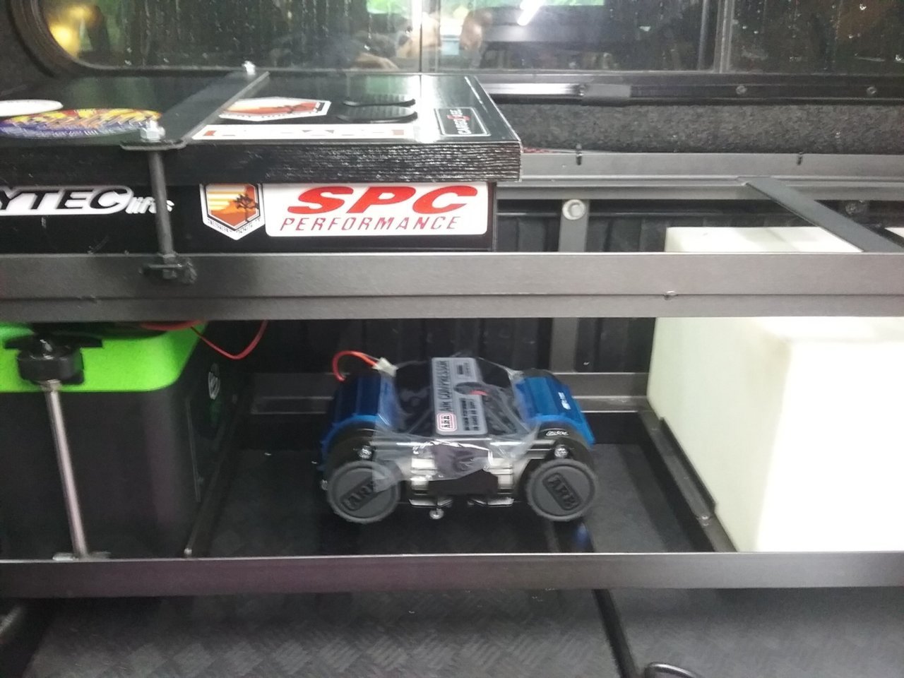

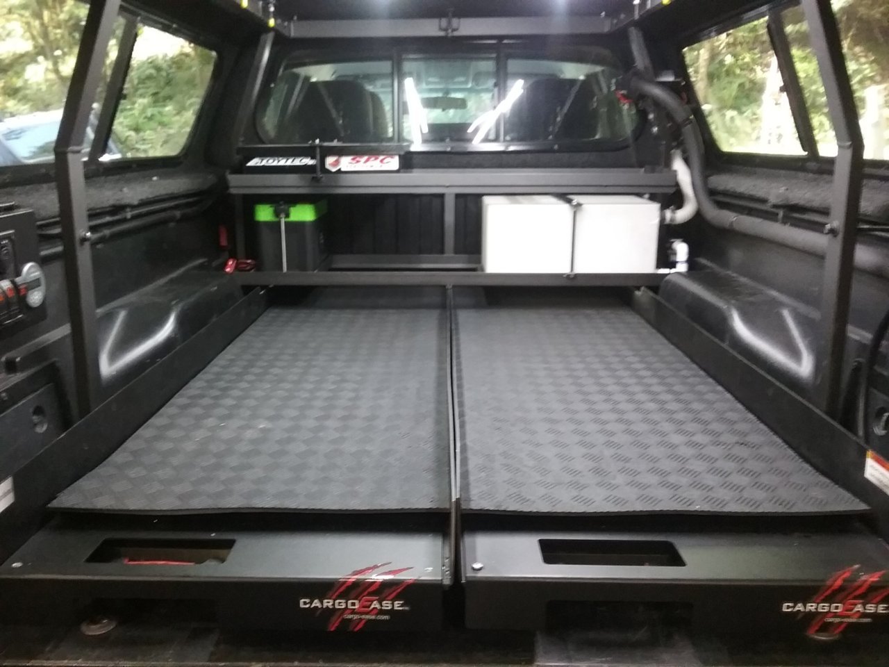

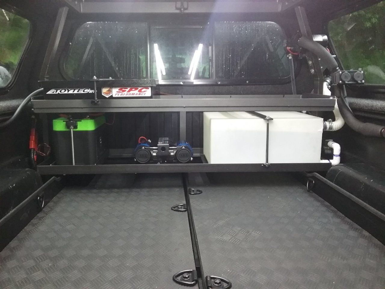

    Bro. It's a rack I fabed to support the static and dynamic loads of the roof top tent and its mounted the the bedside tracks side to side and front bed wall.
    The racks hold an Expion lithium ion battery. 12 gallons of water ( electric pump) THE ARB TWIN and the RedArc Bc-Dc charger

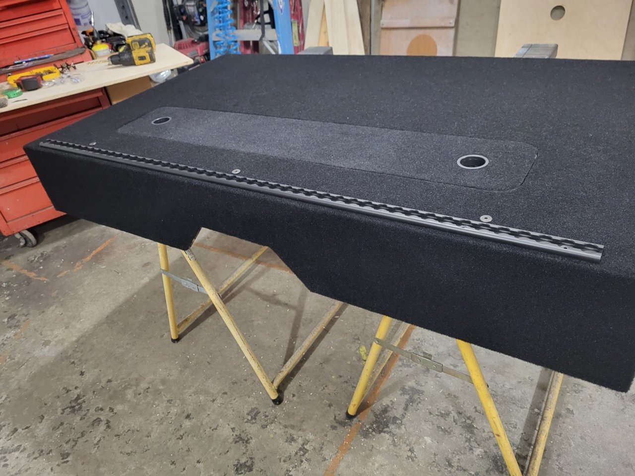

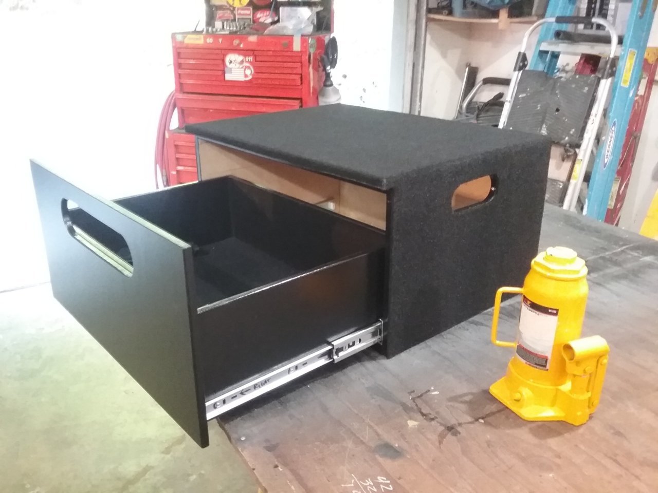

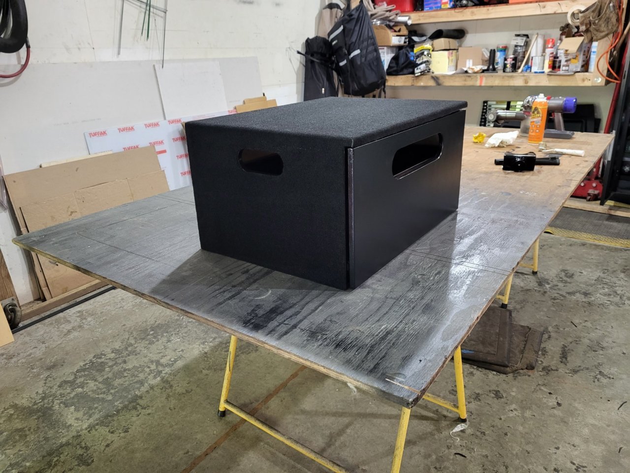

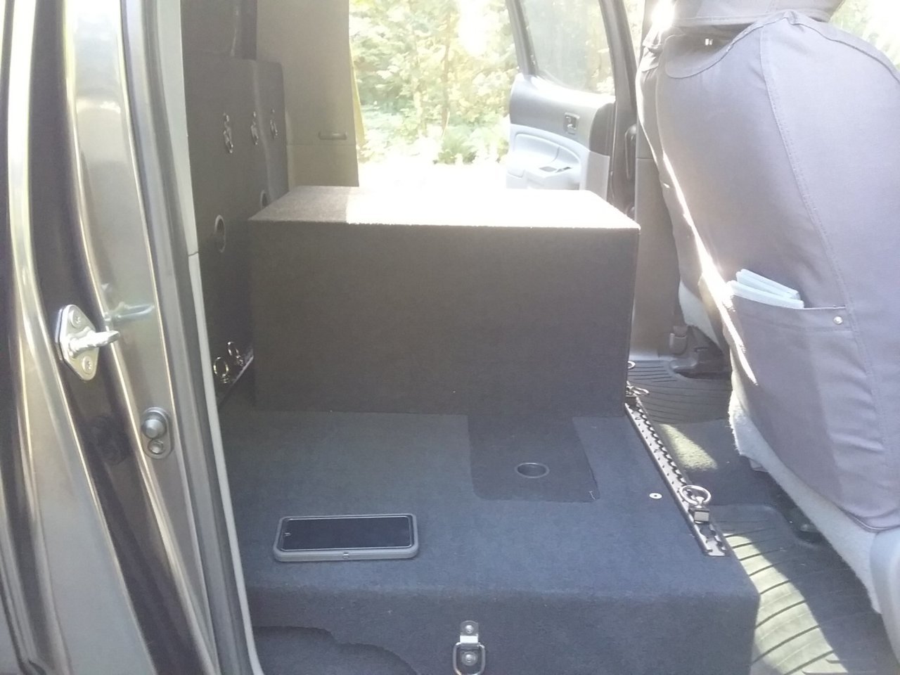

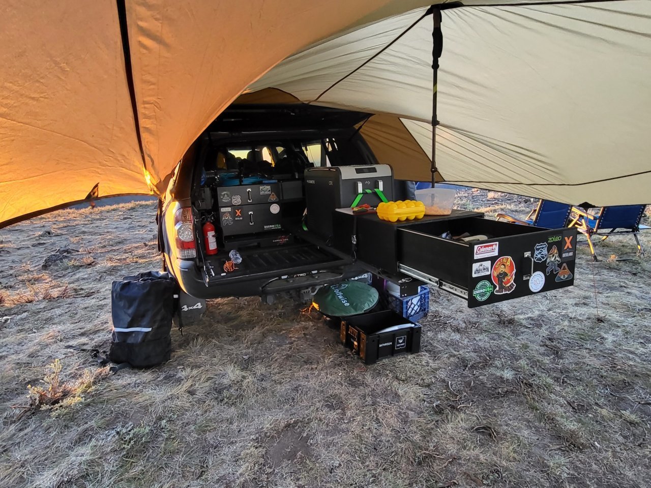

    BKick sorry again new to the TW and responding.... Boxes? My camp drawers?
    Don't want to jump the thread.
    But I can put them anywhere...20220817_061150.jpg 20221011_093148.jpg 20221011_100117.jpg amazon-photos-shared-media488794206.jpg 20221011_095645.jpg

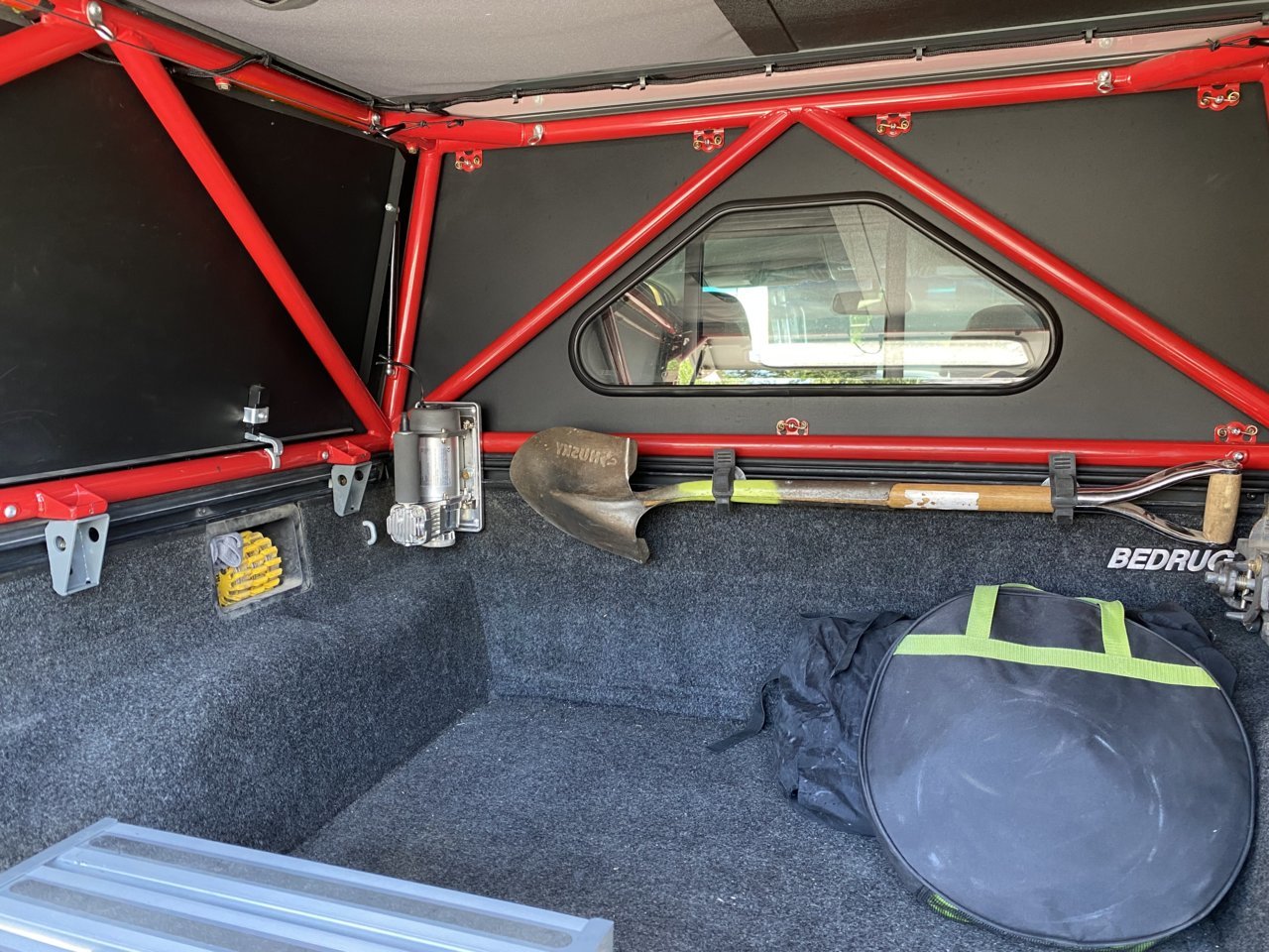

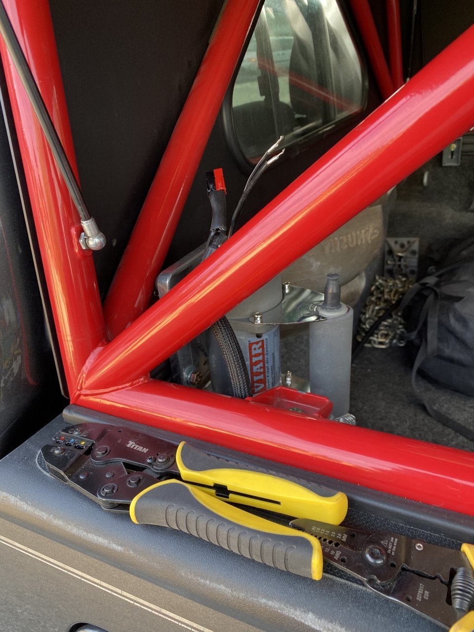

    I recently mounted my portable to the bedrail track and hardwired it...I got tired of digging it out all the time to air up. When this compressor dies I'll pick up an ARB because the Viair gets really hot.
    7985E4FC-F8F7-4C44-AD85-61F6BFE2C21B.jpg 222F659D-0EC8-4A7F-916F-234A00616E78.jpg

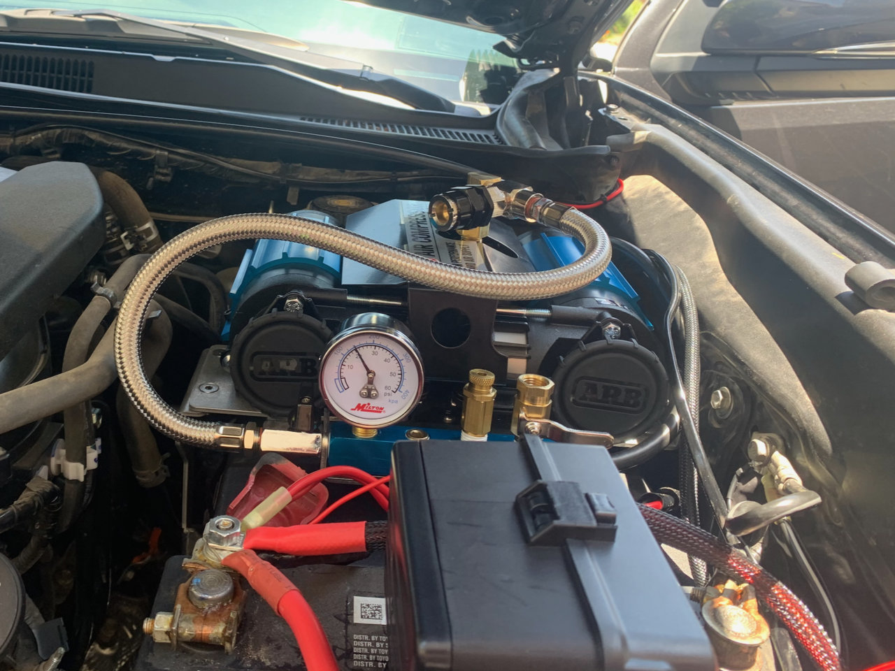

    ARB twin on a custom underhood mount. Plumbed to grill, rear bumper, and inside the bed behind drivers taillight area (above cubby).
    Airline routed from engine bay to the rear via inside the frame.
