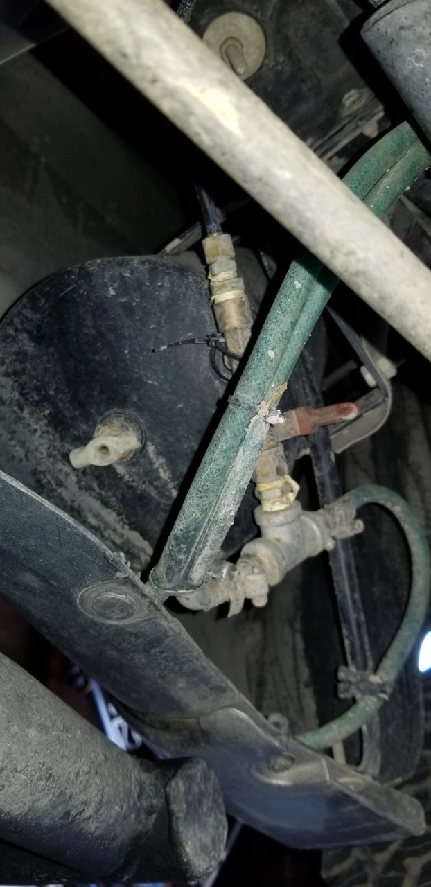

    I stuffed my 2 gal tank in the bedside in front of the rear passenger tire.

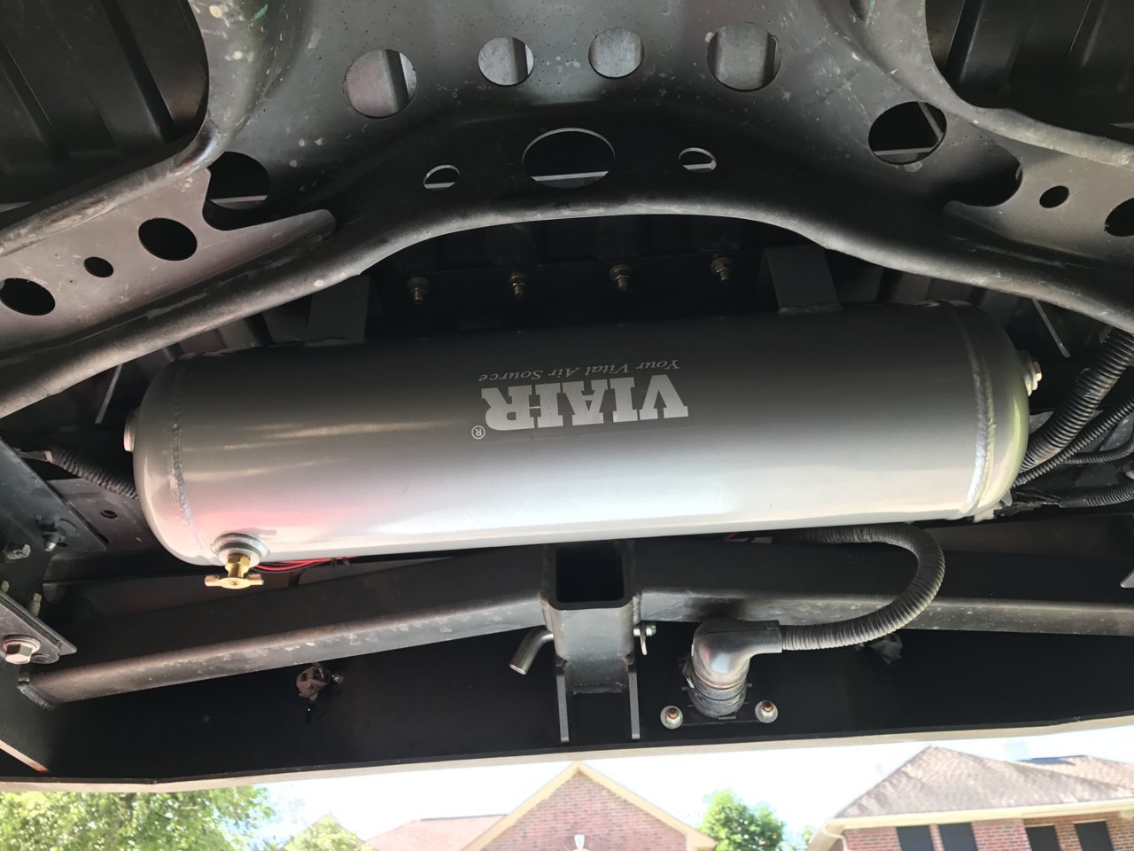

    I put mine behind the rear bumper, since the spare is on a swing out gate now. Should be real exciting if I ever get rear ended while under pressure!

    This was the main reason I went to the trouble of putting it in front of the passenger wheel well. The other locations seem more exposed to rear and corner hits. Aside from that I wanted to counter the taco lean to some extent.

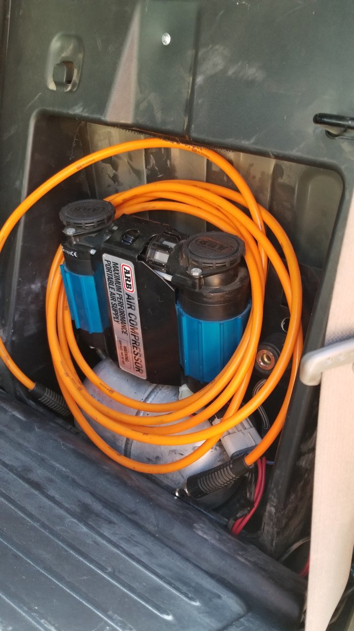

    I really just wanted it away from minor collisions to the rear and rear corners and as far forward on the passenger side as possible. The compressor sits on top on a cludgy diy bracket that hangs everything from the bedwall with an access hole cut out to remove the compressor if need be. Everyone's going to have their own priorities which influence placement as well as constraints imposed by the equipment.

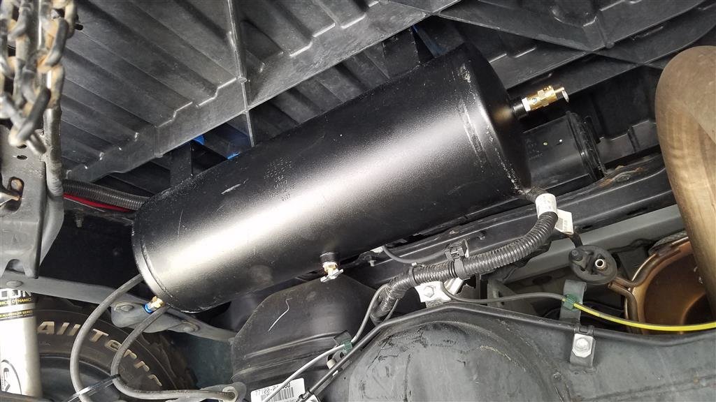

    Have mine behind the rear passenger fender. Fits nicely and its a 2 1/2 tank. Keep it at 140ish psi.20180924_124808.jpg 20180924_124818.jpg 20180924_124808.jpg 20180924_124818.jpg

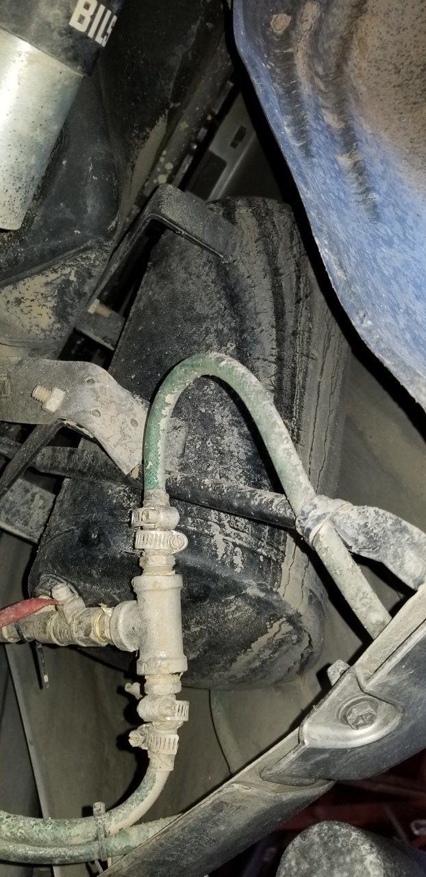

    No modifications. Fits perfectly and homemade mounts
