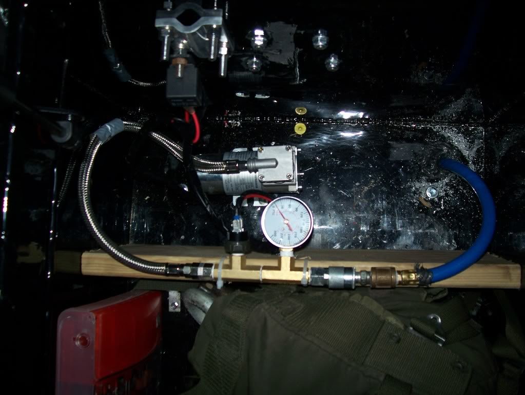

    I am in the middle of getting everything ready for a cheap oba set up, plan on installing this weekend, I have the MV 50, But I do have one question, any of you guys have good ideas on were to mount the compressor? I am thinking of an external tank as well.

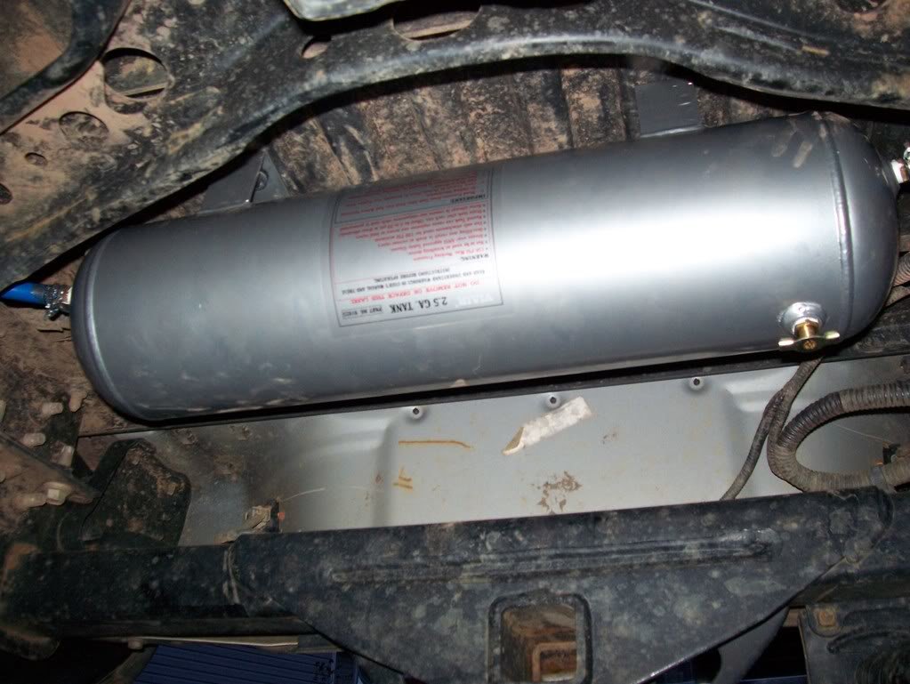

    I have mine in my tool box. Alot of people mount them under the hood also, I have a 2.5 tank under the bed with the outlet run up the the storge boxs on the side of the bed.

    nice setup Silver. plan on getting a 450c setup in the near future. i noticed you picked the spot in the back to mount the tank...can it be put up towards the front of the bed? i would rather have it towards the cab, to keep it out of rear wheel spray.

    Check your suspension compression /setup etc.
    Just throwing this at ya.... I had a similar sized tank (so it appears anyway) mounted above my axle on my jeep. Went to Tellico, broke a shock mount.... and my rear suspension compressed farther than normal and the diff hit the tank and the tank bent the floor upwards pretty good.
    Needless to say - I ended up putting a longer & shorter tank in the same location.
