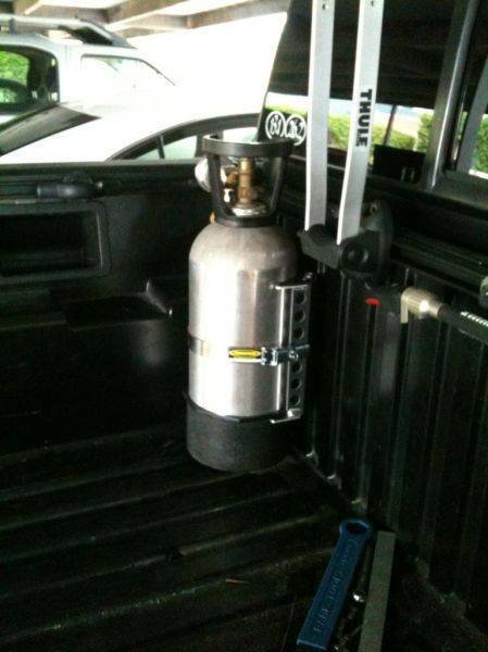

    I took out the right rear and left rear tie down hooks, and mounted a tank holder on each side. I wrap a 25' air hose around the tank.
    Two 25# tanks has been plenty, my group airs down to around 8-10psi in the snow. Refills are about $15 with a wholesale account.
    This set up has worked well and is easy to take out when I dont need it.
    The picture isn't my truck but a similar setup.

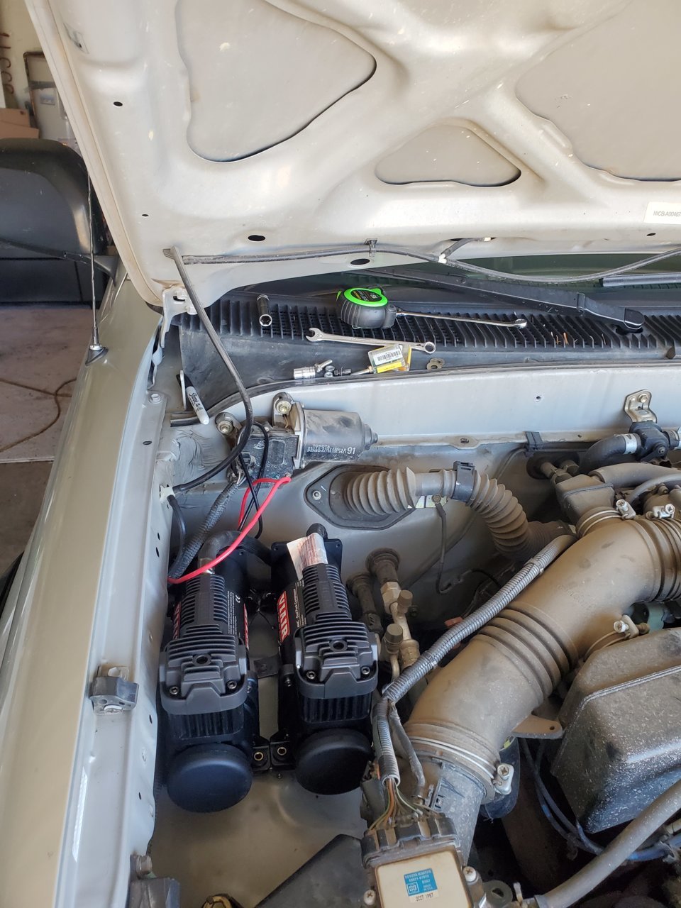

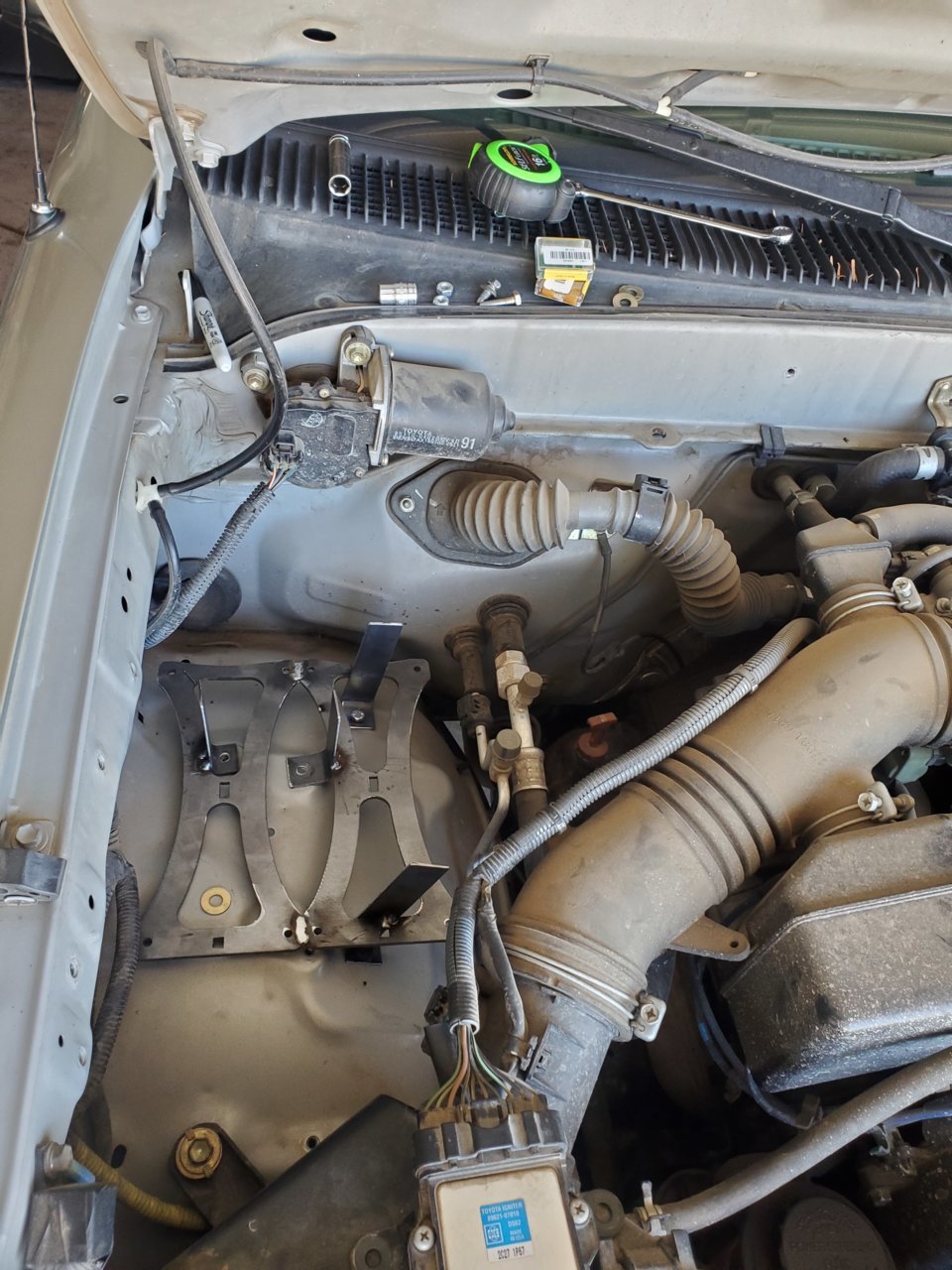

    I have dual viair 444's with 3 gal tank in the bed. This is how I mounted the air comps and solenoids.
    The air comps are regulated to 120psi via a pressure sensor wired up to a solenoid that will cut the air comps in/out.

    Nice setup right there !! That's sweet ! Just curious , did you have to go with an alternator upgrade to run those two , or is the Yellow Top Optima good enough ??

    I have no problem with just the optima. You’ll be fine even with a regular lead battery. I just make sure to have the engine running when in use.

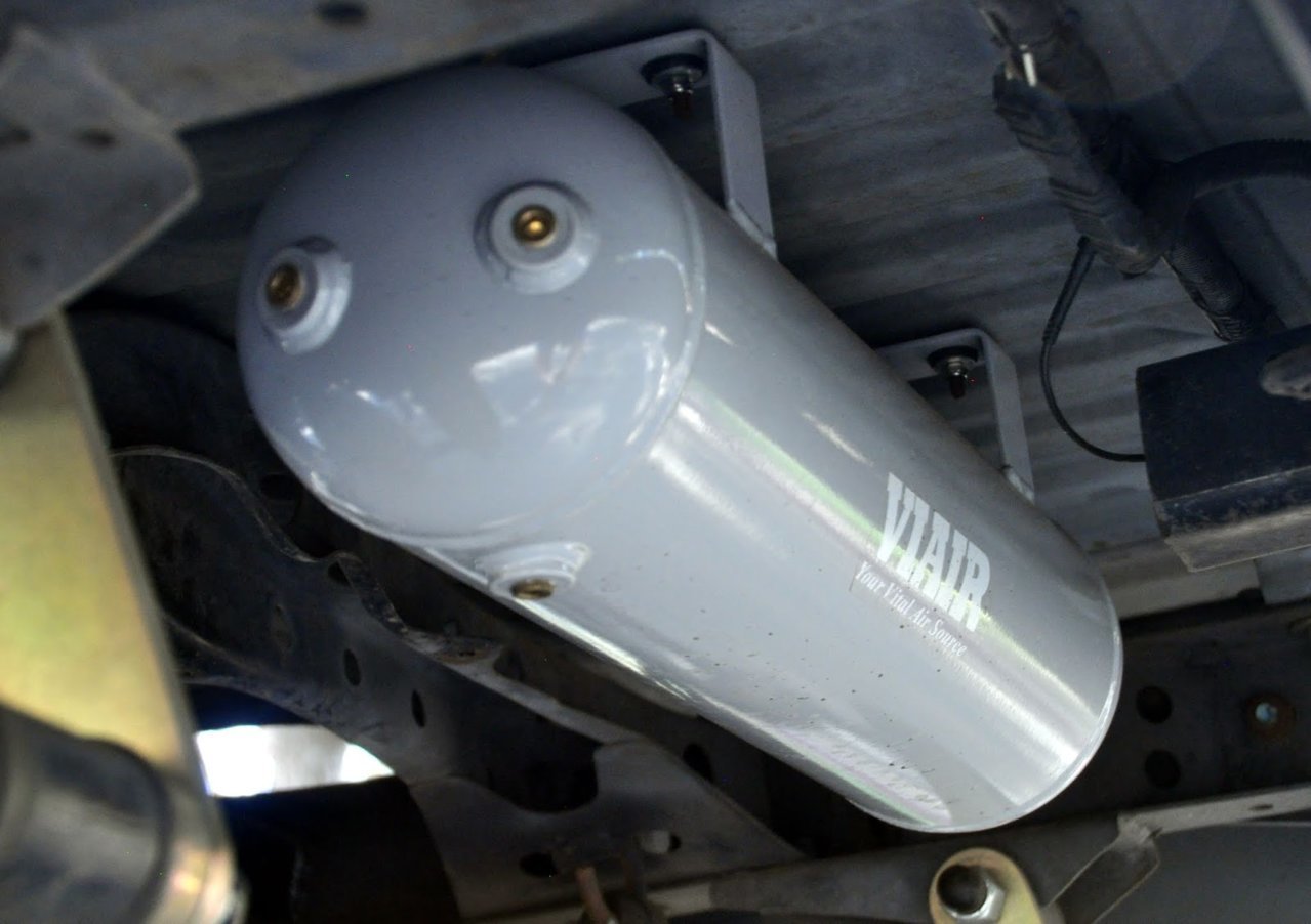

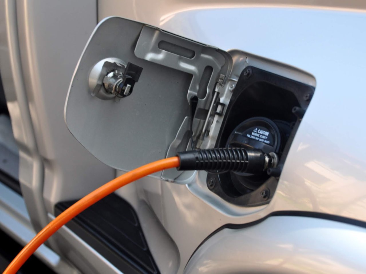

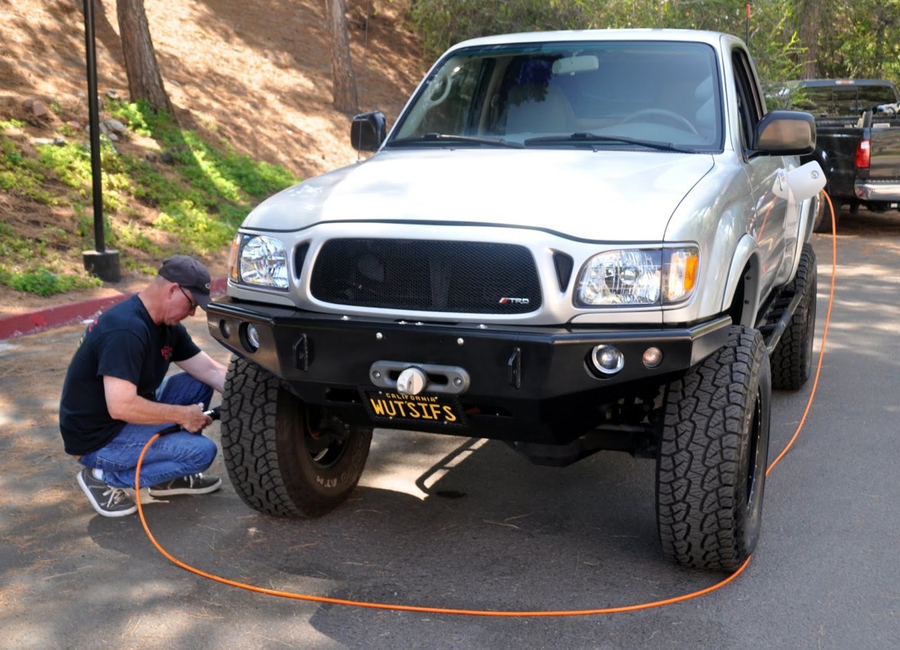

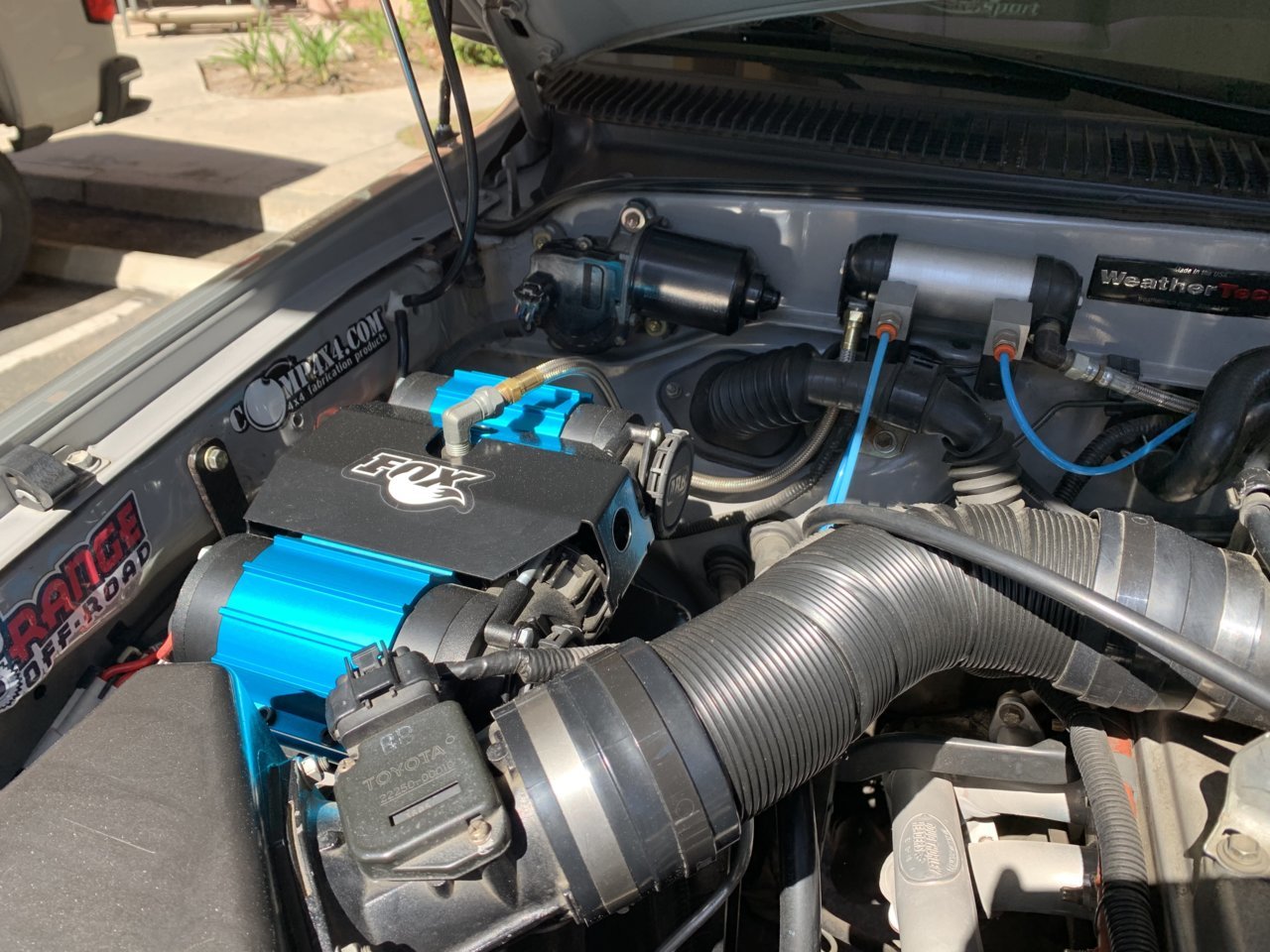

    I went this route since I have ARB lockers F&R. Both sliders hold air and I added a 2.5 gallon Viair tank where the spare tire used to hang out. I put the air chuck behind the fuel door. The supplied ARB air line reaches to all 4 tires.
