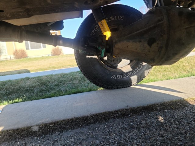

    What kind of vib are you referring to? Vib at certain speed? Vib at all speed?
    1 piece drive shaft will be worst and not many DL shop will recommend such a long unit. The purpose of a CSB is to help absorb vibration. Have you try greasing all the uj?

    If you disassembled the driveshaft, you might not have put it back exactly how it was. Replace the u-joints, get it balanced, and put a new carrier bearing in it. If that doesn’t work, try a drop bearing.
    all of that before a on-piece. There should be no need for a one piece at 3” of lift

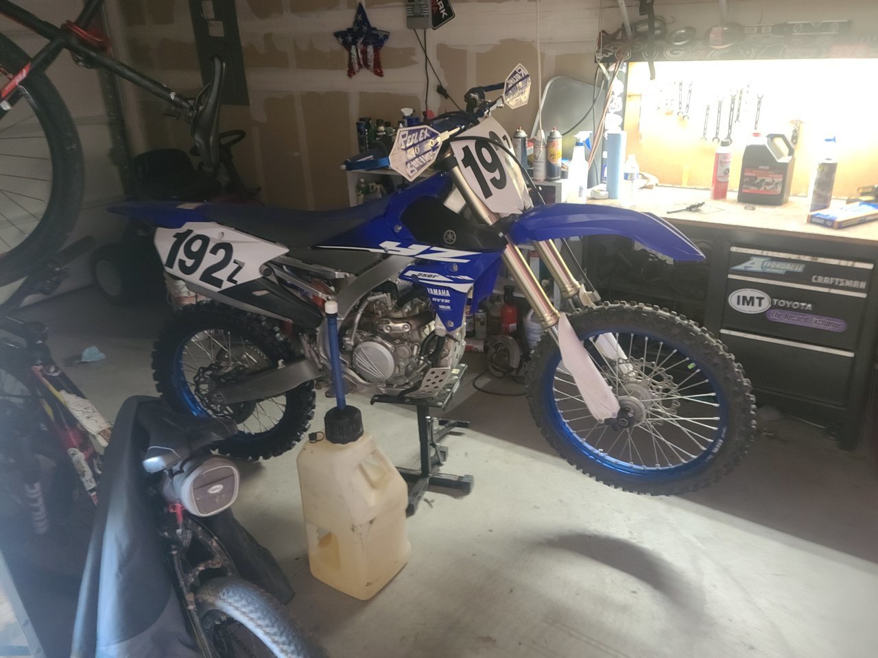

    You just got caught up in some inside jokes some of the boys have. We tend to get a little ornery and sarcastic sometimes.
    But yes I ride, but I ride a man's bike. :devil:
    I've actually got very little seat time on this. I hurt myself pretty bad soon after I got it. Been riding trails for 15+ years tho.
