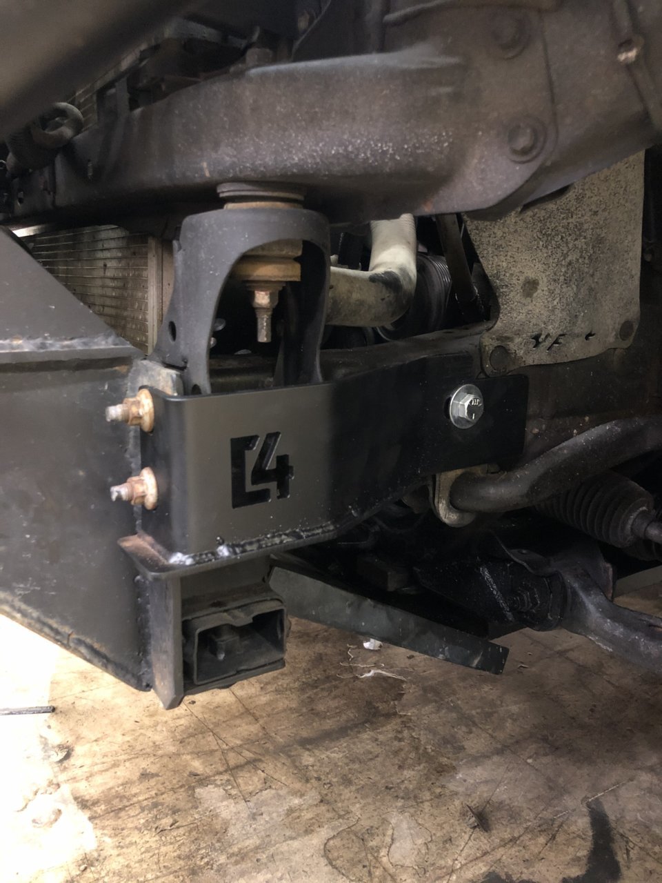

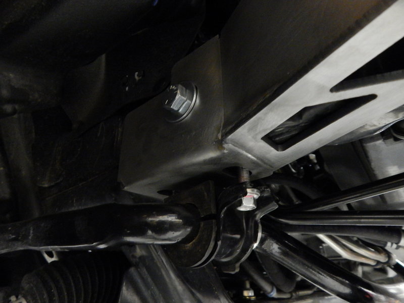

    @tgelata Is that rear bolt into a factory mount or did you just drill a hole? Thought I'd ask before I went out to the garage... Finishing my latte first :anonymous:

    Factory hole, had plugs in both sides of the frame. Ties in with the sway bar mount too

    Straight from c4 had to email them for shipping instructions because their website wont let you ship to canada

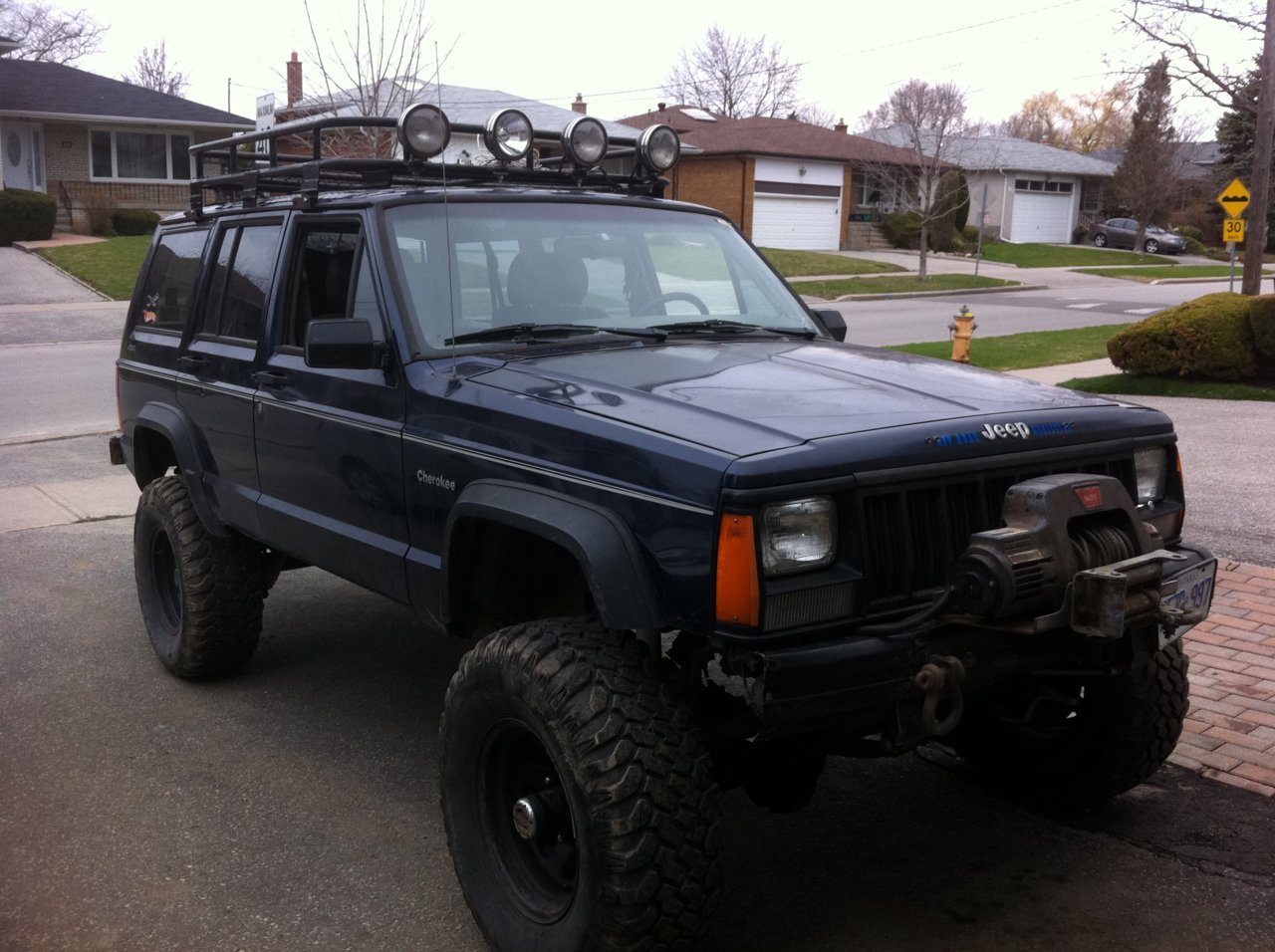

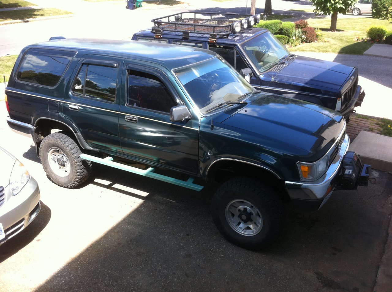

    as you can see the winch and cradle will stick out a bit but you already know this.
    when that was moved to the rear it did not fit. I think its a good idea..

    again i know its not a tacoma but its an idea of what it might look like
    this was my xj i built
    Sloweburn, llamasmurf and Shveet like this.

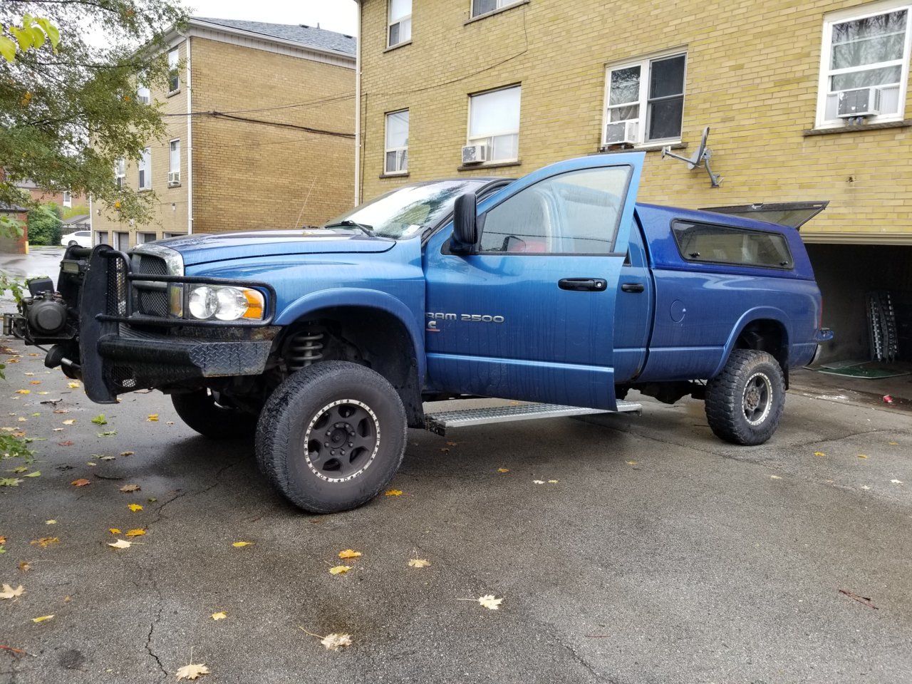

    I also did the same thing to my runner

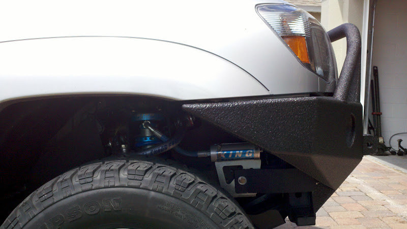

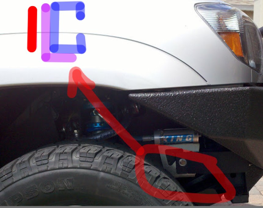

    Looking at the BAMF ones and the C4 reinforcement plates again,
    The C4 plate uses one of the sway bar mounting holes. Do you run front suspension with an external reservoir or no? Others seem to have issues with both fox and king mounts not being compatible
    Seems like the BAMF ones would ignore that issue, so i see why Daks would prefer BAMF over C4.

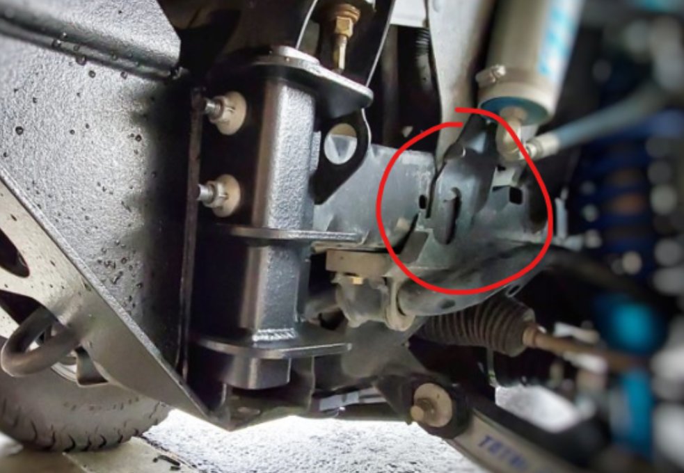

    This is a relentless mount which is sinliar to the c4. Doesn’t wrap underneath but can definetely make it work

    i couldn't find if Rfab is still selling their bracket or not...
    red = relent fab bracket
    Purple = king bracket
    blue = frame
    the difference between the relent fab and the c4 one is that c4 bracket DOES wrap under/ around like the king bracket does in the photo you sent, meaning the holes won't align or some other fun stuff would need to happen. probably just cut the wrap around but off of the king mount and weld the thing directly to the c4 mount

    Could definitely make it work.

    C4 mount it is then

    Im on 5100’s for now. So no resi for me.
    I havent decided what in going to do with the front end yet.
    could easily just weld the resi mount to the c4 brace or modify it to bolt onto it.
    Welcome to the great game of modifying things. Once you hit a certain point Instructions go out the window and you just modify the puzzle pieces however you want till they fit lol

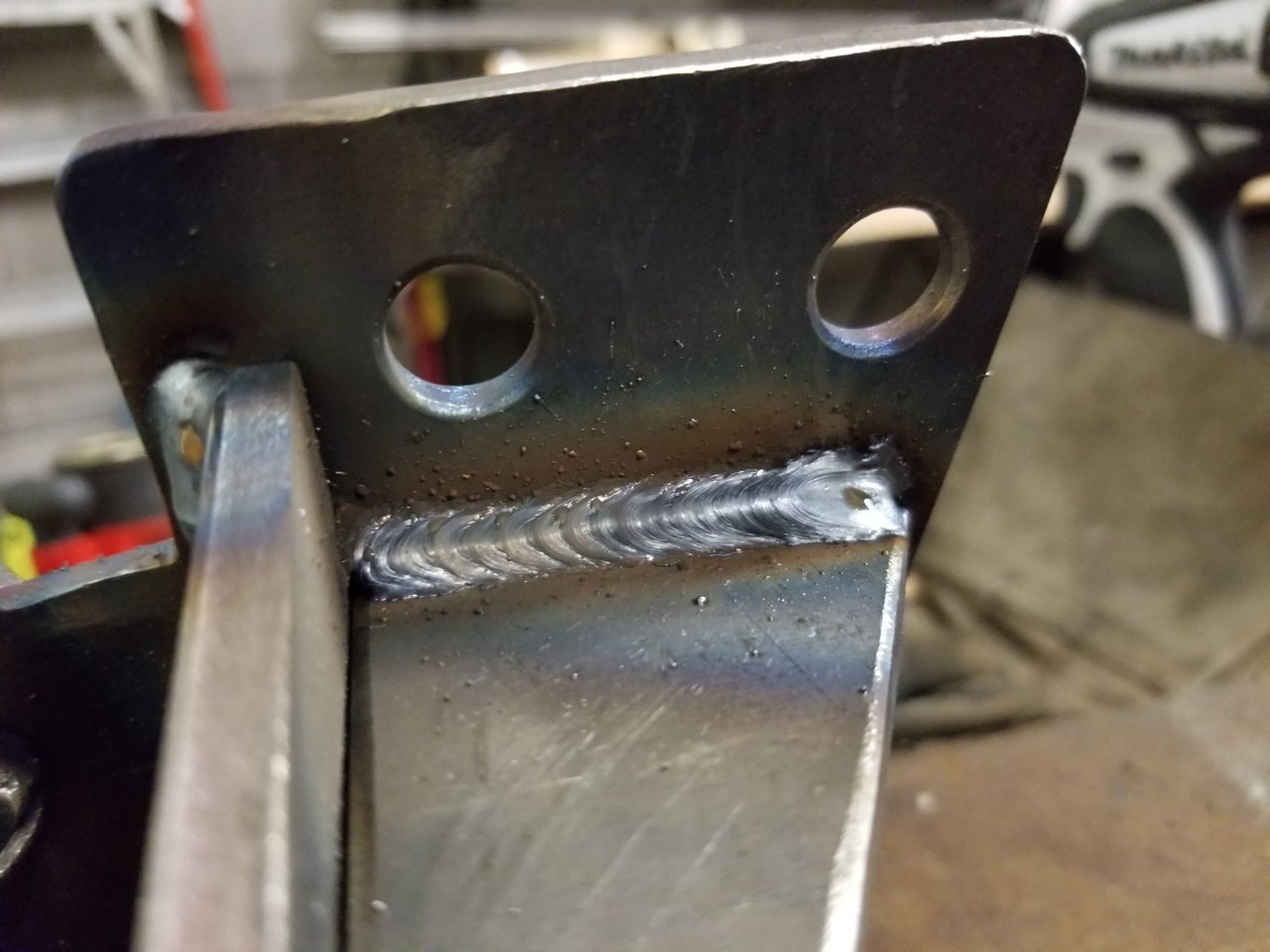

    Got my winch hooked up yesterday. Going to weld up the bumper attachments tonight, so I don't pull the bumper off the truck with the now functional winch.
