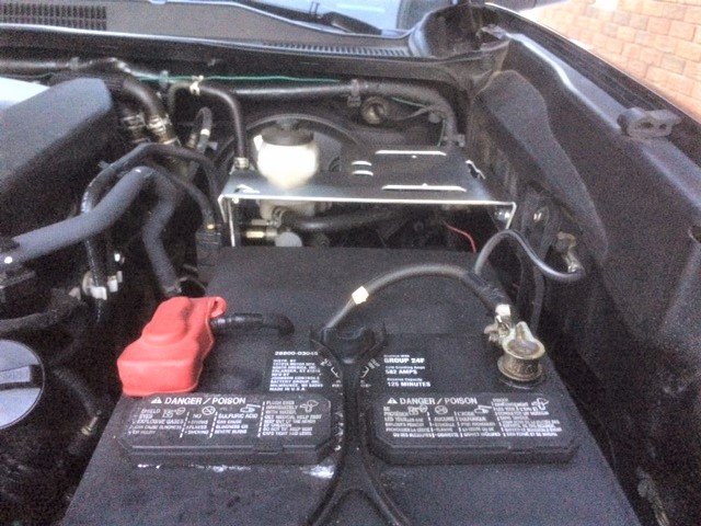

    today i learned where our breathers plumbs to!
    Looking at the shop images, i noticed the support bar for the left side but couldnt for the life of me figure out where it would connect to, you solved that question of mine.
    I have an old computer case which has a large enough side panel that i could cut out the template from, though pretty sure it's steel. I know i have a stainless panel somewhere but it's always in the last place i left it. :notsure:
    Realistically however, it's not a hard project to do. a single pass on the band saw, place all your parts down with 2ways tape, center punch the mounting brackets, 1/4-20 screws and the rivnut gun (i have 70 of these things so i might as well use em some way, like stand-offs), and a few good wacks in a vise and the bends will be useable.

    Steel is fine, you'd be painting it anyways and it's so small so weight is not an issue.
    Just has to be thick enough to not collapse under a tiny bit of weight.
    It's the brace and the two bolts to the fenderwell that do all the work of it not shaking to bits.
    No different than building a motherboard tray... (well less holes).
    Don't even have to mount them both in the same spot...
    K we've seen what you can do with a couple of bolts and a breadbasket... :woot:
    Lets see what you can do with a fuseblock and an old PC case... :sawzall:

    There's a cheaper tray sold here but it's smaller: http://triggercontroller.com/product/trigger-toyota-tacoma-bracket/
    Fortunately you don't drive an MT, or that location would've been taken up by the clutch reservoir.

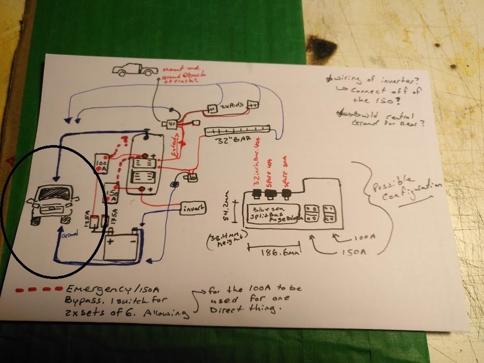

    i said to hell with it and i'm building my system to be able to upgrade to a dual battery with the only thing needing is the passenger side battery mount and a battery and a single wire going from that battery towards the fusebox i'm piecing together.
    this is the current wiring schematic i came up with 3am, because i've lost control of my life and don't know what to do.
    Blue lines are the negative/ ground
    red are positive/ live

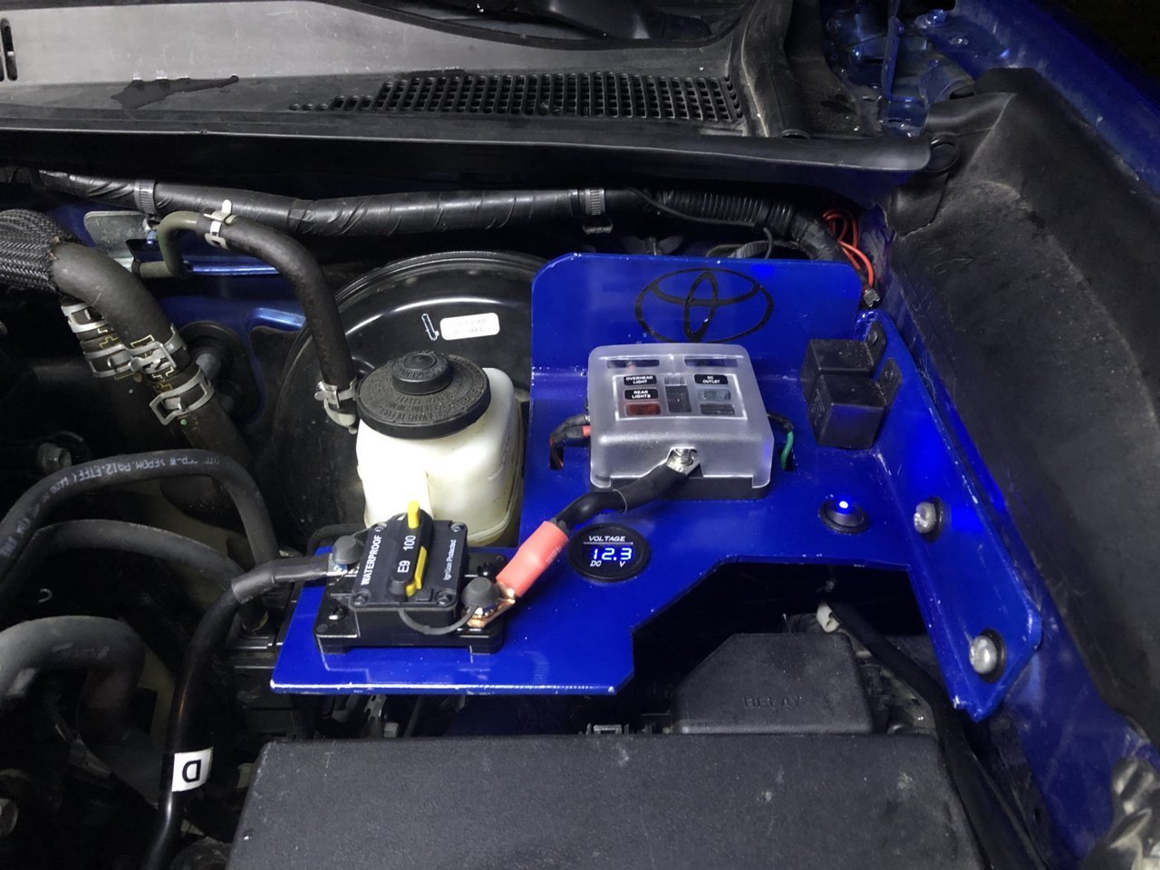

    Check out Sean’s @Canadianguy91 . Few pieces of aluminum and you can make one.

    The idea is that;
    2x Terminal fuse amps as redundant safeties, 1 for each circuit breaker to protect the battery at the source.
    2x circuit breakers, for 2 groupings on the fuse panel, protecting the battery and isolating the rest of my system. allowing me to have them as master switches.
    1 fuse panel that are split in 2 groups of 6 fuses. for cleaner setup and allowing me to isolate 100 amp systems and 150 amp. Though the Blue Sea fuse box can only take on 100A at most per grouping, the 150 would also be bypassing the fusebox entirely to supply power to a inverter within the cab. this way i have 2 master switches that can kill power to non essential stuff but leave other stuff running to help isolate electrical issues. Like allowing me to keep the fridge running but kill off any power sapping from the light bars/ work lights.
    The 150A can also act as a backup that if i need the 100A breaker, or if it gives out, to do 1 thing entirely, like run a fridge because issues or something. The 150A can take on the power grid of both fuse groups, and will be under the 200A max on the fuse panel but if it does pull too much power, the breaker flips if the load is too much but none of the fuses pop.

    that panel is 1/4” aluminum and hammered to make the bends in a vice FYI. image.jpg

    4,202
    Farook
    Toronto Ontario Canada
    '14 Acess Cab
    If a Ford Ranger had a baby with a Tacoma...
    I like it.

    #254719
    6,419
    Own-tario
    2018 shitbox
    situations like this usually lead to custom pieces anyways. you guys are making out that the panel needs to be an overly engineered :rofl:
    It's 2 folds at most on a scrap piece of metal that has an approximate cut out of something.
    I have a general template on hand for layouts and bolt holes. But again, very primitive as it's cardboard
    The 100A breaker goes to the A terminal
    the 150A breaker will go to the B terminal, A if it needs to in the future

    If a computer had a baby with a fuse box:thumbsup:
    I like it too..
    stop giving me ideas.

    Oh that looks nice!
    I dunno, an idea maybe, rotate the 100 and 150 breakers 90deg clockwise.
    That way the heavy gauge feed wires from the battery don't go over your existing fuse panel cover so it's easier to take off...
    and then it's a straighter runs from your breakers to your fuseblocks...
