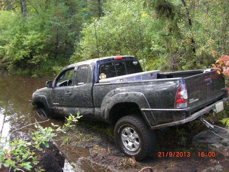

    I had to replace my starter within a month of swamping my old truck at Ardbeg. A year later, had to replace the alternator too... The headlights were totally under water, this pic was taken after moving the truck back:
