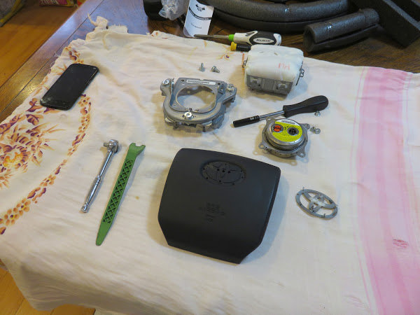

    :lalala: But I did confirm the detonator does't have any Takata branding on it.

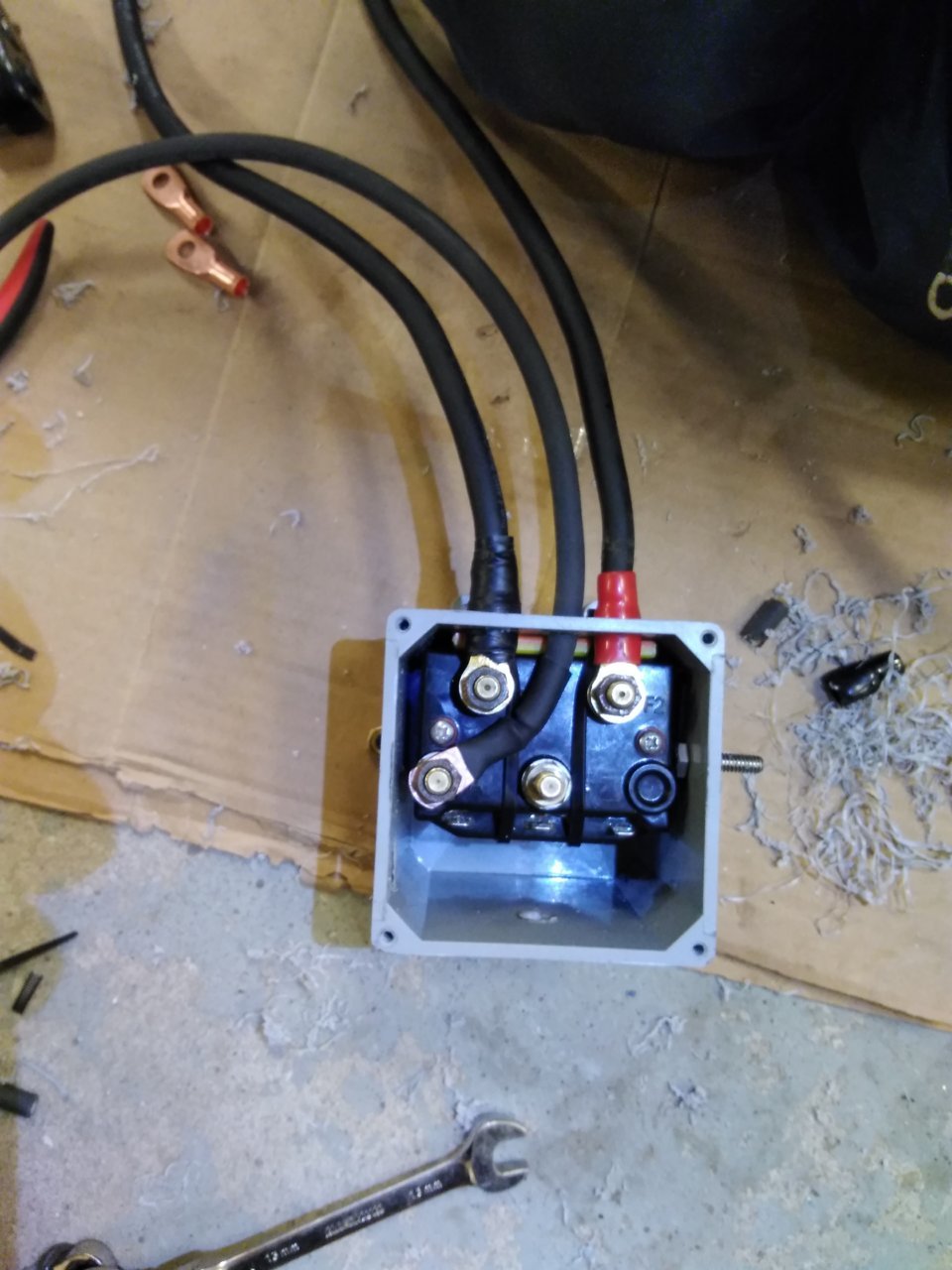

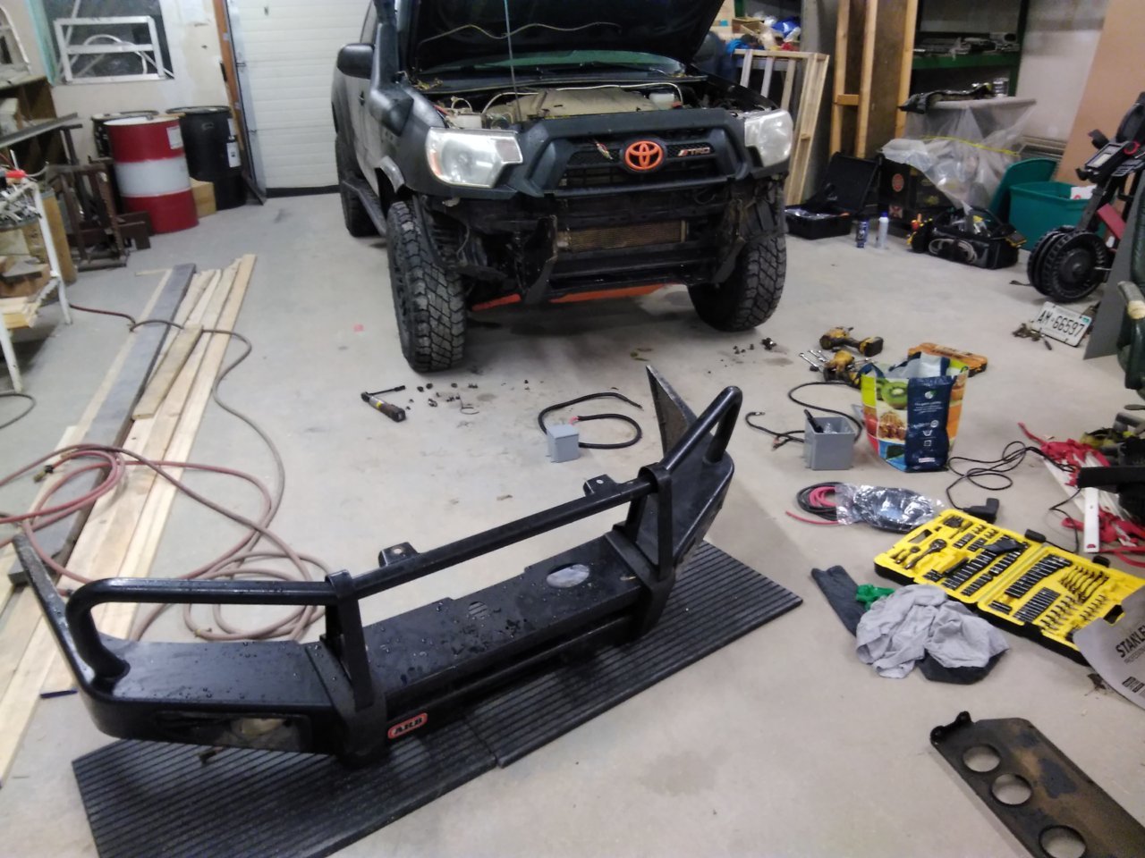

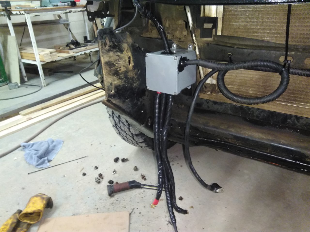

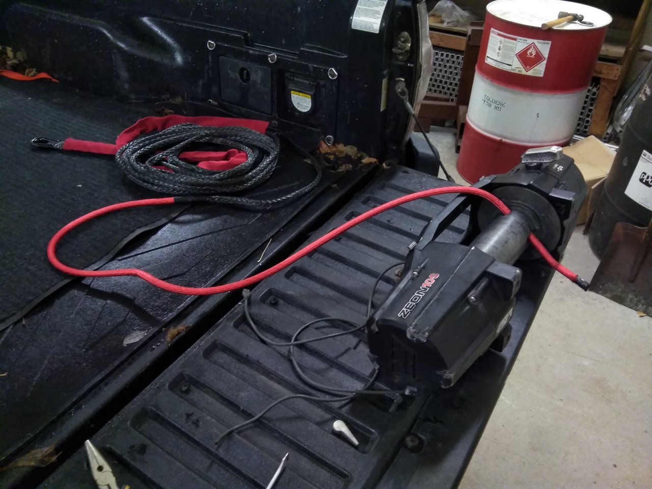

    Yea it was a bit of a job, started at 7:08 PM, finished at 2:45 AM. Sweet job we did though :cookiemonster:
    Solenoid mounted in a 'sealed' box. Not very sealed when you drill like 5 or 6 holes though it. But I smothered it in RTV silicon sealant, so :notsure:
    I now have a winch. I can join the cool kids club.

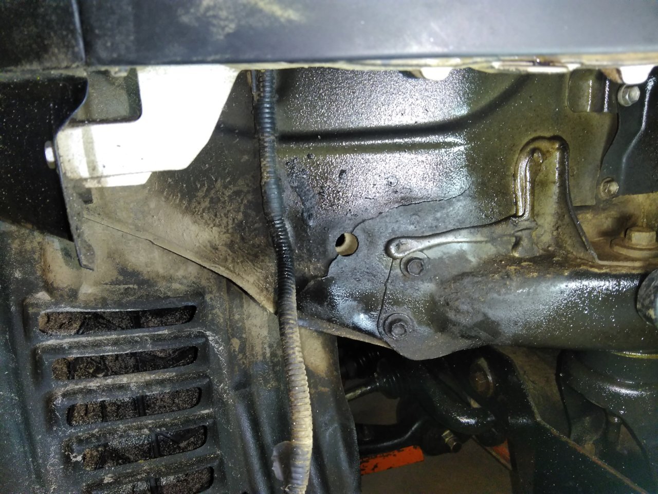

    Found some cracks on the front of my truck.....:facepalm:It is exactly the same on both sides. We drilled a hole at the top of each crack to try and stop them from spreading more.

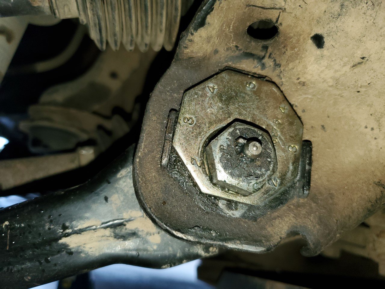

    the slop...but it still worked for me anyways.

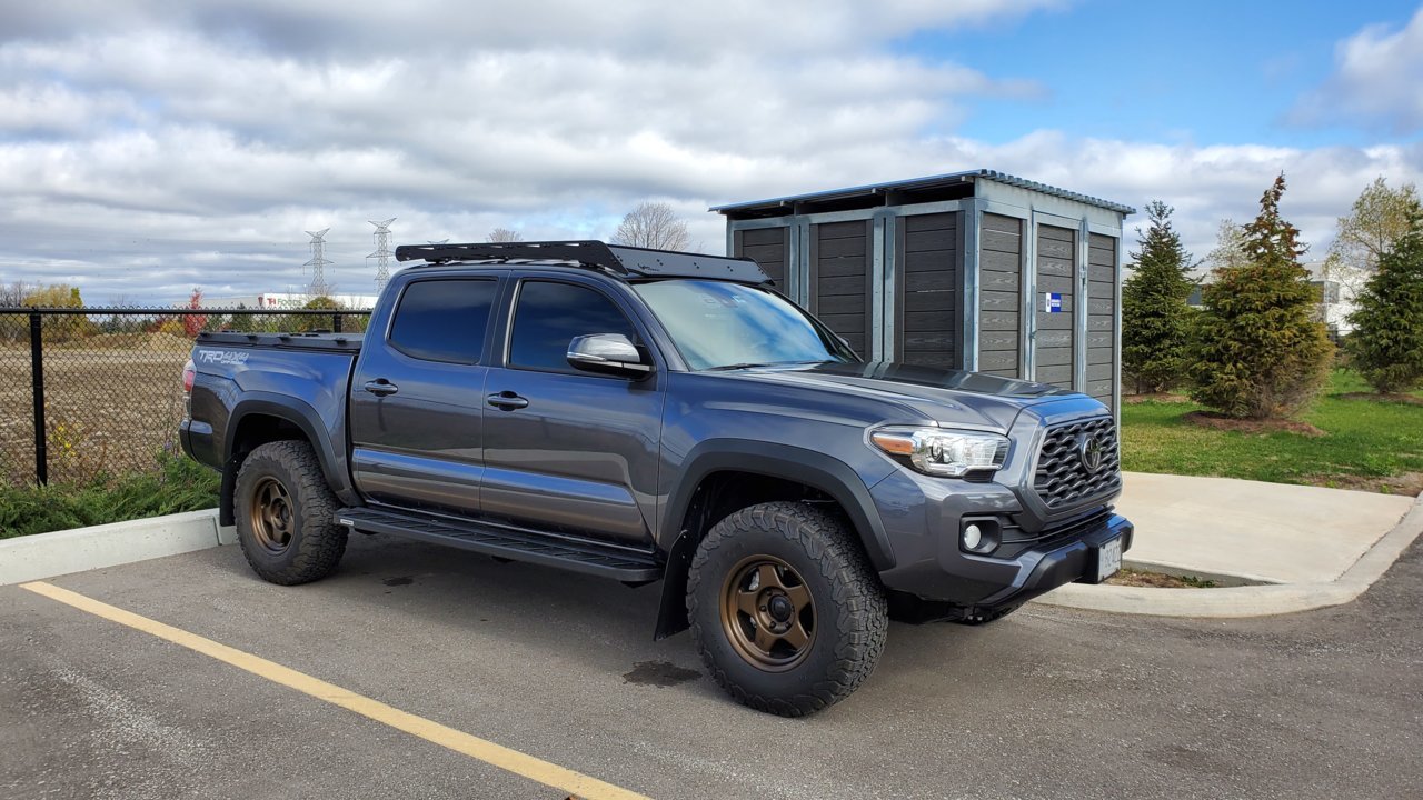

    My new money pit: 2020 TRD Off-Road in MGM. :spending:
    - Ceramic coated
    - Hood, roof, and tailgate wrapped in satin black
    - TRD Pro taillights
    - SCS F5s with 265/75/R16 KO2s
    - RokBlokz mudflaps
    - Go Rhino RB10 running boards
    - Diamondback HD tonneau cover
    - Prinsu rack
    Hoping to get TRD Pro headlights and a grille installed next week.

    Ya u got some gap on the right
    ill make my own i guess and these will have to do for now
    I can see about doing a quick run of them if anyone else is interested
    ps: i completely forgot we had our own thread on this topic :tinfoilhat:

    The gap is there, but there is absolutely no way it’s going to shift based on picture. Idk if the gap is a problem there...:notsure:

    It can move the amount of the gap if the bolt were to shift. Same concept as not having cam tab gussets.
    Its also the one directly under your tierod so it would affect your toe as well if it did shift or it was un installed and re installed again

    Nice looking rig, though the running boards might not help against more than the door ding :p
    what ceramic coat did you go with and how do you like the DiamondBack?
    any more photos of the satin coverings? is it more like a vinyl wrap or is it more like a clear bra?
