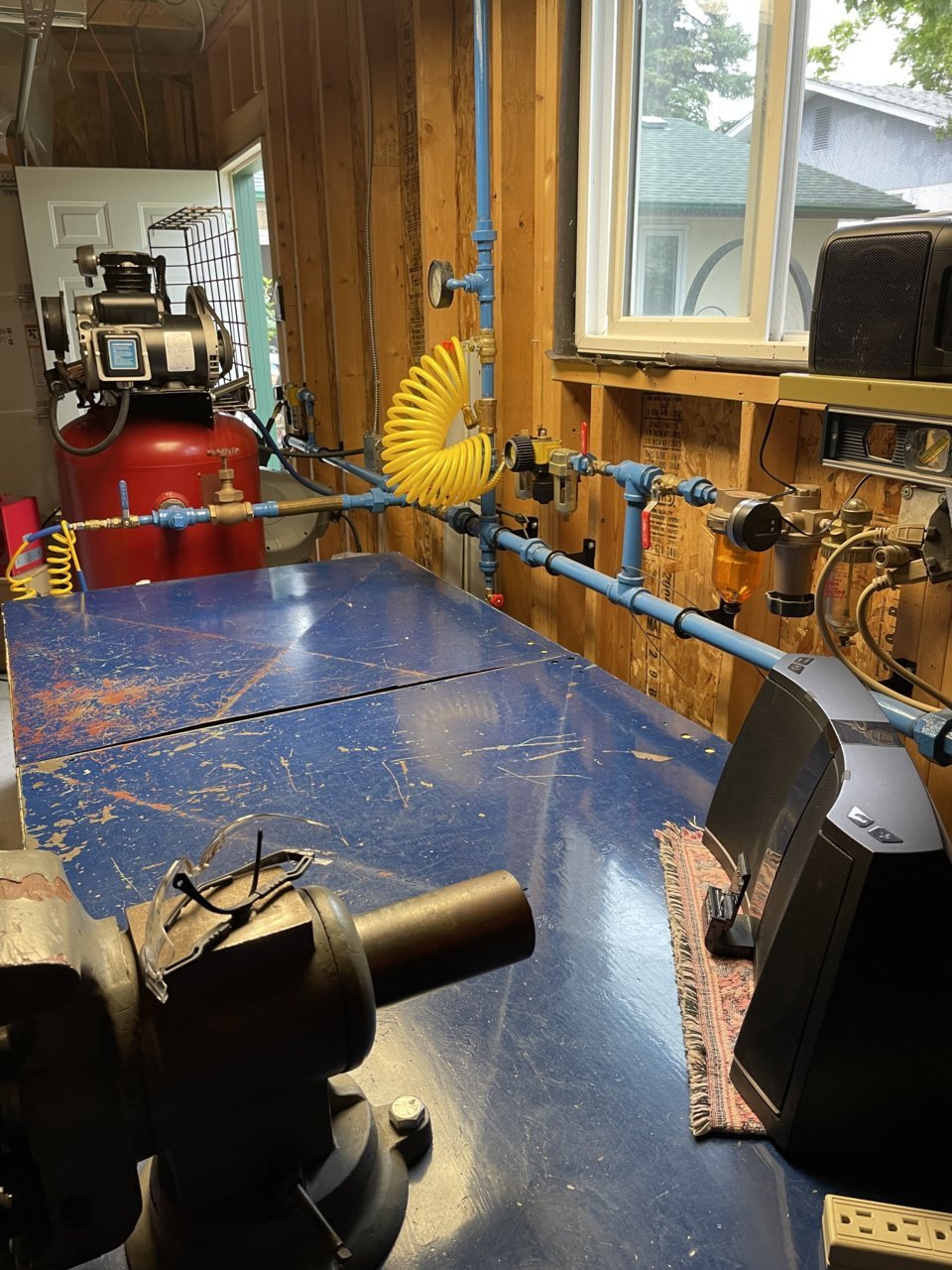

    I have a distribution block which is nice to avoid running multiple lines back to the tank/compressor.
    with regards to the air dryer you supposedly need multiple feet (10ft or more) of line to be able to cool the air down enough before it hits the separator. Why most shop setups have just multiple zig zags before it hits the air dryer
    I had an air dryer ready to go but it didn’t do anything. Lead to me doing constant drains and even using the air pressure to blow out the lines.
    regardless will be a very intricate setup. Highly recommended being able to isolate each system to check for leaks. I had a much smaller setup and it was a pain to keep track of. Made it much easier now and even still a rusted air chuck valve stuck open can be the worst….

    Went black pipe, separators & desiccant driers myself. Pic’s later, can’t even turn around in there right now. Hand threaded the whole shootin’ match. Was it a PIA: Yes. Does it leak: Hell No Would I do it again?: No damn way without a power threader. :)

    Wowzers. Black pipe! What’s the weight on that? Definitely stout. Hell people use their tube bumpers and sliders as tanks too. Pretty neat.

    There. Now you got the jist of it. Piped the whole shop the same way.
