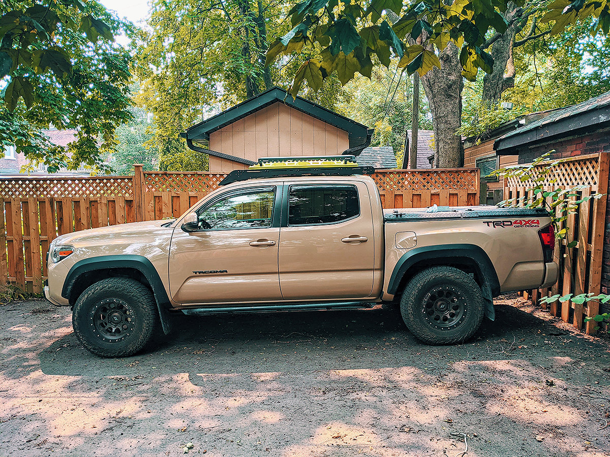

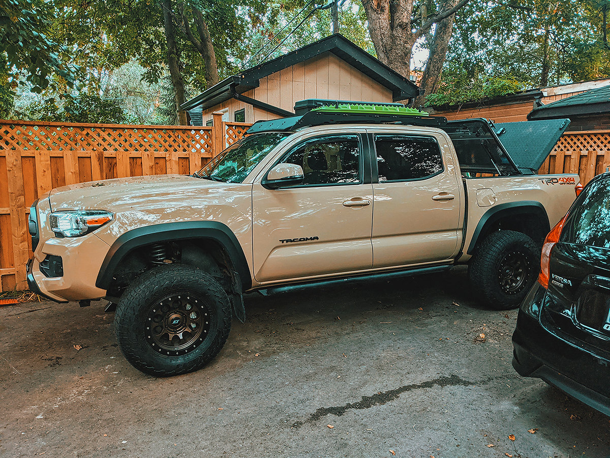

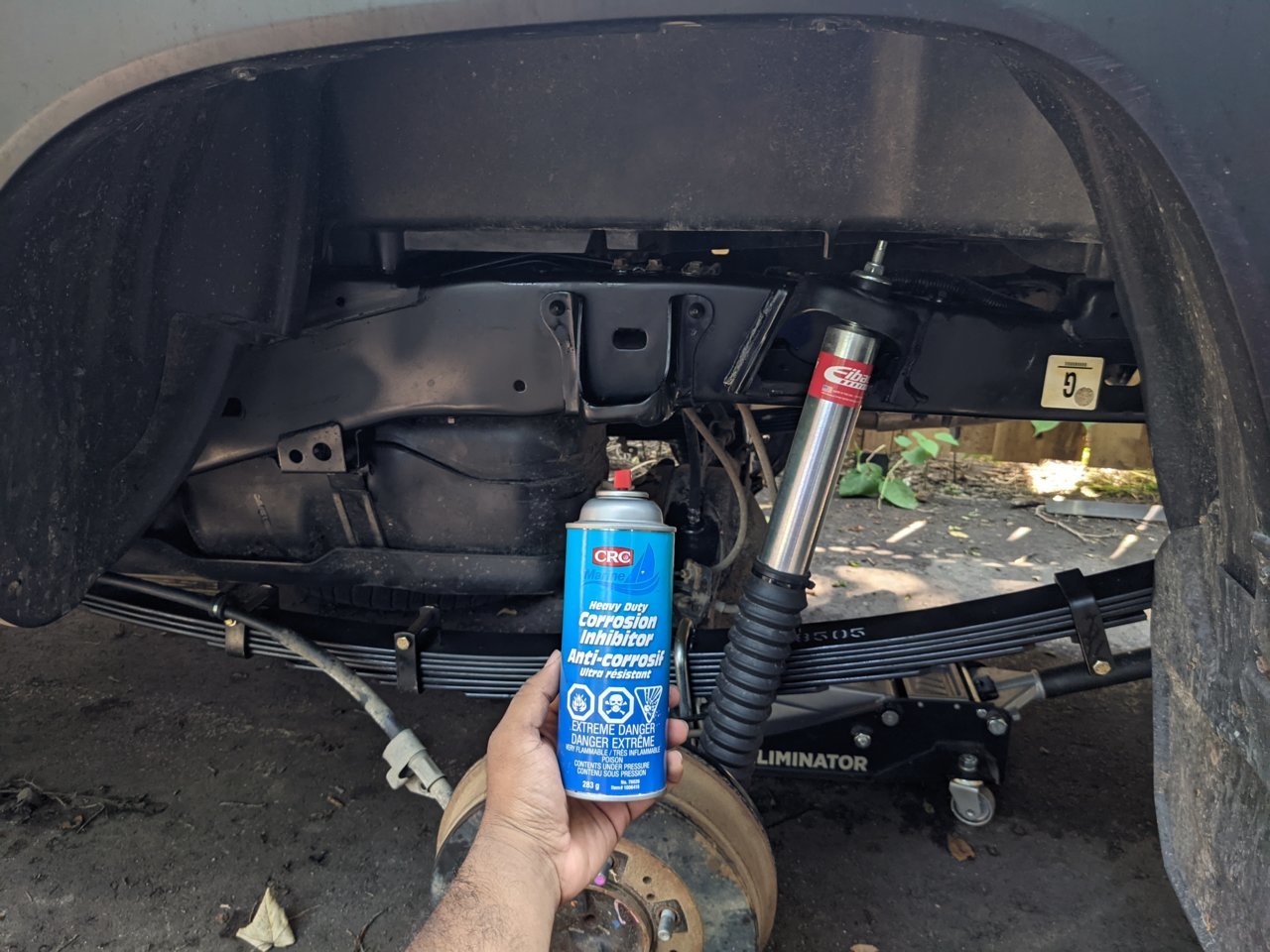

    Finally completed the front suspension. Those of you who saw me at the meet, it just had the rear finished.
    Didn't get a chance to test drive the complete build but will tomorrow. Might have some sway bar or ECGS issues but we'll see.
    Stock:
    Eibach stage 1, 2nd notch. Icon RXT leaf pack on option #2. I also installed a lean spacer which seems to have evened out the front.

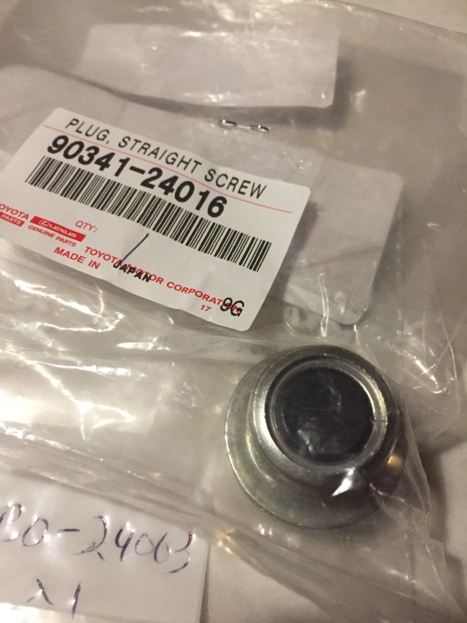

    I am not sure about oil type but make sure you get the right gaskets and crush washers For your drain and fill plugs. They are very cheap from a Toyota dealer and good insurance and readily available.

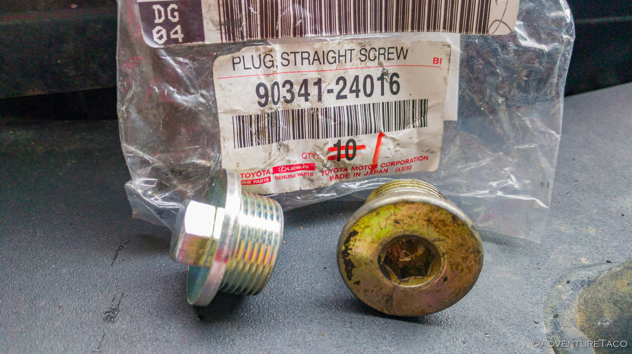

    get one of these for your front differential drain plug…aka as Lexus plug

    The external hex plug quoted by @ontarioyota isn't sold by Toyota dealers. Call up Lexus dealers in your area and see if any has it in stock.

    The plug is sold at Toyota, I purchased 2 last year for myself and @Joe23 before and they were in stock at the dealer in Milton at that time

    Something may have changed in Toyota's parts distribution system. The two Toyota dealers I called in Toronto three weeks ago couldn't order it and couldn't even get visibility on regional or national stock level. Luckily a Lexus dealer in Markham had it in stock.
