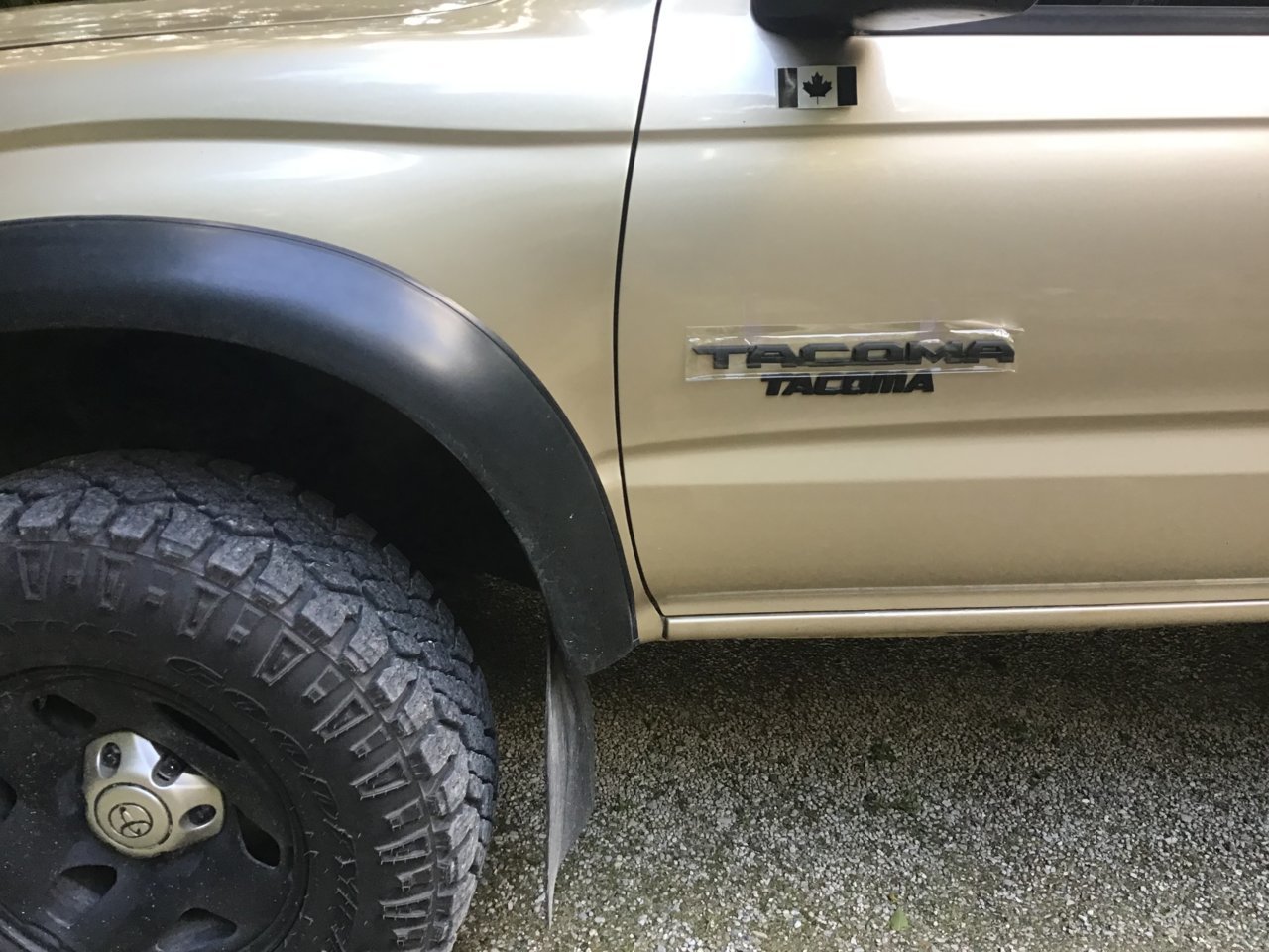

    We're you able to find any remnants of ownership of the discarded shingles?

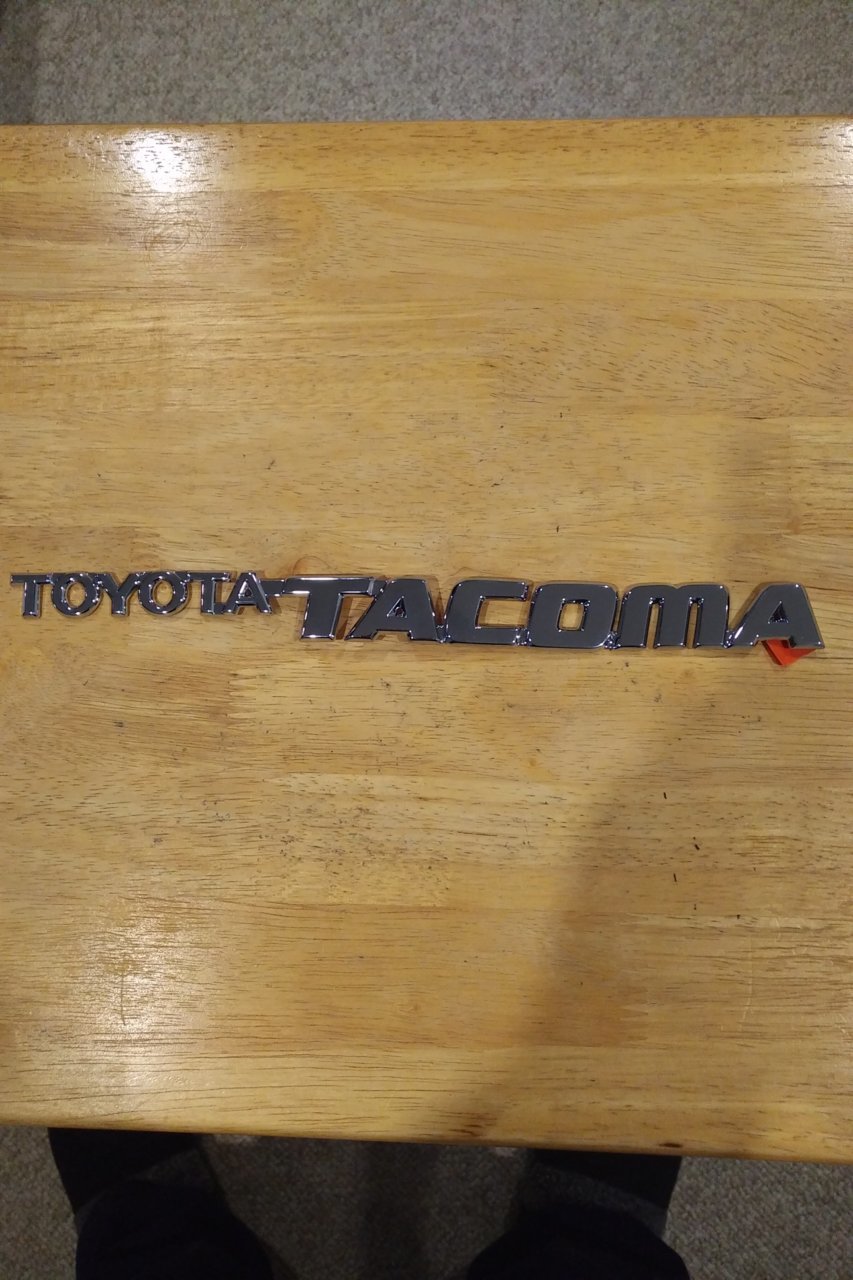

    Is there not a chrome Tacoma badge on the tailgate like this?

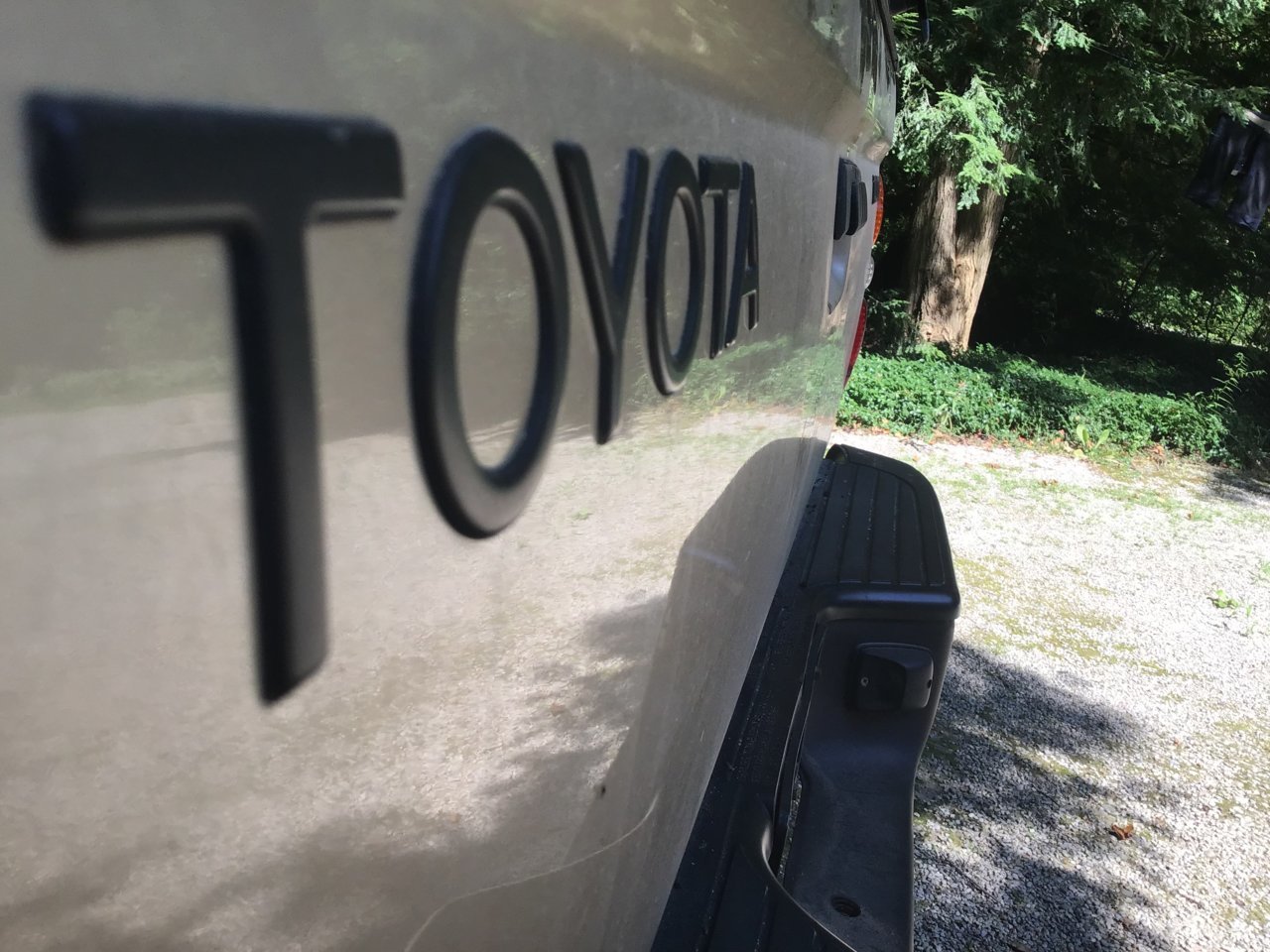

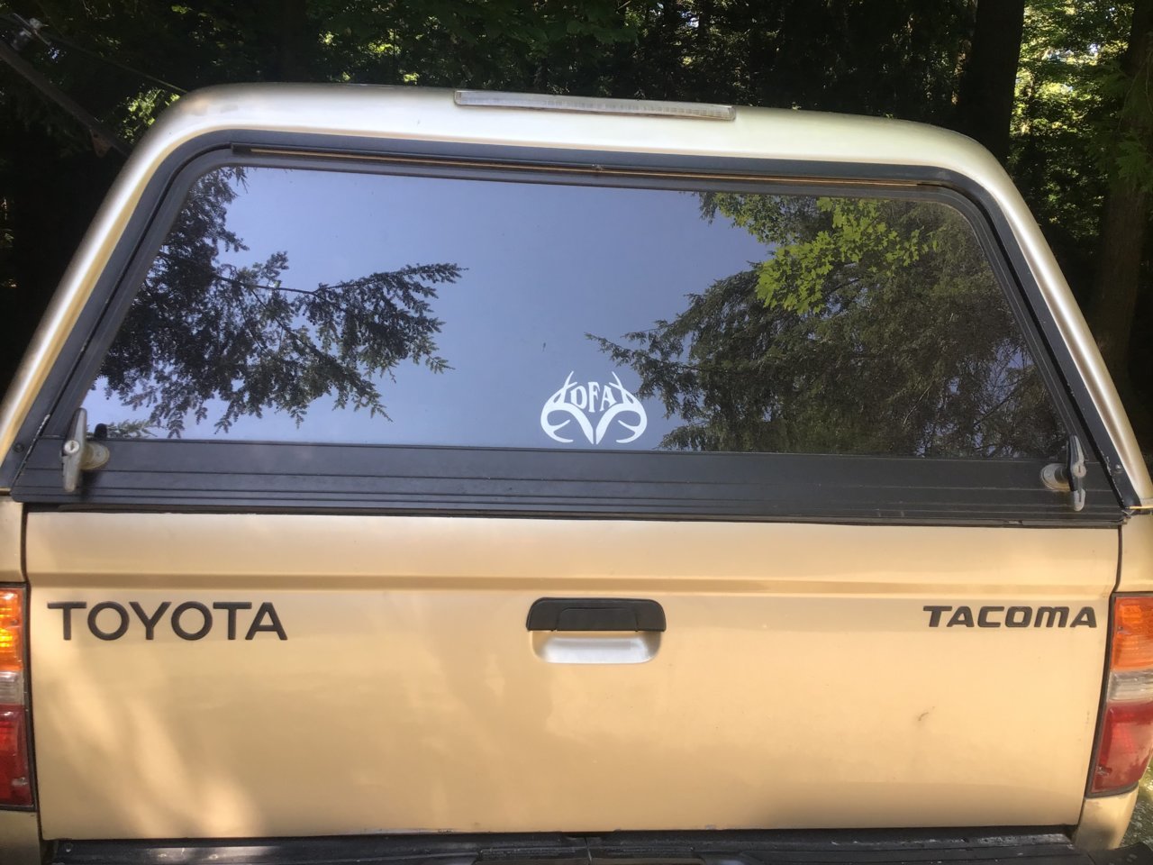

    That’s how my truck Came however I cut the Toyota part off and blacked it out. This badge was on the upper door panel stock.
    The tailgate had soft cushiony raised emblems that I blacked out 10 years ago and they have held up well. It was a tedious process painting them because they cannot be removed like the hard emblems. It is interesting to note on the 2001 to 2004 TACOS the raised tailgate emblems were only available on US models….. Canadian models had decals on the tailgate!!
    I like mine because it’s kind of old school on the tailgate.
