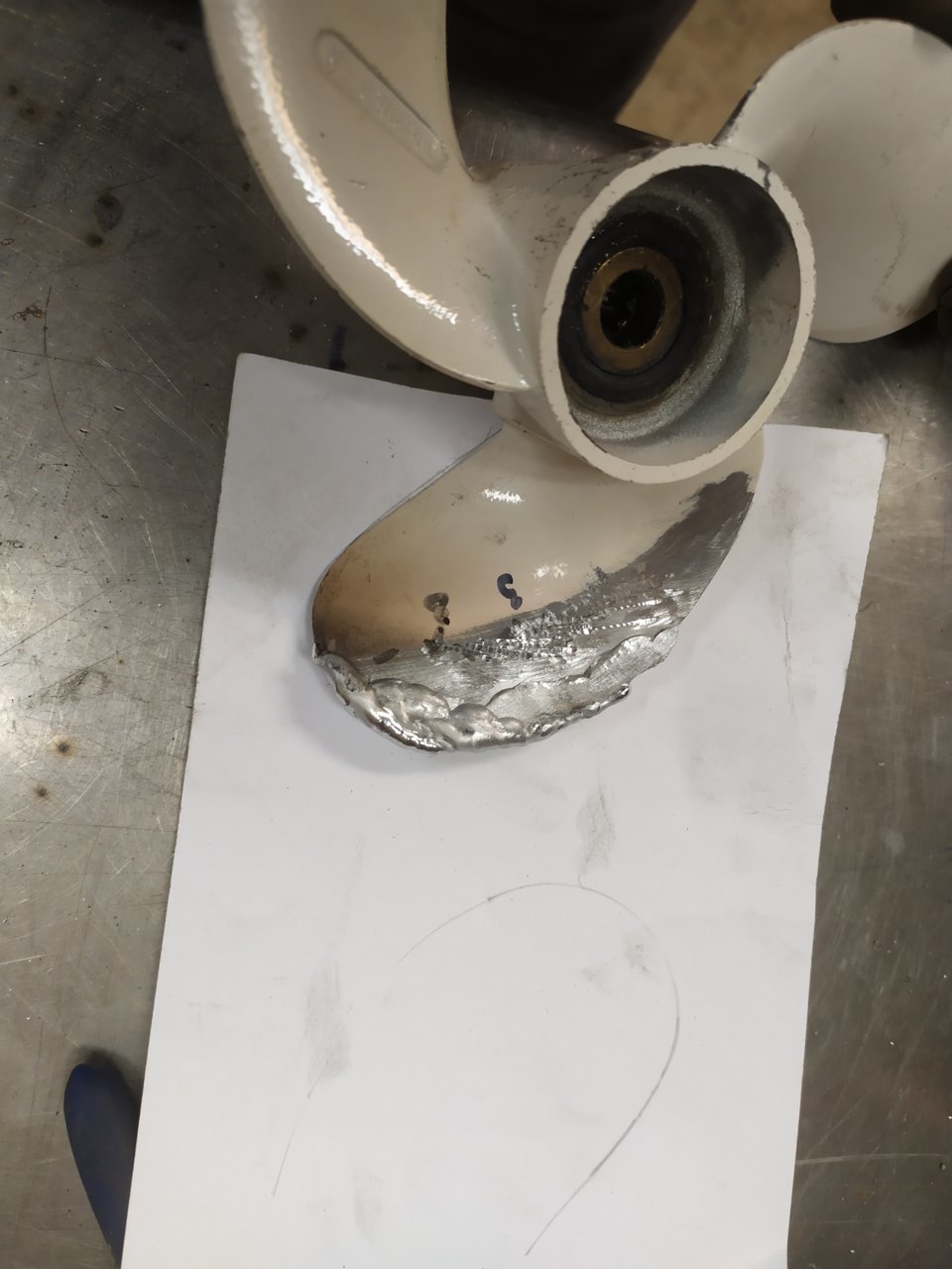

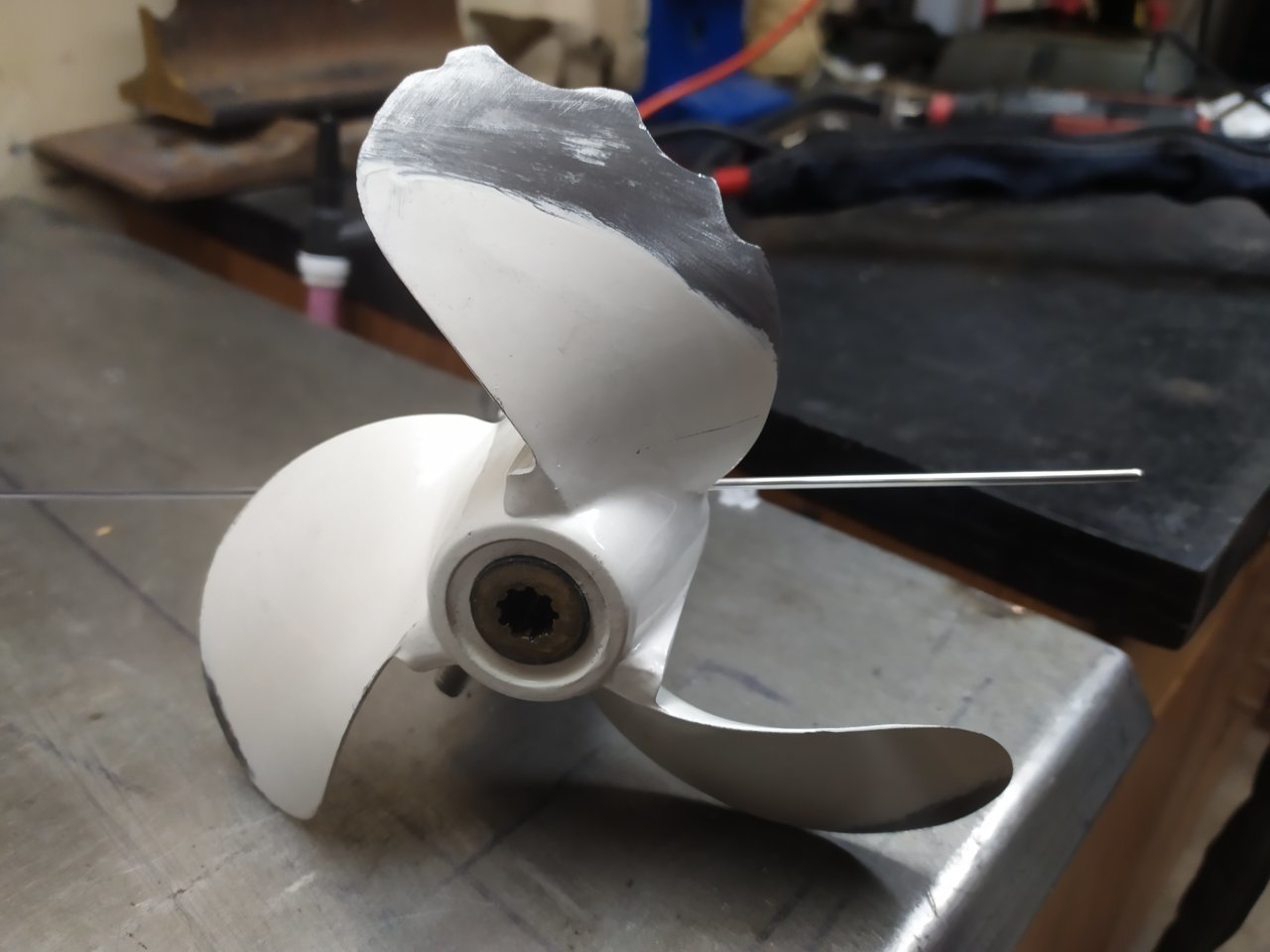

    Things got a bit nautical in the garage today. It's like empty milk cartons in the fridge realizing I have no servicable burrs left to shape and blend things back up. At least it doesn't have to be done till the spring.

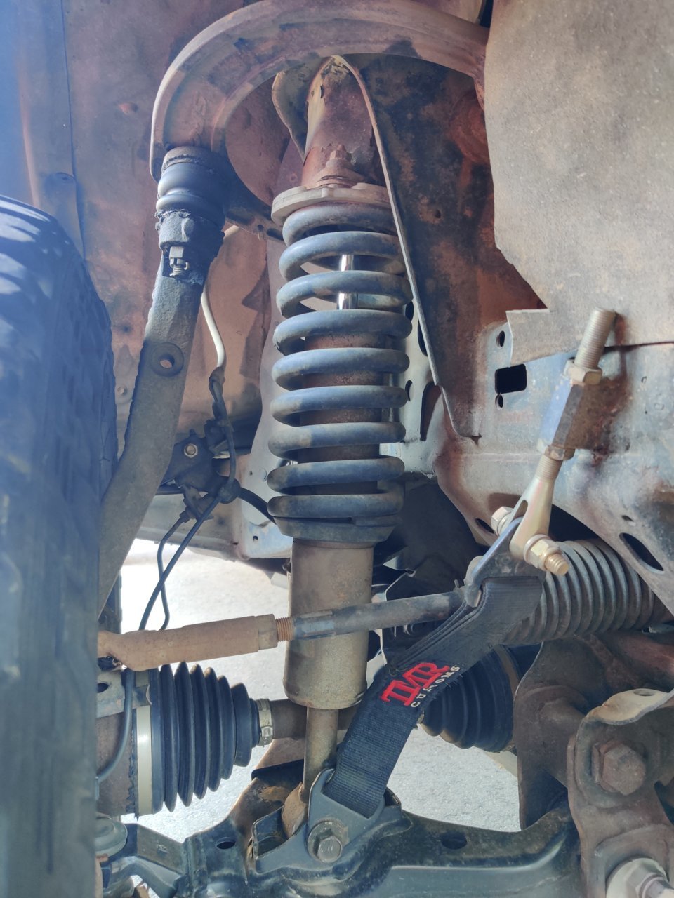

    Thanks for the pic! I don't see any rust at all.

    I spray the front end with fluid film a lot.

    Seems like a lot of work to weld, sand, and repaint. How much is a replacement propeller for your boat?

    we really need to talk about that drop bracket and spacer lift... :evil:

    Talked to Naz and he didn't want to touch it. I'm going to see CT and see what he says but this point it is what it is and I'm not spending money on the mistake. I'll just wait for the next build.

    whats the spacer height? a shop with a good spring compressor might be able to just pull them, disassemble, move the spring perch to the top ring and put em back in easy (after removing the spacer).

    That's the easy part. Two cross members were also cut out and replaced with bolt on ones that sit lower for the diff. I lose about 2 inches of ground clearance. I want to remove the added cross bars and have something welded in it's place and eventually lift the diff back up so I can get that clearance back. It's a custom job which I'm not keen on spending the money on.

    Probably is. It's from a 6hp Yamaha on my brothers dingy. A new prop is only 60 for a non Yamaha one in Amazon. It probably is more work than it's worth. Doing it more out of the learning process since TIG is a new thing for me this year and there's nothing lost if I did mess it up. About 2/3 the way through things got much better. The prop is cast so it's pretty gnarly to get the first layer on without excessive porosity.

    I dont think it was a mistake.
    There is absolutely nothing wrong with that lift.
    I've been out on the trails with you. Nothing wrong with that.
    If something is working leave well enough alone
    :thumbsup::thumbsup:
    Tridet167[QUOTED] and zuknewbie like this.
  13. Nov 7, 2021 at 5:51 PM
    Tridet167
    Tridet167 Not an Overlander, or am I?
    Nov 16, 2014
    #142434
    2,819
    Tony
    Toronto, Canada
    2014 Tacoma SR5 DblCab
    I totally agree. It has served me well and will go a long way in having 35's fit easier. I just wouldn't do it again next time.

    That'll be a 4" lift. You may run into CV axle binding issues unless you do the JD 934 conversion, which is super expensive due to the 300M axle shafts.
    Going with skinny Kendas or Mickey Thompsons, or wider 315 tires?

    I'm doing skinnies like yours. Kenda is the way to go.
