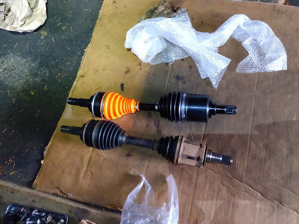

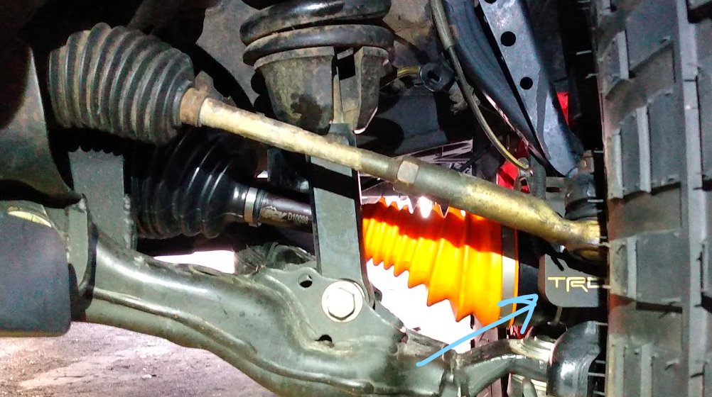

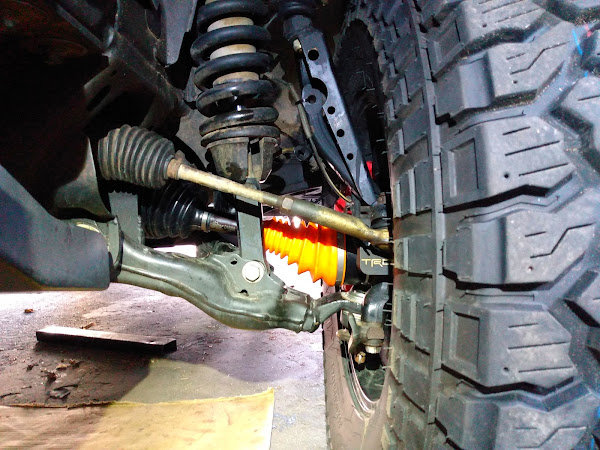

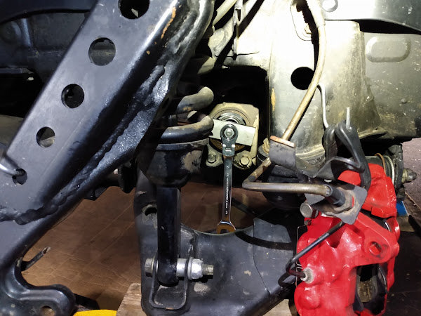

    I've been installing parts while in TW jail. :D
    RCV axle shafts P/N CVJIFS-TOY2 came in 5 months after ordering. RCV axles don't include the outer dust seals and axle nuts that normally come with aftermarket CV axles. Outer dust seals are Toyota P/N 90304-A0001. Re-use your axle nuts or get Toyota P/N 90178-28002.
    OQvOFs9rlx24u38mvfTmU3WXCaGnnWDIkwh4K1-9_9f84056a9b148c410437900d7b61d0c819c76301.jpg m40zxRyTY-b7T5CRw9J5gvrw5k1mbTTW7lrnxSyl_15569eb145e0c6590e6f26b3c2e3862ce6757371.jpg

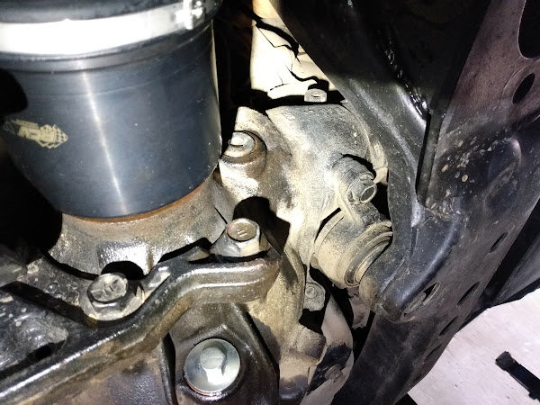

    While the LH axle is out, replaced the front diff needle bearing with ECGS bushing P/N T8CS-BUSHING and a new seal Toyota P/N 90311-47027:
    0JC_5ZGnsrF-tgJljk4XeHvYdo_04NAuz-l1dXuk_ba6b870212cb54983cd69f40197e7c82beaf760e.jpg

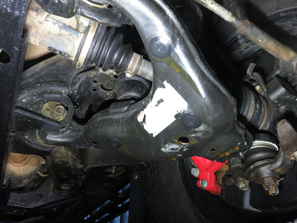

    Everything installed. The high-angle CV boots avoid the need for the boot slide mod:
    FQ7mn_-atVczjTxqkNJ82UNr-7GkZkSUzwtpP9bs_90527eb619c3183c03c63d3e5e59afe8f3012c54.jpg ptOrfv1tCIUdgNEDqsmJ4FASTlnr_8Ot1LSd5E9B_91b942ce9a362992e3bf9227bbf075d065651eaf.jpg

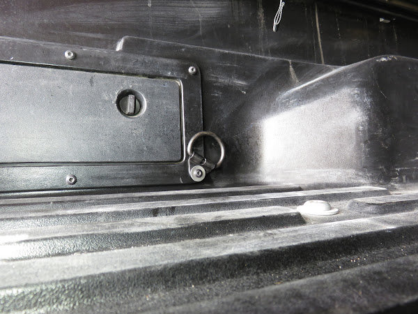

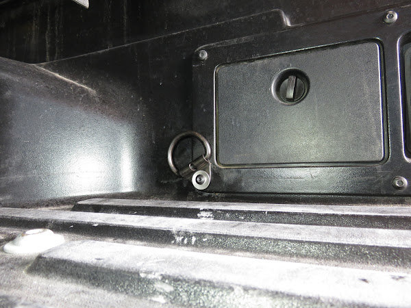

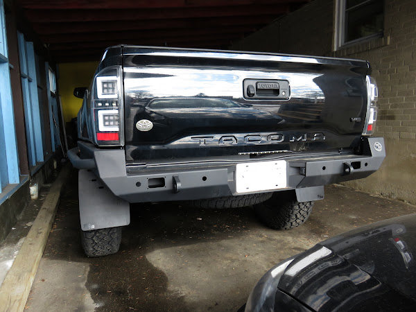

    Installed a couple of the Dodge Sprinter D-rings P/N 5170492AA on the bed cubby bolts:
    Put my new emblem on the tailgate with 3M 03614C molding tape:
    My replacement LCAs didn't come with the anti-whistle hole plugs, so I had to order them separately, P/N 90950-01990. These have the number "8" molded on the head, same as two plugs in the frame rust spray kit. Each LCA takes 3 plugs, for 6 total. Decided to go OEM despite their cost, because the plugs are in a harsh environment, getting dragged over rocks.

    at least you got busy, What's this little guy? the sensor protector?

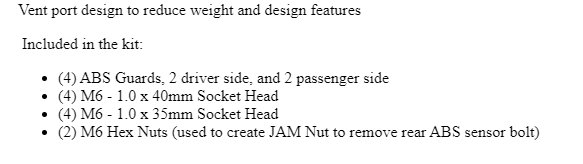

    ah neat so the Fleabay ones are more akin to the Greenlane ABS sensors then?
    From the price of things
    The Green lane one (set of 4) aint all too bad overall. a hair more expensive than buying 2 sets of the Fleabay ones) but supports local.
    but the jomax ones, for a set of 4, would be just shy of $300 CAD.
    Edit:
    Nope, took a look and the FleaBay ones come in a set of 4 for the $100.
